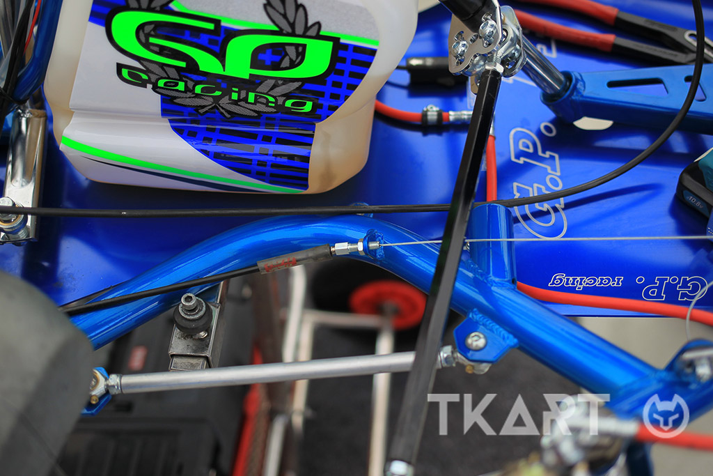

Makes me wonder how the GP chassis “traction bar” effects handing relative to the de rigueur f/r bars.
I haven’t noticed any other makes adopting it.
TJ is correct. It’s always been my experience that when you place a stiffer front bar in it will also make the front end bite more. Depending on what your kart is doing it can sometimes balance out your kart if your having a slight push. If you have access to a lathe you might try making your own for a lot less money than it cost to by one from a kart shop. You can purchase the material at Graingers. They also give specs on the Tensile Strength which will give a few choices on stiffness. I’ve made my own for some time now and can be a life saver. Below is a link to the material. It’s worth a try. It does make a difference.
