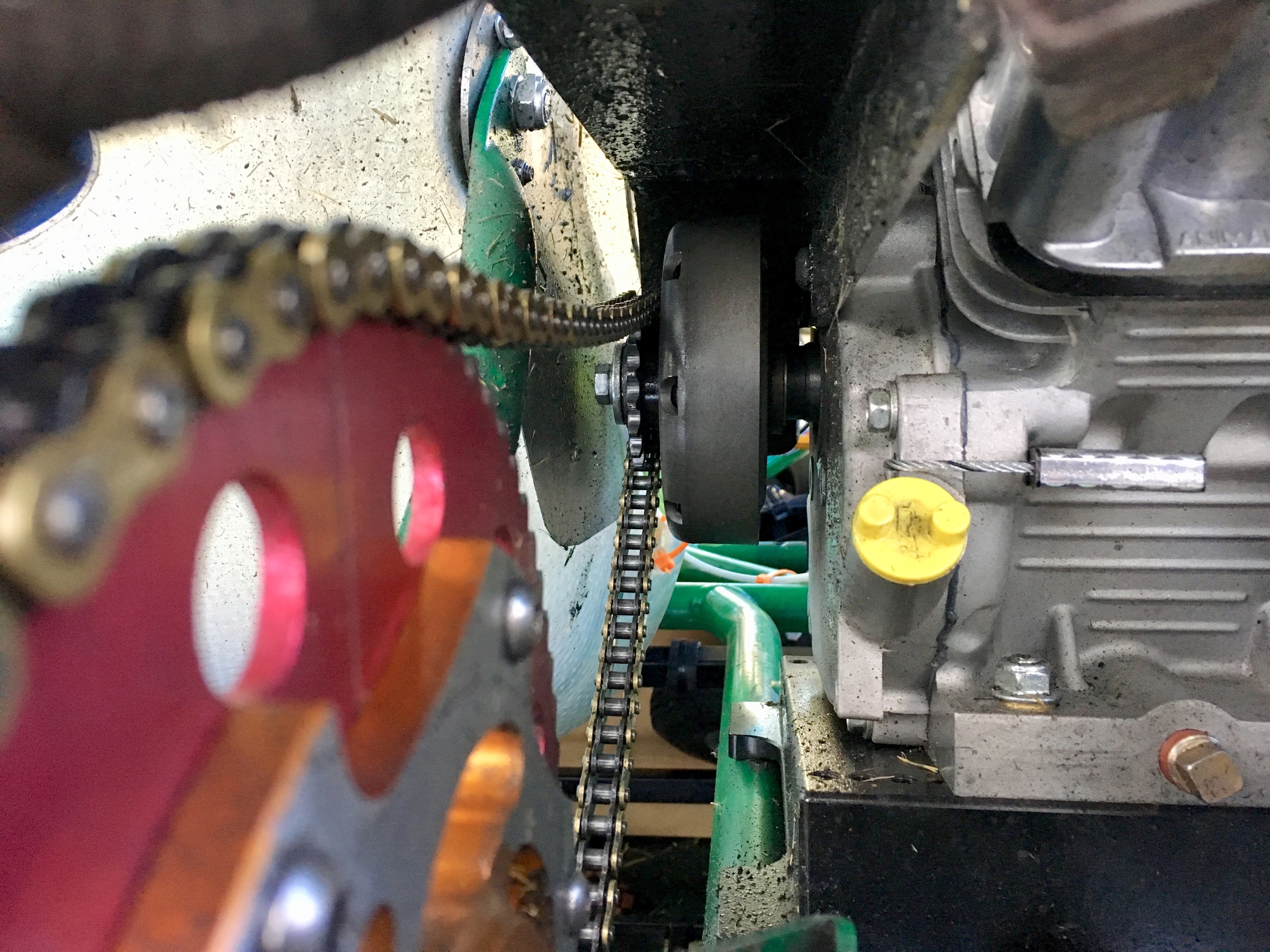

Changing gearing for the first time on a used LO206 (old OTK chassis). Should the chain brush up against the frame? Ideas on how to adjust? I can add some more details if needed.

We run a 206 on a 2014 OTK. Needed to run driver outboard near seat. There is also a bit of offset on our JTP mount. We’ve run 16-18T drivers and 57-67 rears without a problem for almost 2 years. One nick in the crossbar from when we threw a chain after dinging a sprocket on a curb.
The only machining we needed to do was to lathe extra material from our gear carrier for cleance from the third bearing bracket.IMG_5192
Even your chain pics look good :joy:
