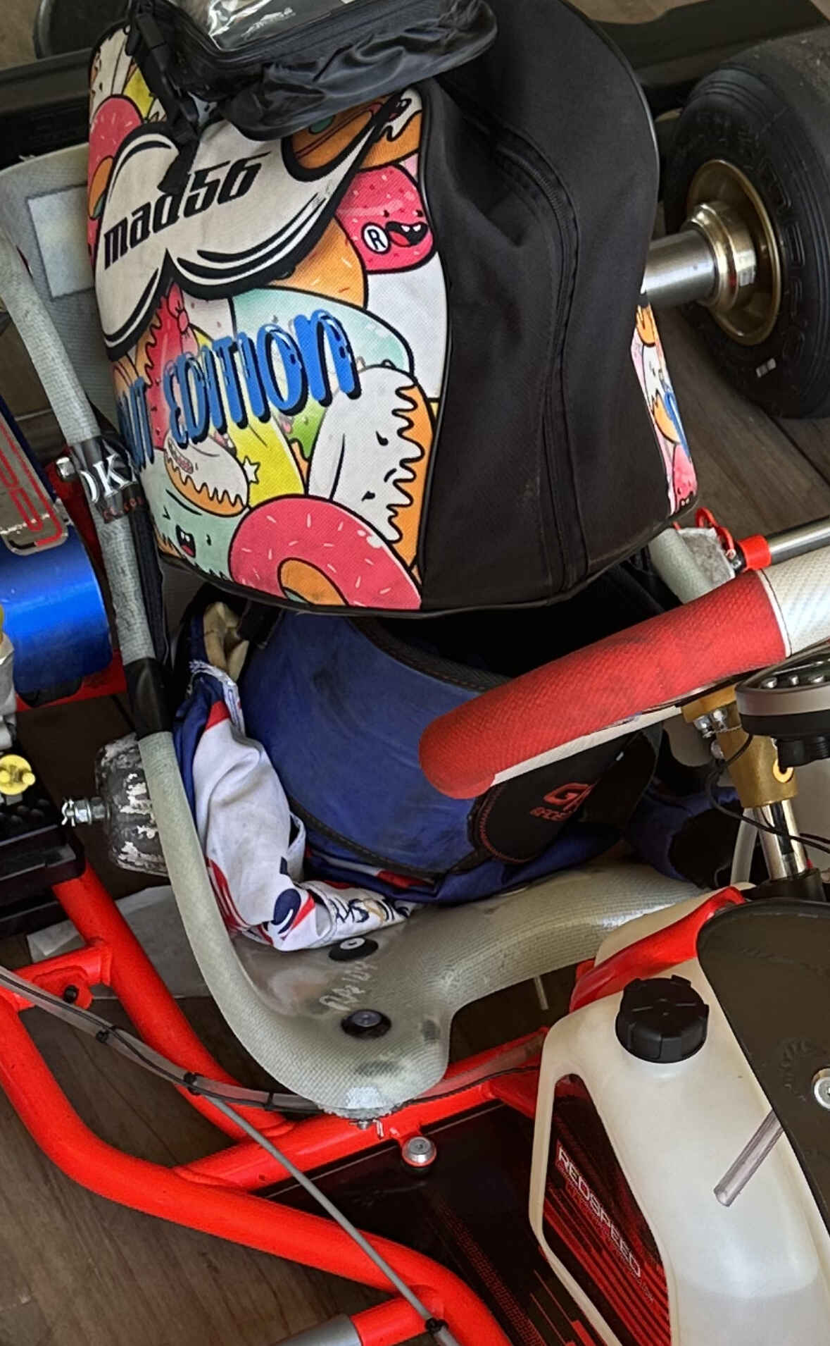

I changed seats from a standard OTK style seat to a NEK Modular seat. The new seat supports my 6’2" frame a lot better. However, changing seats was not enough. Whenever we ran our local track clockwise, that same front left rib area would get injured just from the cornering forces (no crashes). I was feeling super defeated because I figured I had the “best” rib protector on the market and a new high end seat but I was still in a ton of pain.

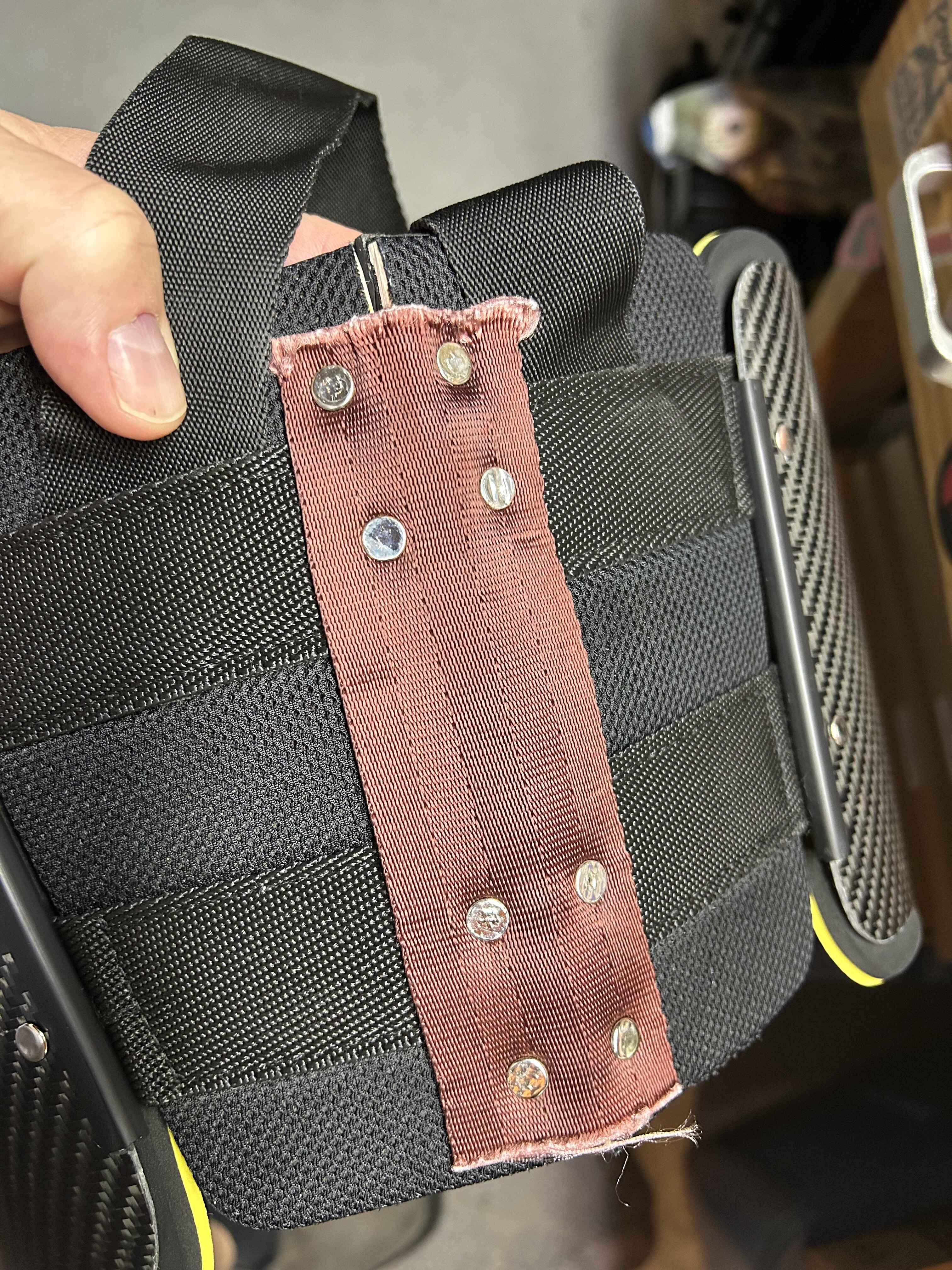

This weekend In the pits, I was explaining to my wife where I was hurting and showing her with my bengio on and it all clicked. The Bengio rib protector is very stiff and has a very pronounced curvature to the side panels. Because of the curvature of the left side panel and the shape of my rib cage, the front edge of the side panel curves a bit inward (e.g., starts curving in towards my ribs). When pressing on the side of the rib protector to demonstrate the cornering forces to my wife, I realized that when the side panel is pressed in, the front edge is pressed in right on top of the ribs I kept injuring in the front!

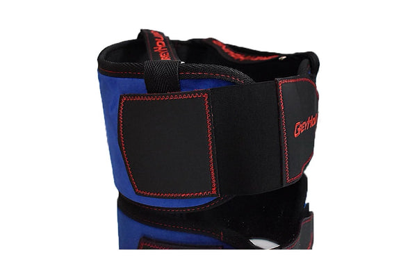

So, at the track on Sunday, I tried on a Greyhound rib protector that a local shop had with them. Its design is very similar to the Tillett P1 rib protector. Unlike the Bengio, the rear panel of the Greyhound is a big velcro panel which allows you to independently reposition the angle of the side panels. This allowed me to angle them a bit outward so the top of the rib protector was wider than the bottom (v shape). Additionally, the curvature of the side panels is less pronounced while the panels themselves are also a bit longer than the Bengio (both are size Large and the “correct” size for my measurements). All this meant that when pushing on the sides of the Greyhound, the front edges do not dig downward into the front of my ribs!
I was sold (and desperate) and bought it on the spot. I threw it on and went out for my next session. FINALLY!!! I was 100% comfortable and could actually lean into the seat when cornering without pain. I was still a bit sore from the prior day’s practice wearing the Bengio but was able to drive six sessions yesterday and finish the weekend without increasing the pain. Woke up this morning and am in no pain beyond a bit of dull soreness! I’ve never tried a Tillett P1 but the Greyhound is a very similar design and $130 cheaper.
