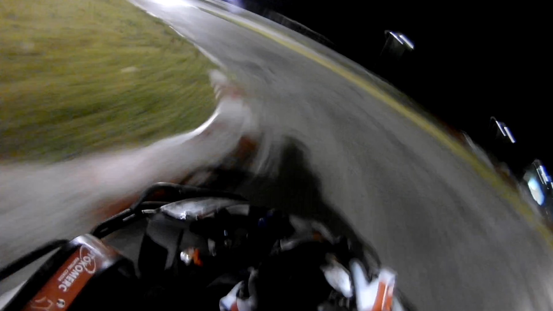

This is the first session with weight. Random lap.

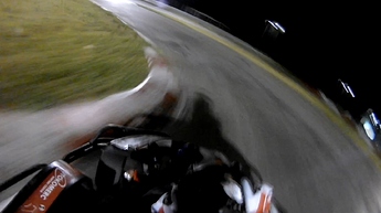

This is from yesterday. Fastest lap.

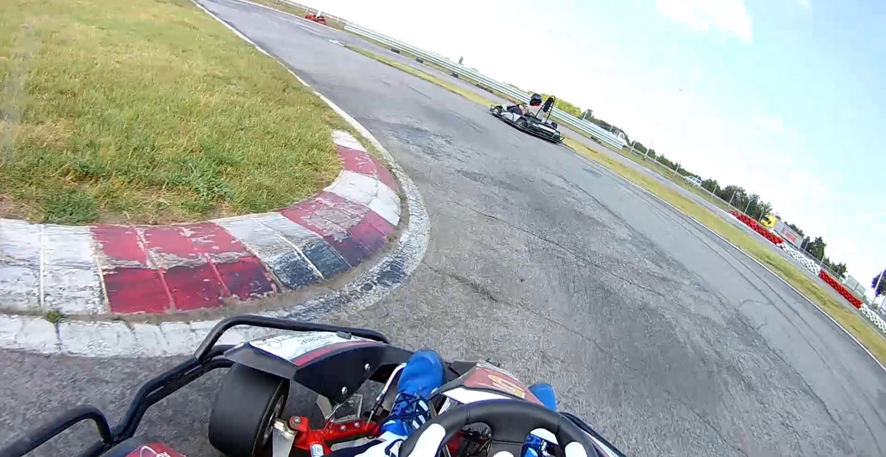

There is clear difference in how close I am to the apex, and on fastest lap, I partially hit it, but don´t feel that in the kart. What you can see here are tyre marks on the apex:
Yellow part is what I see as place where people usually hit the apex, but the red one is the perfect one, much more rubber there, even on the line. So what I think I should do is to hit the apex with ~1/2 of the tyre and with other half to be on the line and that bump. Not entirely possible, tyre is not a liquid so it can have full contact with the ground on angle, but relatively speaking, looking from above. And the turn in point should be just a bit earlier. Also, if I get that close with the front left, the rear left will clip it as well and force quicker rotation by simply pushing the rear of the kart to the right. That is how I see it. What do you think?
Exactly, he said what I am doing is correct but it works for much stronger karts. In other words, I am not using 100% of the grip tyres offer me, but some 60/70%. I should cut that swing to the point where kart understeers, something like that.

So, slightly later apex, clip kerb, Kerb pushes back end right. Its worth a try to see how it goes.
For this to be beneficial, wouldn’t your trajectory into 10 have to be different and faster? The idea is that the kerbing will change your orientation to be correct for the next turn?

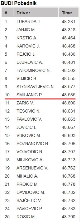

Quick update. I was at the track today, I was there for 4hrs and I got 2 sessions. Considering that the cut is tonight, I definitely made it. With a slight change. I set a personal best of 48.585s and made it through nicely in 10th place (maybe one or two down, since 1.5hrs left for someone to improve). Weird sessions but okay, some serious contact on few occasions but still enough for double improvement, in both sessions in comparing to last fastest time (Session 1 - 48.585s and session 2 - 48.841s). I will get the video tomorrow and I need to seriously analyze it as I was not comfortable and these were very rushed ones. Lot of overdriving but still solid result at the end. Next up, semi-finals and finals 12th October :blush:
Aha! Congratulations! I knew you could do it. I look forwards to the video. So does this mean you are done for next few years? Or is that if you make top10?
Also, what’s the delta between you and the next guy above and below? What’s #1 at currently?
No no, we are divided into 5 groups of 5 people. Winners from each group go into finals, and all the finalists are banned for the next 3 years (winner forever). Not there yet haha.
Here is the table, easier to understand:
Don´t know if the table is shown fully, maybe you need to click it to see it completely, not sure why… By the way, with the time I have set a week ago, I would have been knocked out! Lot of good drivers!
