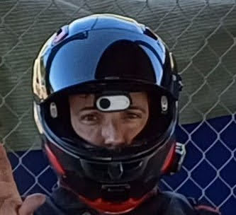

My teammate used an insta360 go at out last round of racing, since out sanctioning body allows helmet-attached fitted cameras.
20240519_082543-EDIT
Fitted behind the visor there is an occasional reflection, depending on the lighting angle, but he did not find it overly intrusive to his vision.
Here is a short clip of some of the footage from that angle.
That looks great and works out super well 9x16
