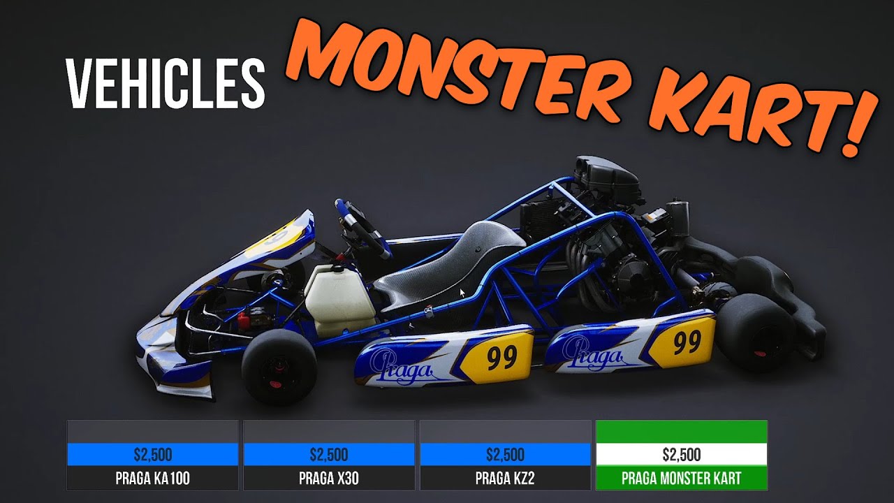

Oh to answer your question… x30 is about 30hp where ka is 20 I think. The fastest kart in game is the KZ shifter which is closer to 50hp I think. Actually the kartkross, come to think of it, is fastest. In a straight line, the monster kart, probably.
