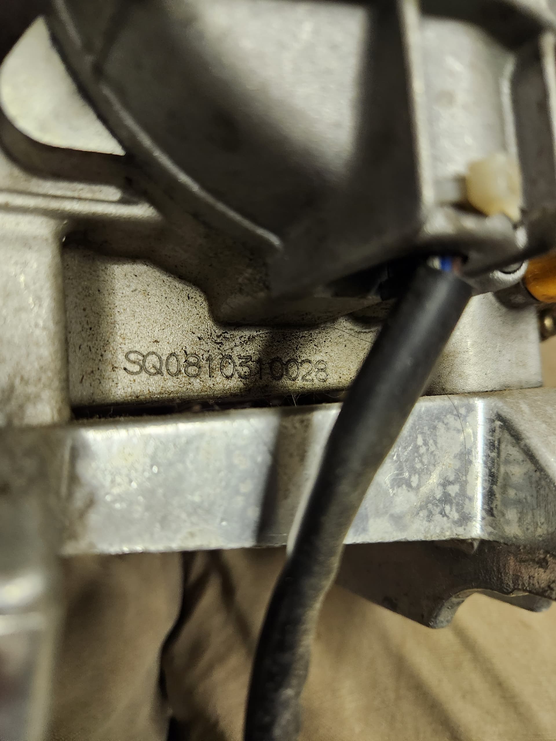

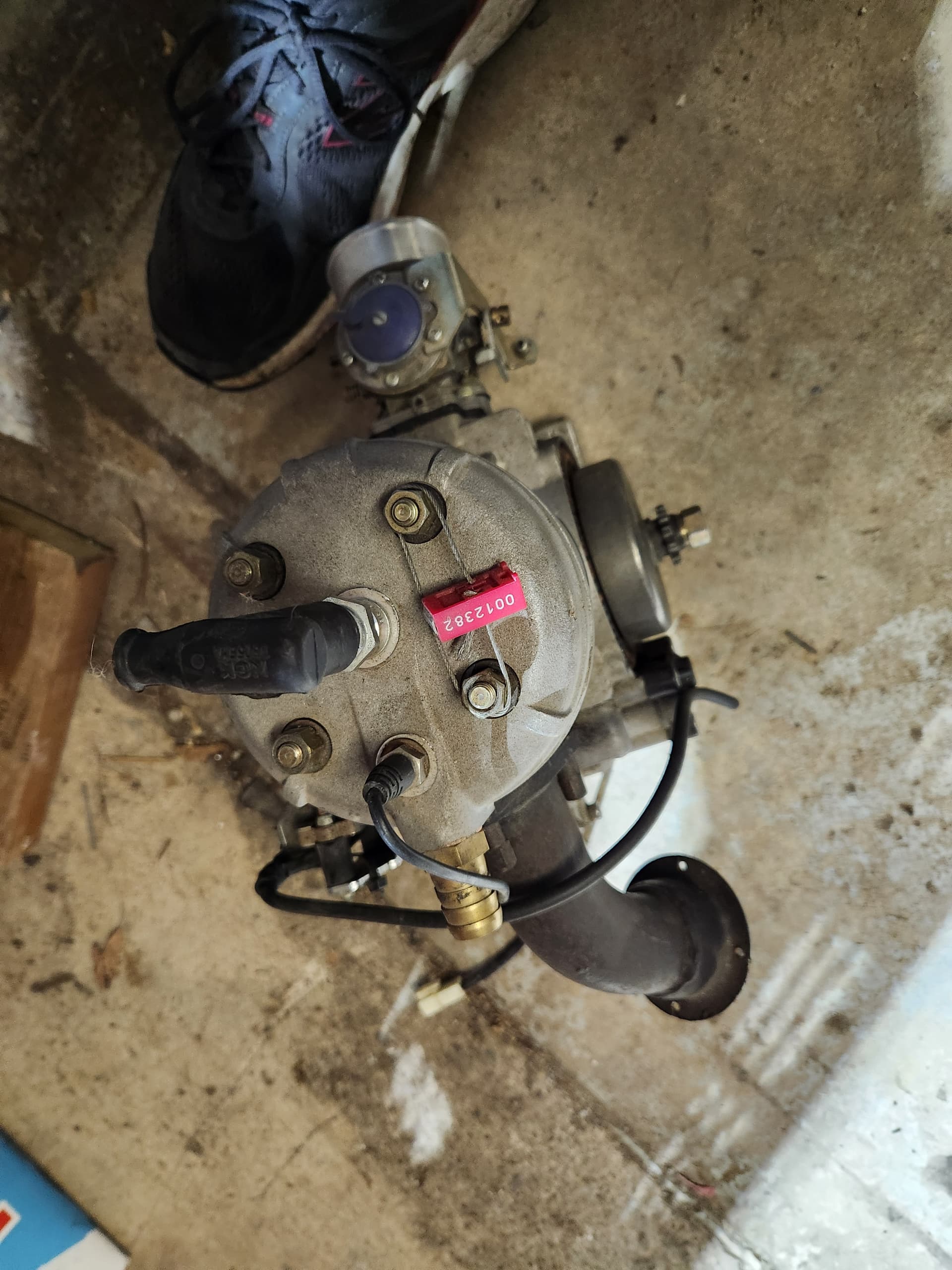

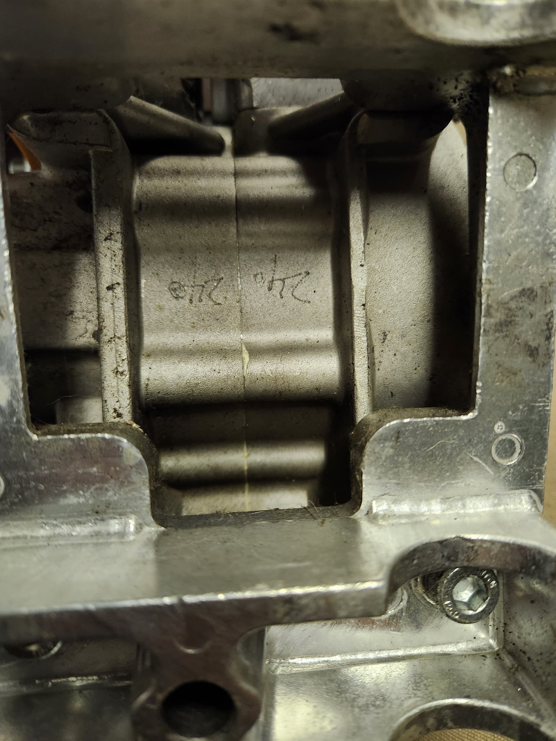

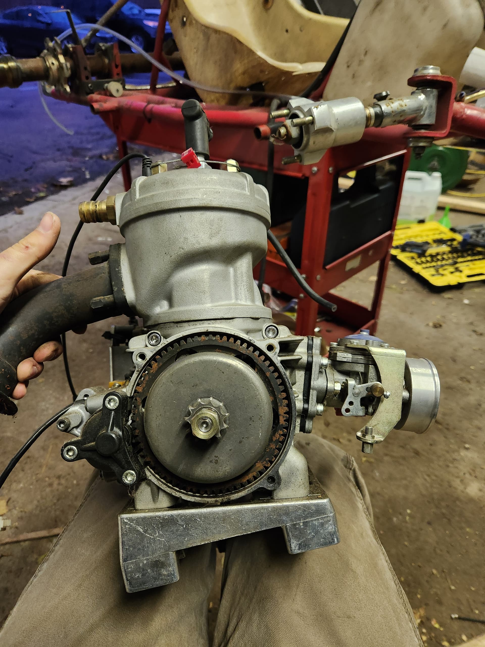

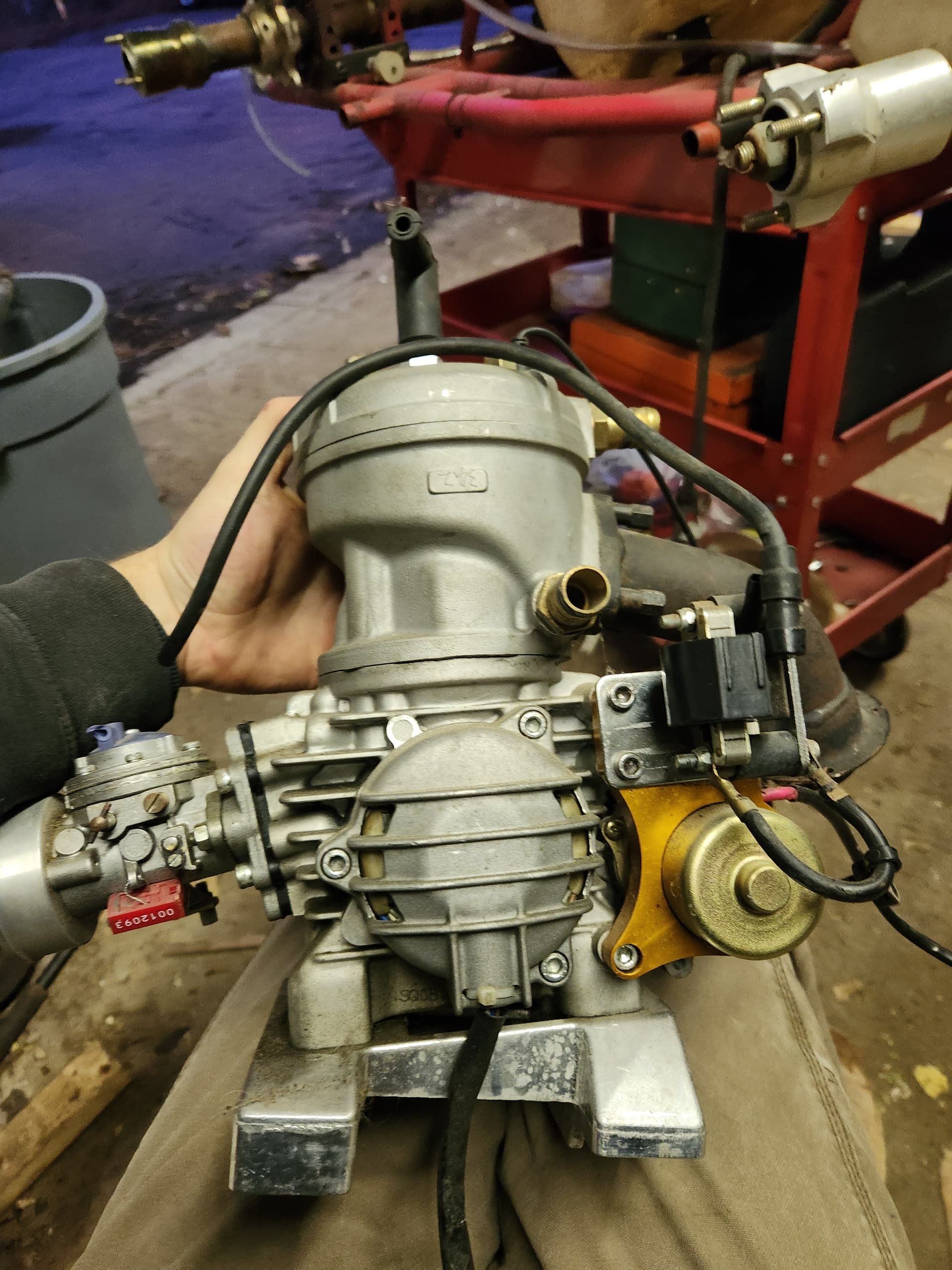

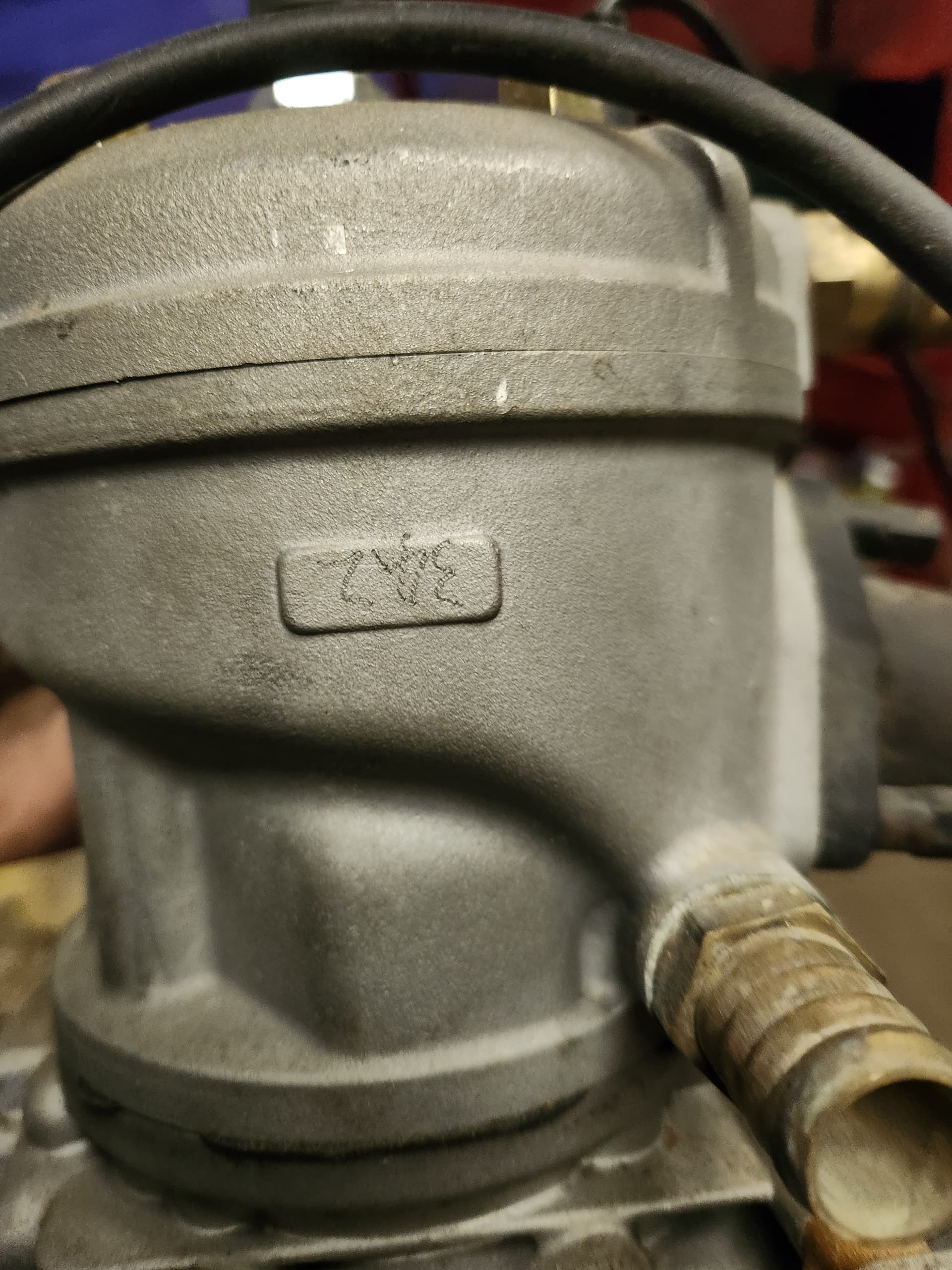

Hello i bought a used cart off marketplace and it came with a racing engine and I was just wondering what engine or where a good place to get info is.
Its marked “342” on the top and “sq0810310028” on the bottom and “246” on the side. It also has red tags on it assuming they are there so u dont tamper with the engine “0012382”
Anything helps thank you
looks to be a Formula Blue replica (chinese copy) engine, probably a copy of the Parilla Lynx
Didn’t SQ have a “Cheetah” or something like that?
This appears to be a more modern version…
Any way to find out for sure, or what mixture to run on it?
You can use the IAME leopard as a reference. Some people run at much oil as 16:1 others closer to 21:1.
Whatever you pick it’s important to consider your carb settings might change slightly if you revert from one ratio to another.
