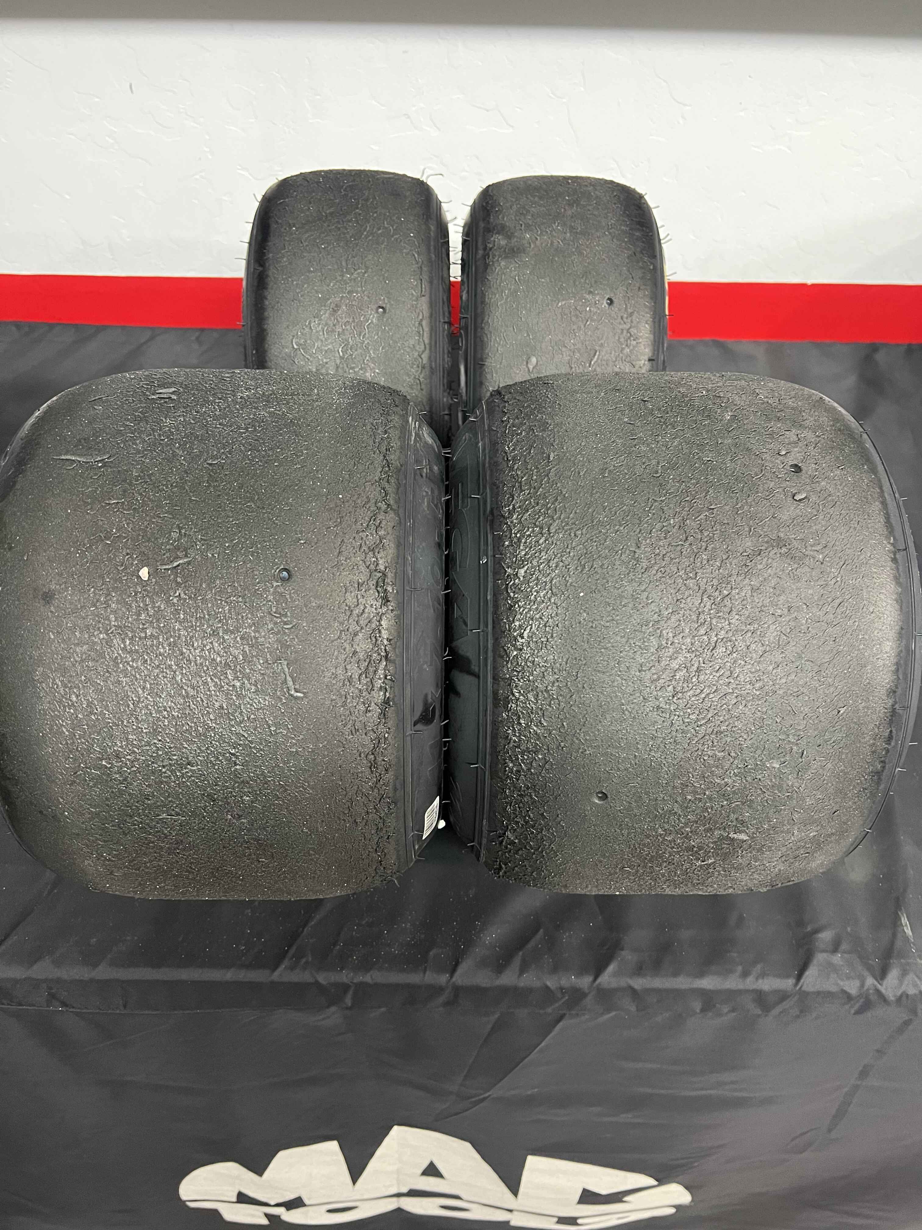

Help me read my tires
Just getting back in to the seat after MANY years out. Did a few days on old tires knocking the rust
Off. Finally felt ready for stickers, Vega XH4.
Cold psi 10, hot around 12, ambient approx 80F, didn’t get a track temp but would assume slightly hotter maybe. Standard OTK set up

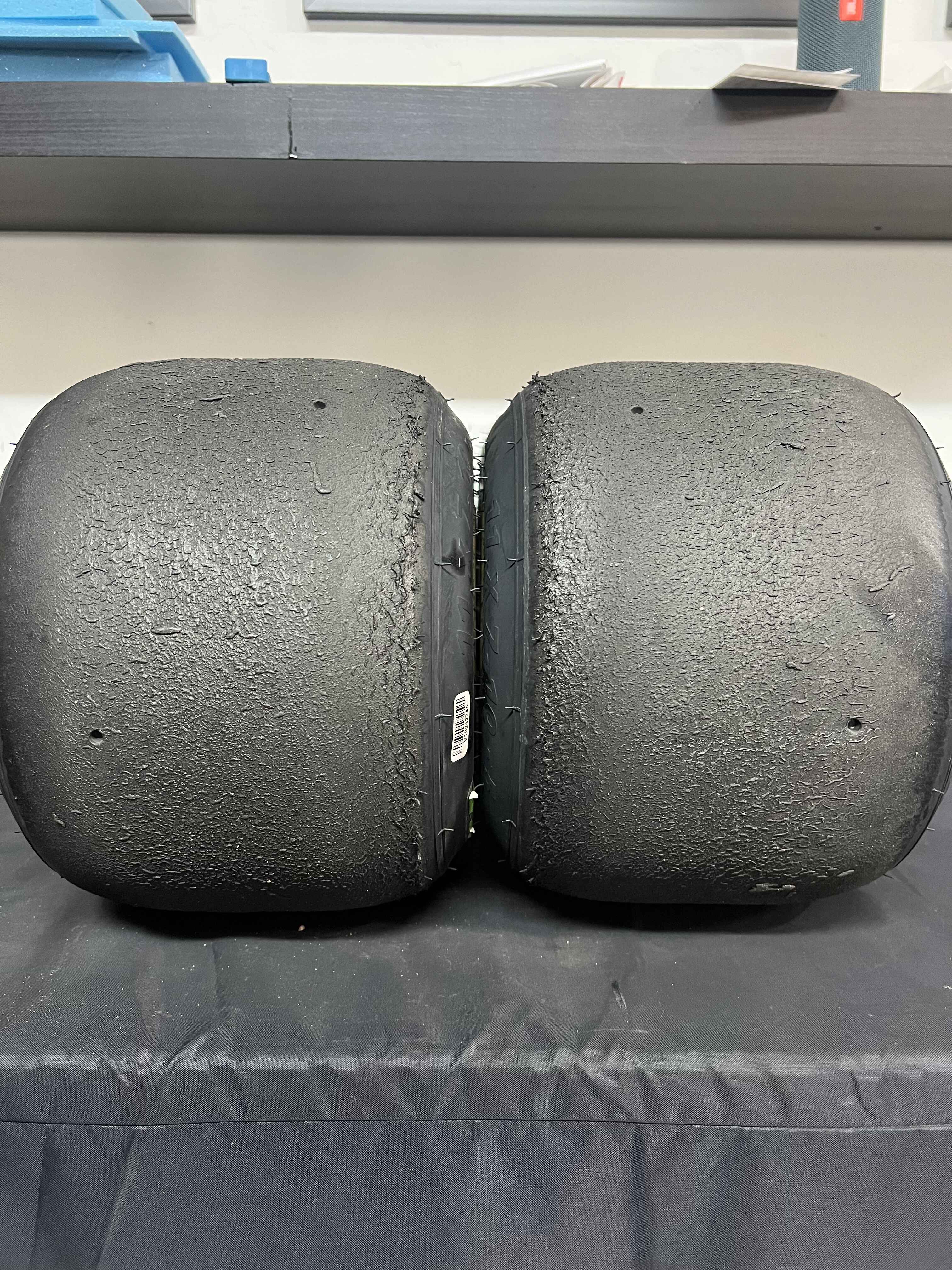

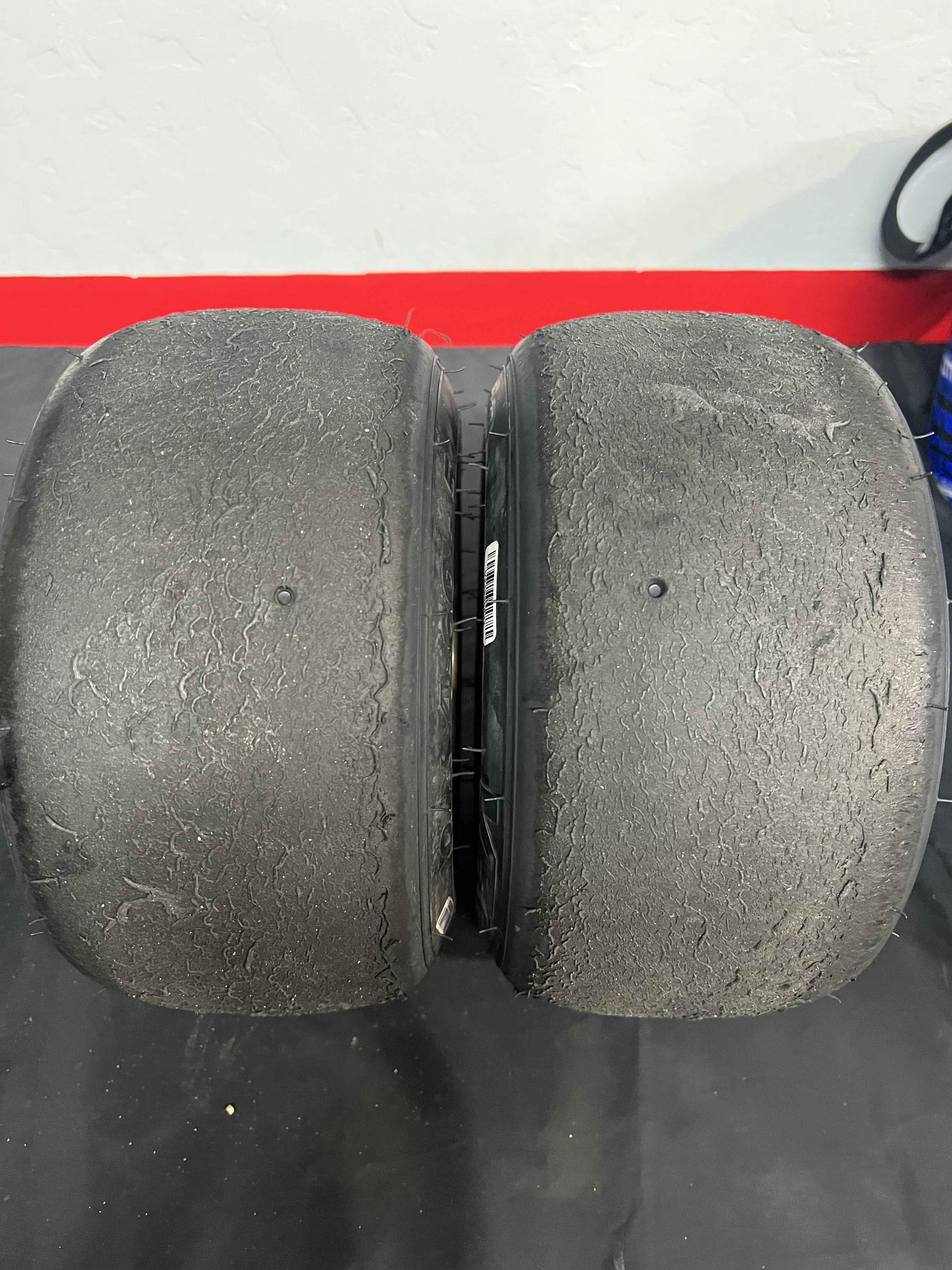

Approximately 15 laps on these between two sessions. They are arranged as if standing behind the kart, LF is the LF in the pic.
Seems like too much graining and
In the rears you can see where the tire was riding mostly on the inner third (I think???) pressure related ???
Kart felt ok, gained 4 tenths over my best with ovenco blues, total lap count unknown but felt fine. Vegas for sure came in faster.
Any thoughts appreciated!!
I’m not super familiar with Vegas but those look decent to me. No big feathering to indicate sliding though the fronts look a tad more grainy than the rears which could indicate either over driving corner entry or understeer.
Nothing is really jumping out as being significantly wrong with the tires. The wear for the rears looks normal, and your pressures are in the right ballpark for single speed applications (if KZ I’d go a little lower, more like 8-9psi but it also depends on the track). To me the sidewalls on the Vegas feel really soft so you could even play around with bumping the pressures up if you feel the tire rolling over at all.
In my experience with these tires, they tend to come in very quick and feel great in the first heat cycle, then around the second heat cycle performance can drop off fairly dramatically. Obviously this can be exasperated with overdriving or excessive sliding - moreso than with other tires I use - but luckily these ones seem like they haven’t been abused based on your pictures. Just don’t be surprised if you see your times drop a half second or more over your next couple of sessions. This might also be track dependent, but that’s been my experience with Vega greens.

Both front and rears look like they grained due to being brought up to temperature too fast. Surface being dry and sandy indicates very green track and lack of grip.
Vega’s have 2 laps in them when new, after wich they will stabilize at around 2/4 tenths slower for the following sessions depending on track conditions and configurations.
They need to be brought up to temperature gradually. In a qualifying scenario this would look like one slow outlap, one lap at 75% load in corners and the third and fourth full load.
You should aim for 0.90 BAR hot on a green track, and 0.85 with grip for the XH4.
