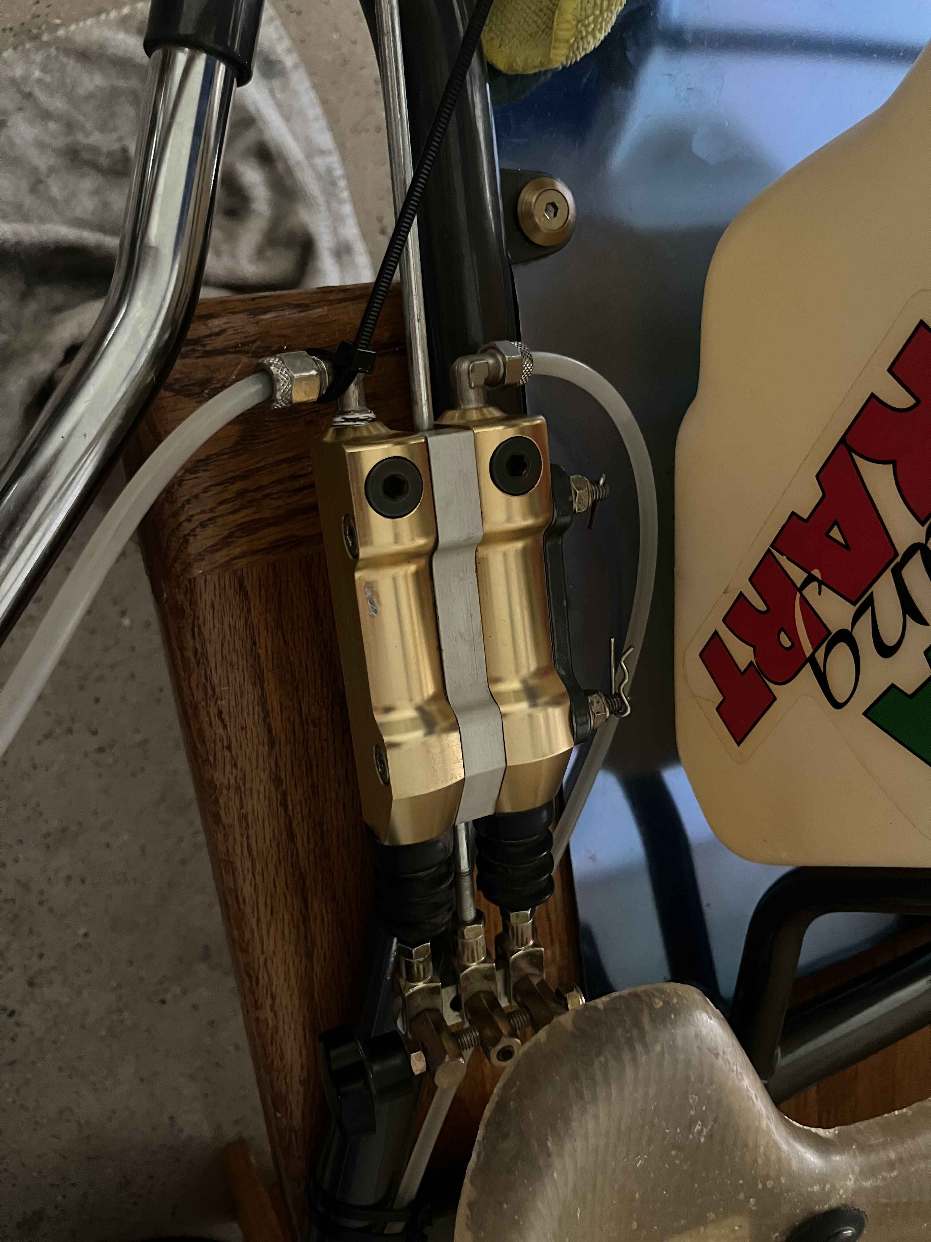

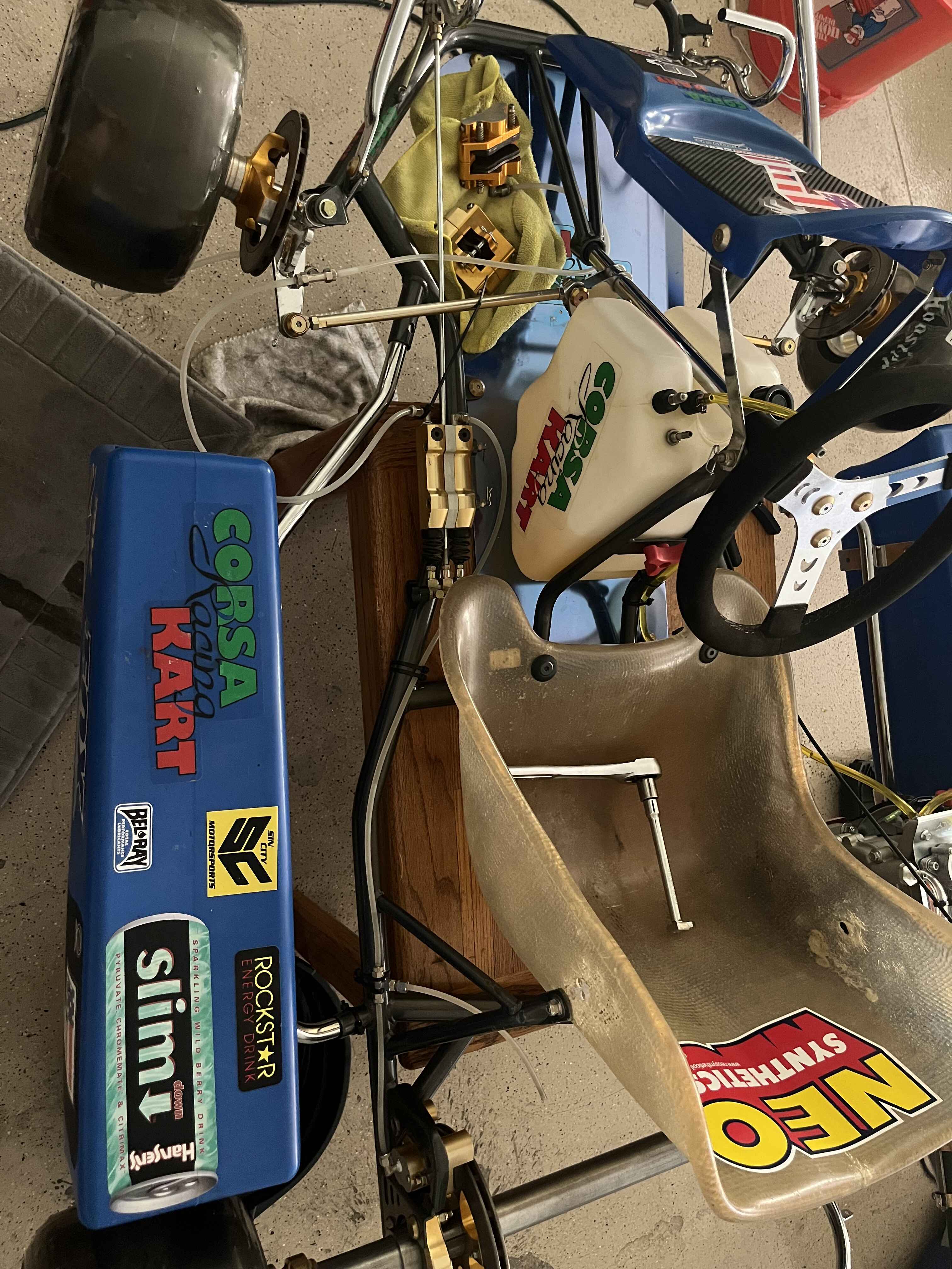

Long story short- took my front brakes off and now am going to run that brake line to the right rear caliper and have the original rear brake line go just to the left rear caliper. HELP- I measured everything and I need roughly 36-38 inches of 3/16 steel brake line but I can only find it being sold in 30”, 32”, or 50” segments. Would having 50” be bad? Any other ideas? Also any recommendations for line or adapters would be much appreciated.
Thank you

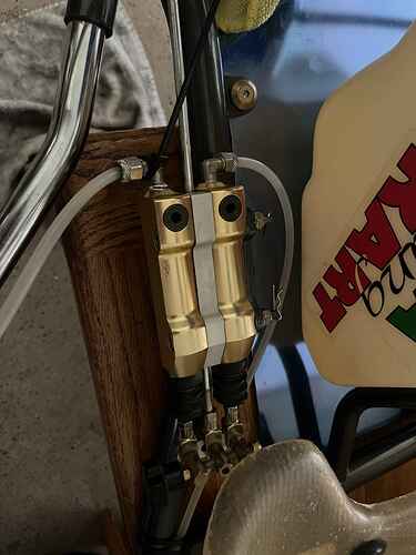

Also if anyone knows what connector I would need to connect the 3/16 braided brake line to my Runner FR/08 brakes that would be very much appreciated

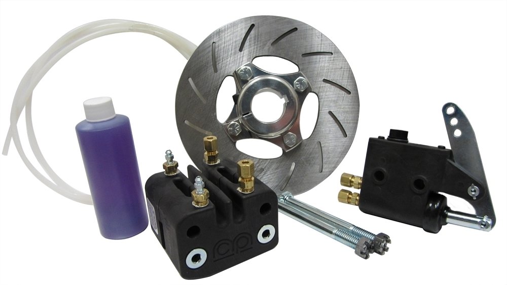

The nylon line is available from most bigger kart shops if you want to stay with that.
Otherwise, check the dirt oval kart brake lines and get a metric to american adapter…
OR
Metric kart lines of stainless type are available here up to 41" length:
Thank you so much, I think I’m going to get the line from kartorama now I just need to find a mtm adapter that goes from the brake line to my runner FR08 master cylinder
