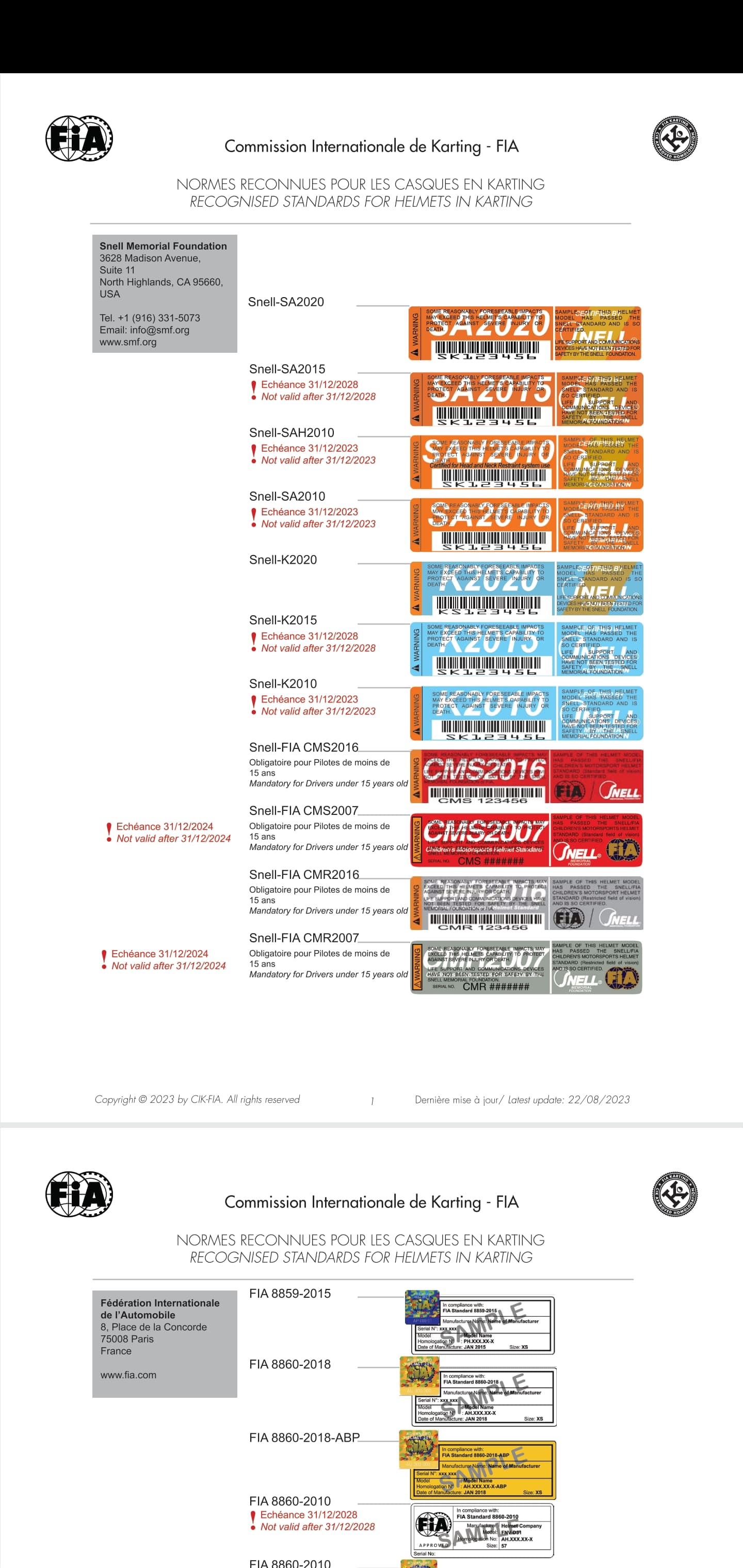

i think there is on the Fia rib protectos you use on big events like this ons:

I believe suits and helmets are 5 years from their FIA start date or whatever. I’ve never heard of anything else being homologated for karting
Yeah thats what i believe too helmet like snell2020 it expires in 2025 and so on. Racing suit it attached on the back of the collar.
Curious about the other stuffs from head to toe.
I thought SNELL was good 10 years after the ratings release? So 2010 helmets are no longer valid while 2015 helmets will not be valid after 2025 and so on. At least that is how my local / regional clubs do it here in the PNW.
I was also under assumption snell rating was 10 years.

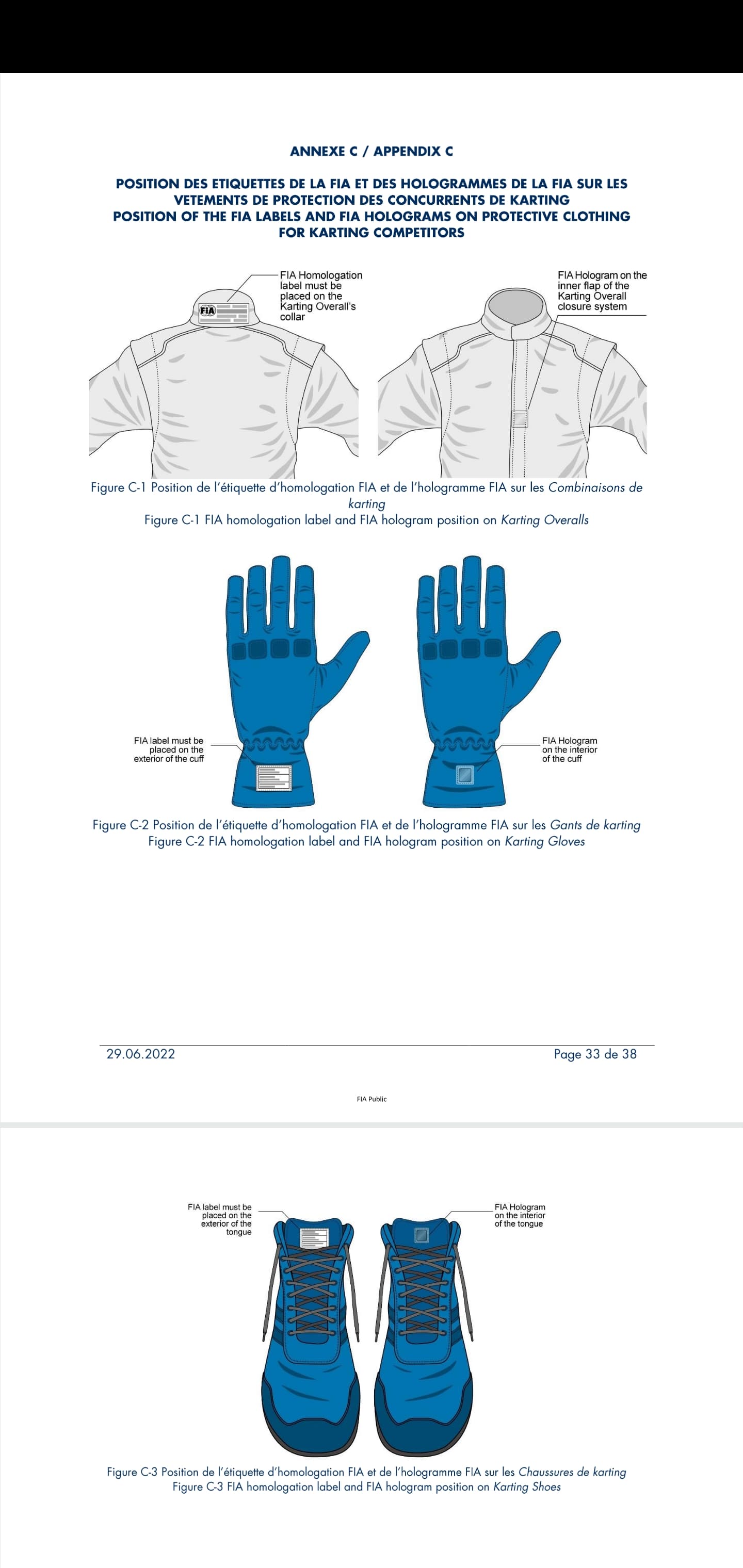

Wait…why does the FIA require karting gloves and shoes to meet FIA-8856? Isnt that for fireproof race clothing?
It totally depends on the competition you’re entering and the regulations they follow.
Most series allow helmets for 10 years after the homologation, so an SA2020 will run out in 2030 for example.
For suits most series in the US don’t even request an homologation and I’ve never seen anyone reprimanded for using the wrong suit (a nomex car suit in karting for example). But suits are 10 years and can be extended.

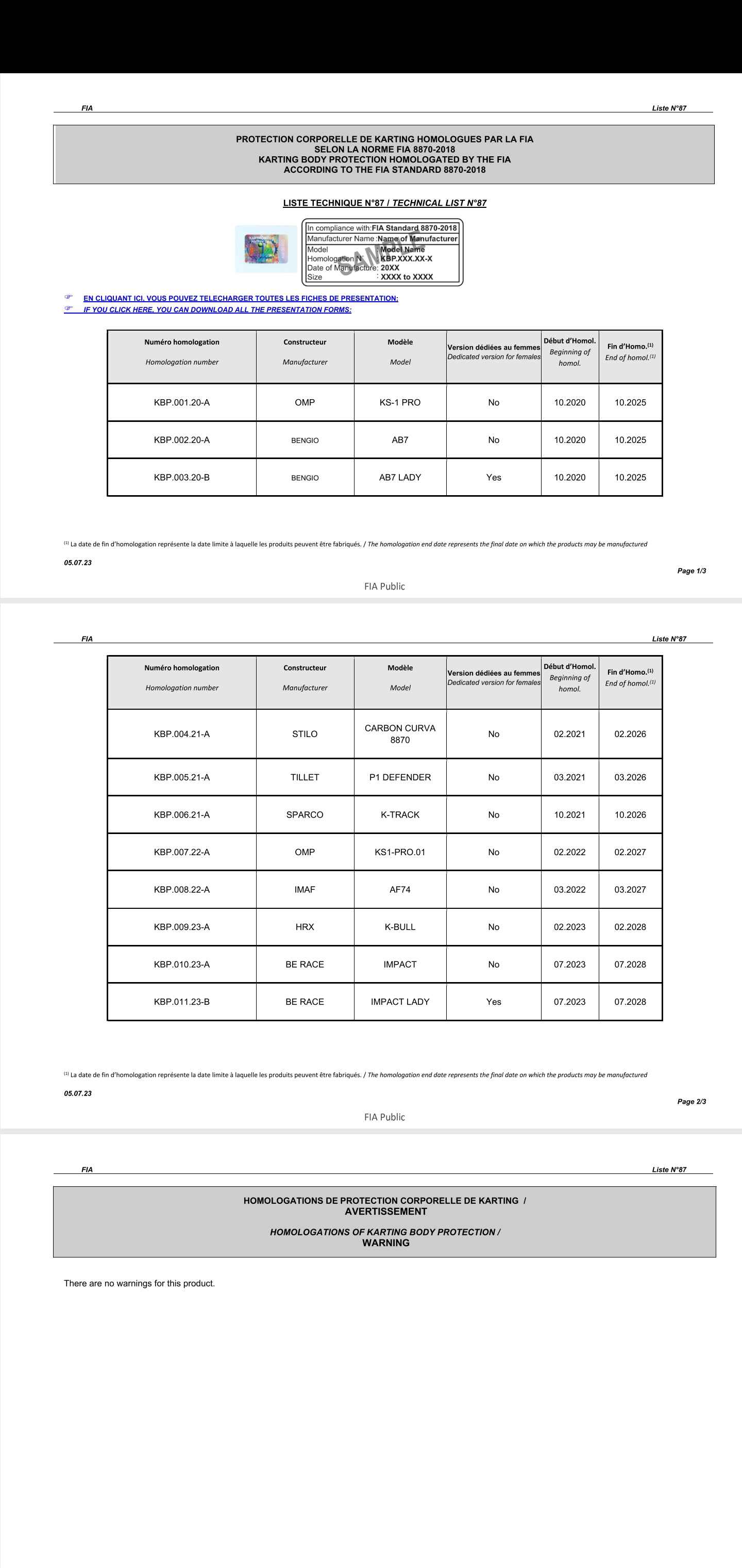

I noticed recently there’s a boot and gloves homologation but I haven’t looked into it.
In the US? Homologation? I think I won a 206 race once in a nylon windbreaker and jeans when I forgot my kart suit.

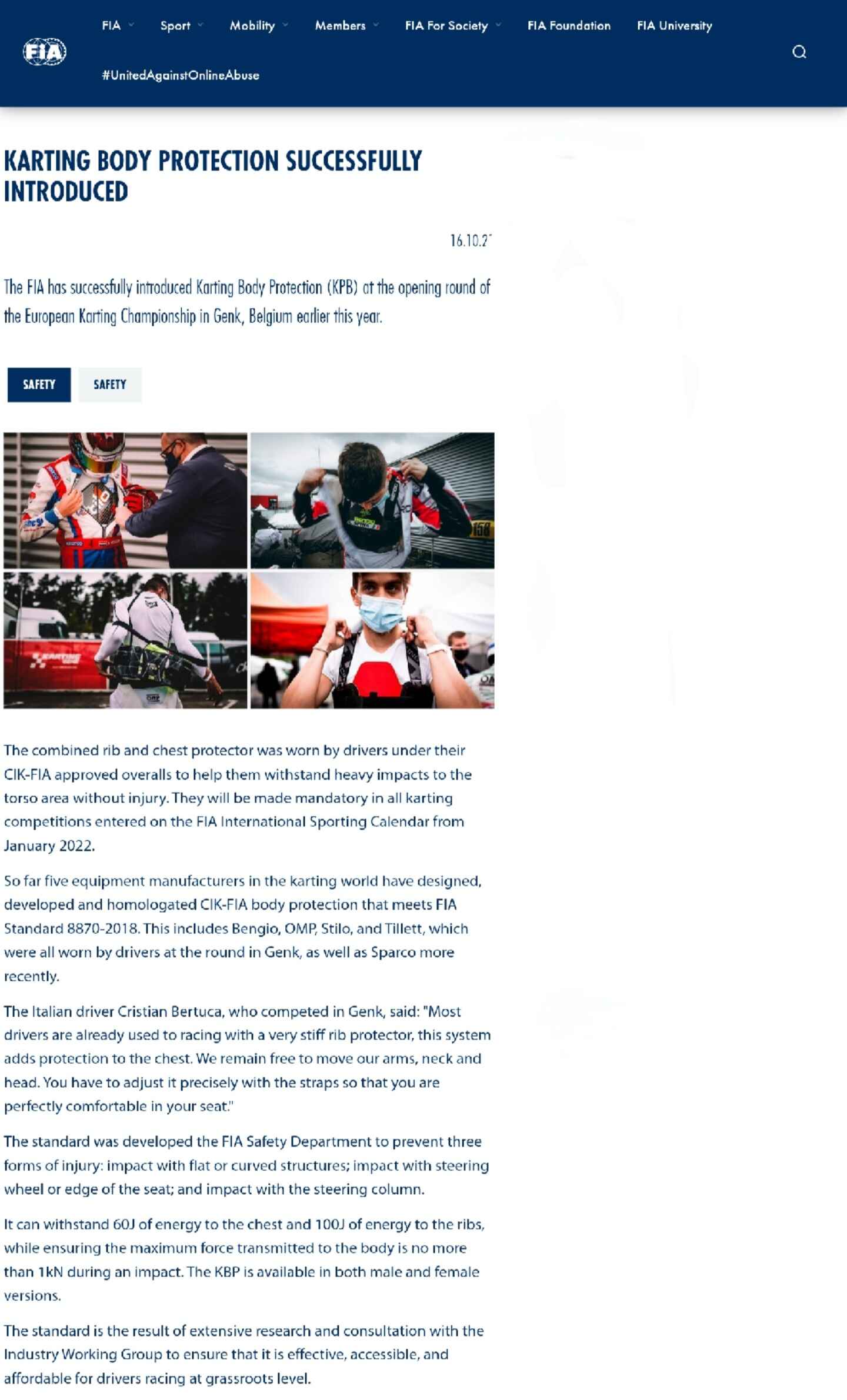

This is all relatively new as is the rib protection homologation. There’s also now two standards for suits. One for shorts and one for long circuits, though no one is building for long circuits yet.

I’d actually consider the full on chest/rib combo. You take some hits in rentals, in ways you don’t see with competent drivers. Tbones etc. chest might be a good idea.
