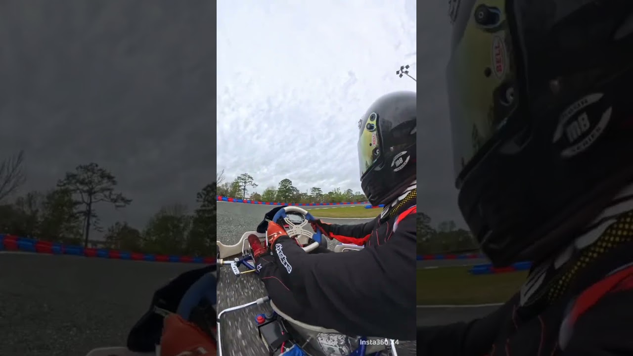

Video displays better on youtube.
I’m racing next weekend on the “clockwise northeast oval” config at 103rd Street (Jacksonville). It’s a very short lap, some of it is too narrow to weave without getting marbles, and I only have 4 laps for qualy.
In the video above, it’s 64 degrees ambient and I’m on new MG yellows. I knew warmup would be tough, so I started at 12 psi, and the tires still didn’t come in until lap 6 or 7. Ending pressure was 14.5 psi all around and tires weren’t falling off even at that high pressure. They still felt fast after 15 short laps, didn’t feel overheated or greasy, just plateau’d.
What could I have done differently to switch on the tires faster and get a good lap on lap 3 or 4? My best qualy lap would have been 8 tenths slower than what I’m really capable of. Thank you.
Laptimes:
41.82, 35.44, 34.34, 33.84, 33.61, 33.56 (tires feel fully warm), 33.25, 33.37, 33.09, 33.00, 33.00, 33.10, 33.09.
