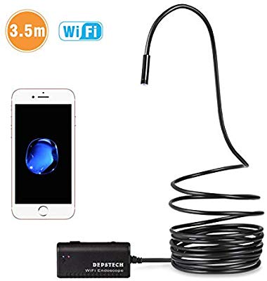

You could peer into the cylinder with a scope like this. You can even record with it, which is nifty.

Gotya, naturally the only thing you can do without breaking the seal is inspect the cylinder wall. Scopes like the one I linked often come with attachable mirrors that make it easier to see out the side.
