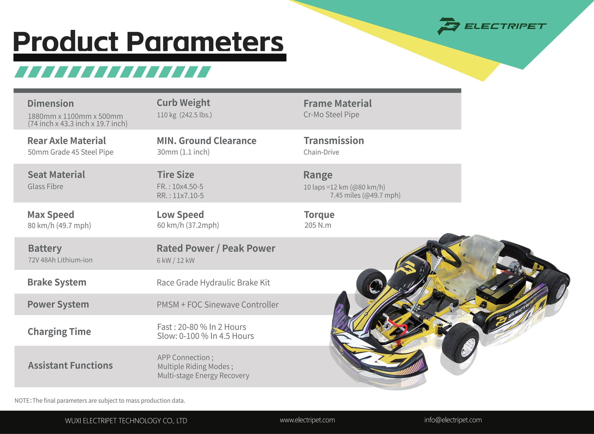

We’re Electripet, a brand new manufacturer diving into the exciting world of electric vehicles, and we’re thrilled to share our latest project with you: the SuperEgo Electric Go-Kart!
We’re passionate about pushing the boundaries of electric performance and design, and the SuperEgo is our first step into the karting scene. Take a look at some of its specs:
Dimension: 1880mm x 1100mm x 500mm
Weight: 110 kg (242.5 lbs)
Frame: Cr-Mo Steel Pipe
Max Speed: 80 km/h (49.7 mph)
Range: 10 laps-12 km (at max speed)
Battery: 72V 48Ah Lithium-ion
Power: 6kW Rated / 12kW Peak
Torque: 205 N.m
Braking: Race Grade Hydraulic
Charging: Fast charge 20-80% in 2 hours, Full charge in 4.5 hours
Cool Features: App Connection, Multiple Riding Modes, Energy Recovery!
(See the full parameter sheet attached in the image!)

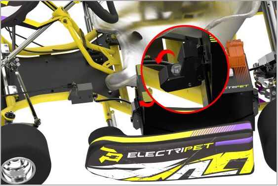

I will be honest I’m probably not your target audience. I think the range and the time to full charge are huge drawbacks. Is the battery easy to swap?

Easy to swap, just to unlock the 2 parts then you can do it.

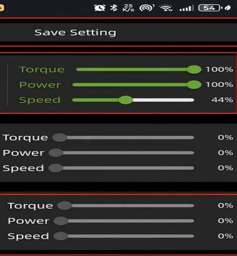

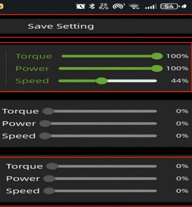

We have bluetooth on kart and use app to do customized setting. Here’s a beta interface.
