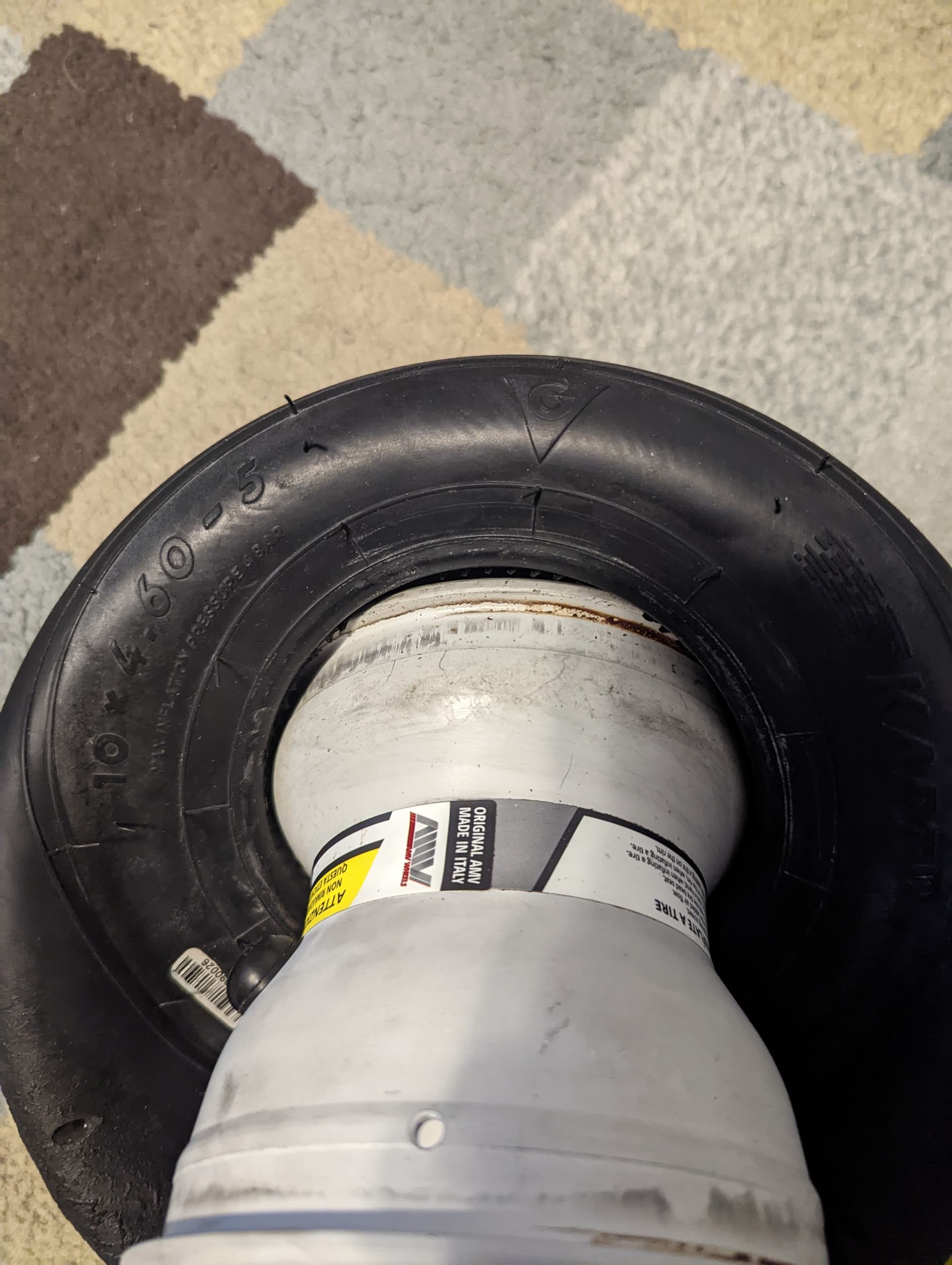

Looking for some tips here from the poor souls that mount/dismount tires from these rims. Clearly, they were designed by an evil mind. As much as they work great, they are a giant PIA to take off.
Normally, I can mount/dismount a set of reds by hand pretty quickly. The issue I’m having with the AMVs is with the second step of dismounting them, when you need to pull out the interior rim from the tire. Due to their design, there is barely any gap to get them started. The rears I can manage by using my weight, longer rim=more lever. Fronts are a massive pain.
How do you you do it without tools?

I just spent 4 days at the SuperNats with Claudio Stefanello the AMV engineer and owner. We discussed this a bit…unfortunately it was all in Italian so I only understood about 80% of it.
Interestingly, the dimensions of the “lip” are exactly the same between the Lynx and 3F but the Lynx is easier to dismount because of the shape of the “bell” of the wheel. Therefore there is not a magic trick to get the tires off other than pinching the tire down and get your angles right.
Personally I highly recommend a tire scissors and use it on the outside and inside sides of the tire. For me, it works well.
Others like the KartLift tire changer.
Also the tire soap really helps.

If you want to avoid ruining the finish you could just wrap the end of the tire tongs in a sacrificial soft material. Few layers of duct tape may work

Make sure you’re not attempting with cold tires. The warmer they are, the better. Set them in sun, put them in front of heater, whatever - but cold = suffering.
We run MG reds on 3F at the local track, so I have the joy of changing 4 narrow tires/rims every time for my little guy’s cadet… I dread it. Lots of Dawn dish soap, tire tool, warm tires, making sure they’re coming off the back side of the rim, and a little bit of cussing.
