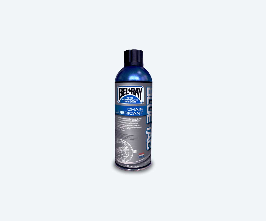

This chain lube from Belray is the cleanest low-sling lube i’ve found yet.
Agreed, lube the 219 chain after every session, ideally first thing coming off the track when the chain is still warm, which helps sweat the lube into the rollers.
From there you can use a rag with some wd40 to clean the outside of the chain, which will also help reduce sling.
Awesome thank you for the info! Would this work good on a 35 chain on stock 4 stroke engine?
