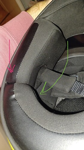

Put your index finger between the pad and the rubber trim at the pink arrow, and put your thumb in the helmet behind the pad and pull on the back of that pad and it should come out pretty easily.
It might have some glue, not sure if EU models are glued in.

It will depend on what size your helmet is. Not sure how Bell measures it. On the Arais at least, they have a tag under the fabric that says what size cheekpad it is. Maybe if you get the pad out, you can pull back the fabric and there is a label? I can’t remember if Bell has that.
Talked to the guy from demon and he told me that the cheeks cannot be removed. He says that they are kind if glued in the K Model. So now im but confuesd if i shsll try it or not
Well technically, anything can be removed. :sweat_smile:
But if they are glued in and you are worried about breaking the foam or having them not fit properly once you pull them out, then best to leave them in.
I don’t think they are glued in on US market helmets, but I can’t remember. The K model might differ from the standard RS7. Notably, your padding has different fabric than the helmets we get here.
He said not directly glued but i quote “not removable linings” so maybe its the case
