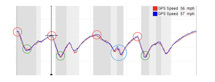

Red - these are places you are braking too early.
Green - here you can see where you release the brakes earlier than your coach, and because of this, you are rolling more speed in the entry phase, but you are much later to throttle because of this. You haven’t gotten the kart slowed and settled down, so you have to delay throttle input, and sure, maybe you make up 0.05 during the very final phase of braking, but you lose multiple tenths on exit and down the following straights. One of the first things I take a look at doing data is the braking traces and you can see the blue lines are all on a steeper trajectory than your lines. That shows strong and more optimized braking, as he is slowing down quicker than you. And then you can see the traces diverge in the final few feet of braking as you release the brakes and coast into the apex more. Any time we are coasting, we are letting the kart set the inside rear wheel down and not loading the kart or tires to their max.
Blue - another example of trying to carry that speed into the corner too far, and being delayed on throttle input. More easy to see the effects here as this is a rhythm section.
Also note how you are achieving less top speed because of your poor corner exits, but even though you are still going slower than your coach as the braking point, you are braking earlier than him.
We want to be rolling into throttle and driving through the apex so we extend the following straight as much as possible, rather than coasting with excess speed into the apex.
If we say a corner has a maximum potential apex speed of 30 mph, it is MUCH better to accelerate through the apex at hit that 30 mph max apex speed on throttle than it is to be scrubbing speed off all the way to the apex and decelerating to 30 mph at the apex.

Man, this is great stuff. I guess I convinced myself that more entry speed would save time, but it’s actually costing me time because I’m sacrificing exit speed.
Your points make great sense to me (red areas, blue, green, etc.).
