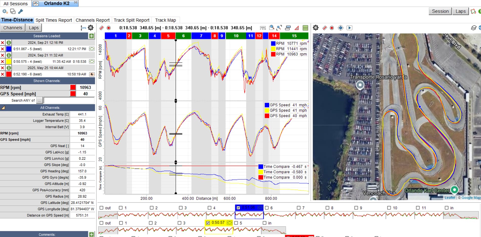

Bumping again. Since my last posted data in January, I’ve been practicing at 103rd Street (Jacksonville), just working on braking later and harder. I set up a cone for a braking point and move it closer and closer to the corner each time I go there. I can brake about 4-5 feet later into one particular corner in Jax.
I went back to OKC and tried to apply what I’ve learned. In this new screenshot, yellow is coach Daniel (50.575 on used tires), blue is my all-time best lap from September 2024 (51.067 on new tires, same kart and day as Daniel’s lap and videos are posted earlier in this thread), and red is my best from this past weekend (52.190 on new tires in my newer model of the same chassis + engine).
My turn 1 braking trace (red) is now closer to Daniel’s (yellow) than the old blue line. Also more similar to Daniel in turn 3 kink (segment 2 in RS3 graph). Also more similar to Daniel’s speed trace in the turn 9.5 braking zone (segment 10).
Despite this, I am now a full 1.1 seconds slower than before. My minimum apex speed in turn 1-2 is really low compared to the blue line, and I also lost a lot of time in turns 8-9 (segment 8-9 in RS3). Some corner exits have been redone with bumps so you can’t track out as much and another driver in the pits said track conditions were poor because it had rained the night before (you can see a puddle in the video), but I don’t think that accounts for an entire second lost.
Where should I go from here? Ignore the stopwatch, keep practicing late/hard braking, and trust that this will pay off in the long run? Go back to driving more like the blue line? Something else?
Thank you.

It doesn’t surprise me that braking harder and later makes you overslow initially. It’s a change and takes you out of your comfort zone. Keep plugging.
I felt like what changed for me was the duration of harder braking and its release. Try braking harder but getting off sooner. Try to make that happen such that it feels balanced. Once harder braking becomes a less novel sensation, you will link it to the flow and it will feel smooth.
Not sure if that’s helpful. But anyways, consider the pedal release and play with coming off the brake faster and sooner. You’ll start trailing from hard hits once you play with it enough and get a feel for how the balance changes etc. you are playing catch with momentum and mass shifting.
@Bimodal_Rocket coming off brakes earlier is the blue line, no? That’s what I was doing back in September and it made my corner entry speed too high and lost time by sacrificing exits like TJ said, right?
Theoretically, if I brake harder, then this might not be such a problem since my inital hard braking will get me down to a speed that’s slower than the blue line so I can pick up the throttle sooner?

You cannot compare lap times between Sept 2024 and May 2025. The track conditions aren’t even remotely the same. For example, I was just at Dousman this past week and my best laps were 1.5 sec off my best laps at the USPKS race the previous year. And I literally have probably a million laps there so it’s not like I’m still learning. Track conditions can change day to day, let alone month to month.
I haven’t actually raced OKC but I have watched so many races there I basically understand how to drive the track. One thing I noticed is you aren’t even close to using the whole track out of the hairpin. Obviously that’s not a huge time loss but it’s worth something and is an indicator of other issues elsewhere possibly.
Please help me with this! I started not using the whole track there because I was copying Daniel. It’s hard to get back over to the right before the chicane if you track all the way out at the exit of the hairpin, so my line would often be compromised through the chicane.
I was watching videos of Daniel and I noticed that he didn’t use the whole track there (you can see this in my video of him from September), so I started doing the same. My speed trace in red looks similar to Daniel’s in yellow at this corner. There are other drivers who do use the whole track there.
Which do you think is faster? Does getting a better line through the chicane make up for the time lost by not tracking all the way out after the hairpin? Is there a way to do both?
