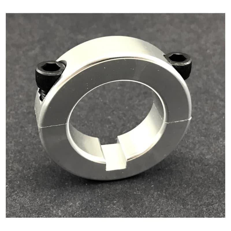

There are cheaper plastic versions too. I have about a million axle spacers in my tool box.

An alternative is the rings.

I like to use the 2 piece clamp to keep hubs from sliding and also act as a gauge. its also handy to cut axles too.
