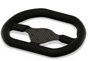

I’m making a custom steering wheel for my kart, I just found a Sparco p310 3d model online, and modified it a bit. I will be cutting the hub out of carbon fiber, 3d printing the outside grip part, and suede wrapping it, I was wondering if there’s a good way to create a “map” of suede that will perfectly fit the wheel? I have access to a lasercutter, so if there is a way to make a digital “map” in fusion 360 or another program and just cut it out, that would probably be best.
Maybe you could do it with the help of a 3d scan tool? Or you could find a model online and flatten the design to get your shape. I know guys who do upholstery will use a material to fit to their surface, they’ll cut it, and use it as a template for the final cover.
I think some paper, a sharpie and some scissors would be your friends. Just make a paper template and transfer it over to your material.
That being said, leather/suede isn’t the easiest material to work with without some special tools and such. I would look at sending it to an upholsterer. It would be cake for them, would probably be a nicer product, and potentially cheaper all said and done.
I already have a 3D model of it, so i would just flatten it and mirror that image?
hmm that may be a good idea
Yeah those guys can do magic, those stitches come out super good
If you have a net of the outside you wouldn’t have to mirror it.

This is a link to the 3D model: https://drive.google.com/file/d/1E2YbV4ayjLsyplycC1fnUdguU-_LSOyG/view?usp=drive_link
would your method work on this?

Sorry for getting back to you late, I don’t have a way to open this type of file, and I personally have never created a net from a model I’ve only created orthographic and isometric drawings. Maybe there’s an online tutorial, but it would likely be easier to use a different material, cut it, and then trace it onto your final material.
