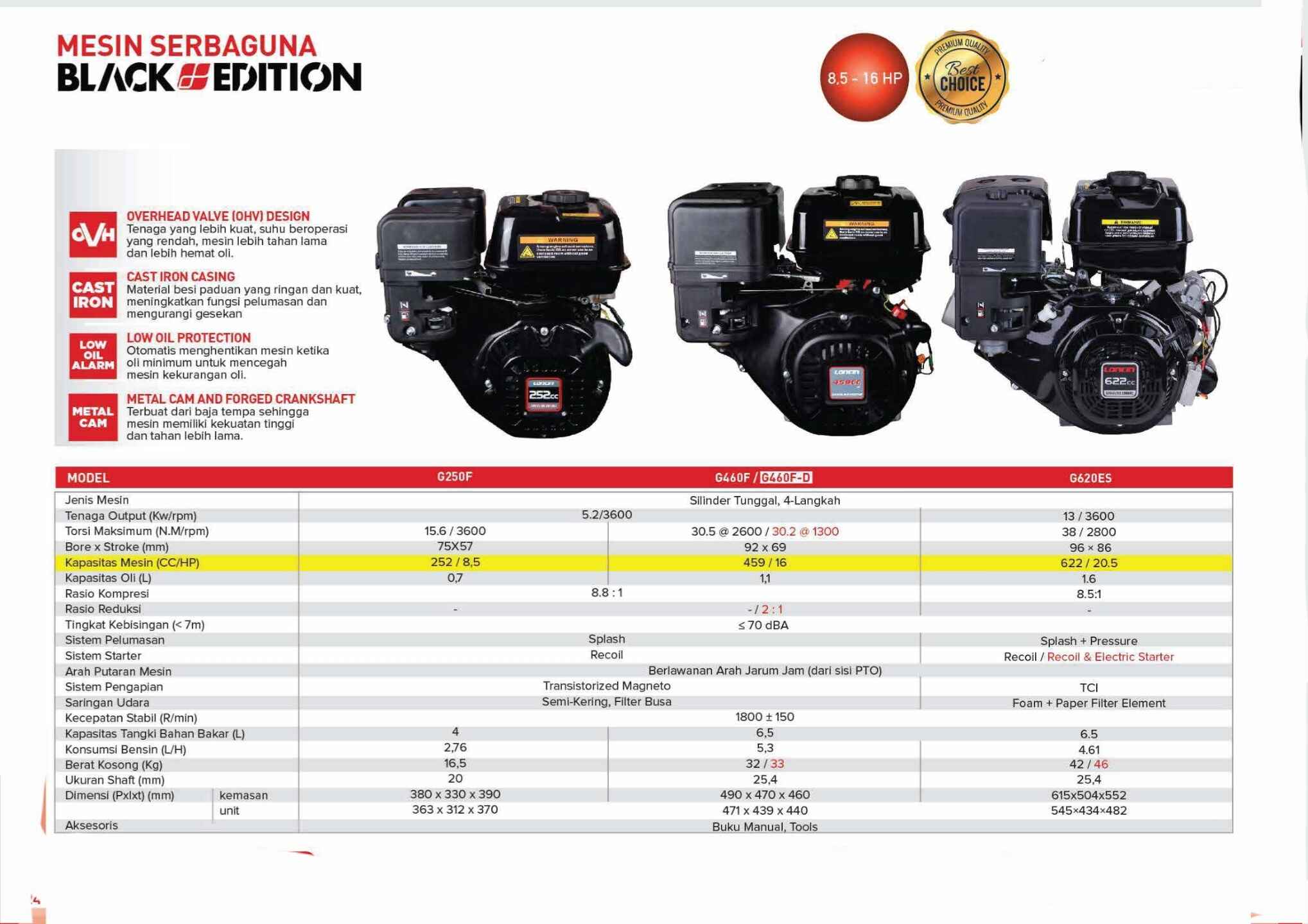

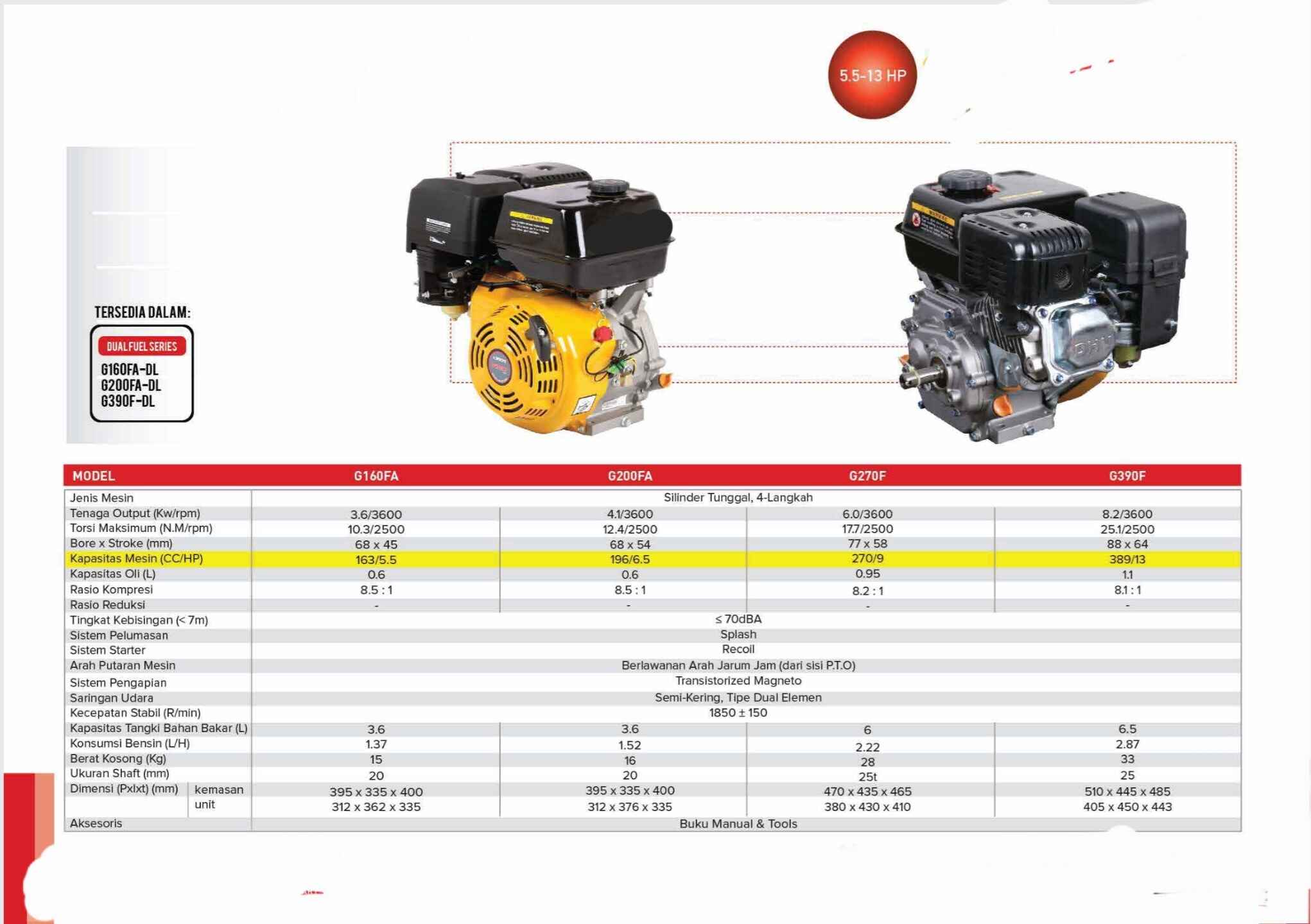

So im trying to make endurance race in my home country. But still unsure which engine should i choose. My local track length is 1.2km about 0.7 miles. Its a clockwise track. I got a sponsor for the engine. But idk which one. Dont want it too slow or too fast. The chassis will be rental chassis.
The choices is.
270cc 9hp
390cc 13hp
460cc 16hp

Is that actually enforced ? Also the power figures seems a bit strange. G250/G460/G620 all show the same power output despite the torque being different.

270 or 390
270 would be the typical 9hp rental.
390 would be a bit faster and more tiring.
The 390 is physically large and an elbow killer (at least the Honda is).

Between 270 and 390. Is the speed different really noticeable?

I’d say so. The 390 is quicker. It’s not a huge difference though. It’s also a very reliable engine. Either would be fine.

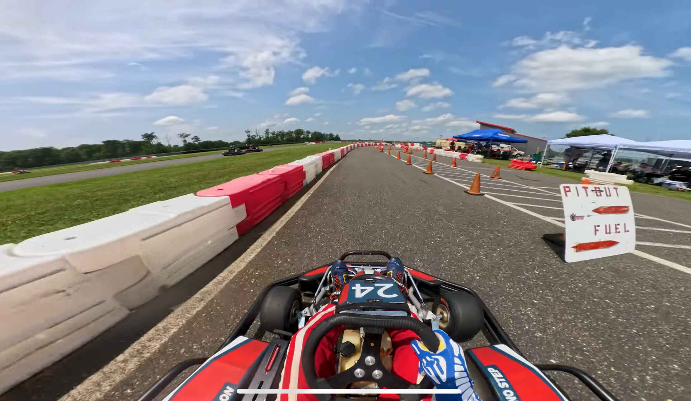

Gx270 will drain its tank in approx 2hrs. So, you will need refuel. This is the tricky bit.

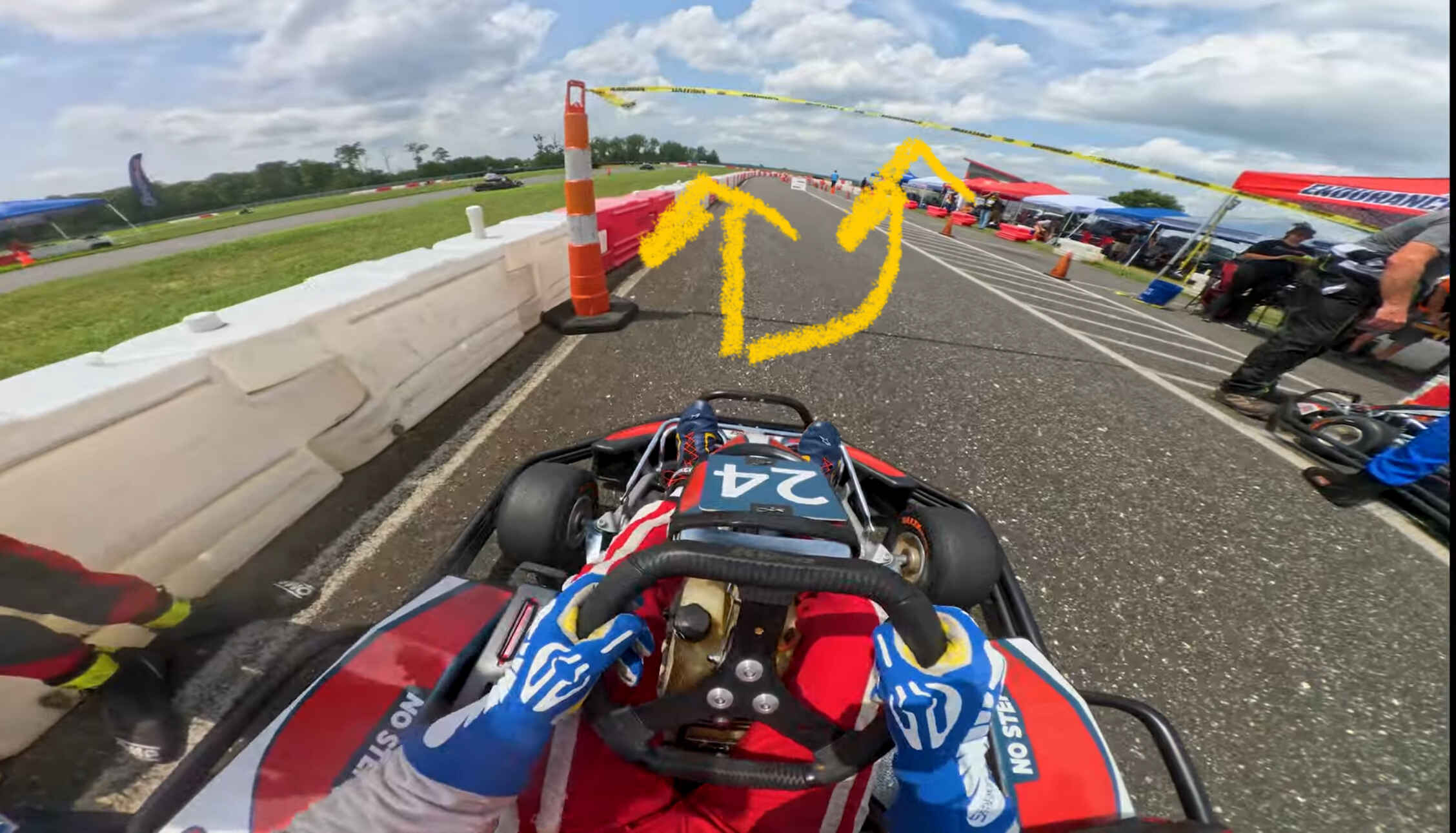

Generally you don’t want accelerants near the customers. The way Chris (endurance karting) does it involves a kart swap and a refuel area.
Basically you come in to pit… the next guy gets in and then, once pit timer is done, instead of leaving onto track, they follow the “other” lane to refuel.
They pull in and are given a timer. They get out of kart. The attendant removes the number plate and puts it on a refueled kart in the front. The driver then gets in the new kart and is waved out after X minutes.
I don’t think you want the racers at all involved with refueling. That should be done in a seperate area by employees.

Regular stops you come in and are held for like .5 mins. Enough time to swap comfortably.
Fuel is 3 minutes. You pull in and are handed egg timer. The attendant notes your entry and starts the 3 min clock on the egg timer, moves your number plate to the fully fueled kart in front of the line.
Pits close with 10 to go. They also close before the midway point as we do a reform halfway through.
