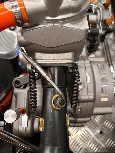

Do you run the 20mm header extension that the 175 SSE uses here in the US? That will change your target EGT’s, as it drastically alters the sensor position relative to the bore, not to mention the exhaust length.
It appears not, these motors only have a 5mm spacer on the exhaust
