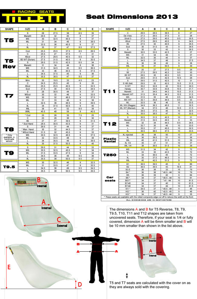

Where could i find this information? Granted i already bought a padded Tillett T7 for my CRG as they worked quite well for us 10 years ago but im still curious.

I have tried a few of the Tillet models and they work well and are a high quality seat. They also have a large range of sizes, shapes and hardness to select from.
