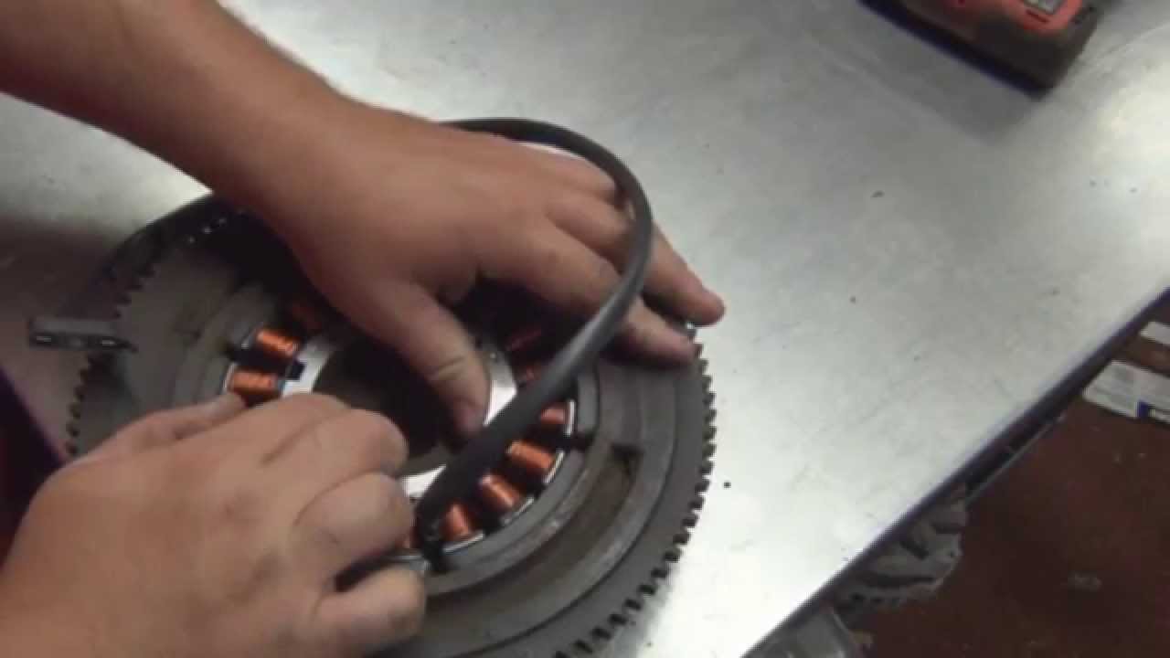

This may help narrow down the issue:
Granted it looks a little different (on the Leopard, the magnets are on the rotor hub on the crank shaft and they spin on the inside of the Stator), but the principal is the same.
