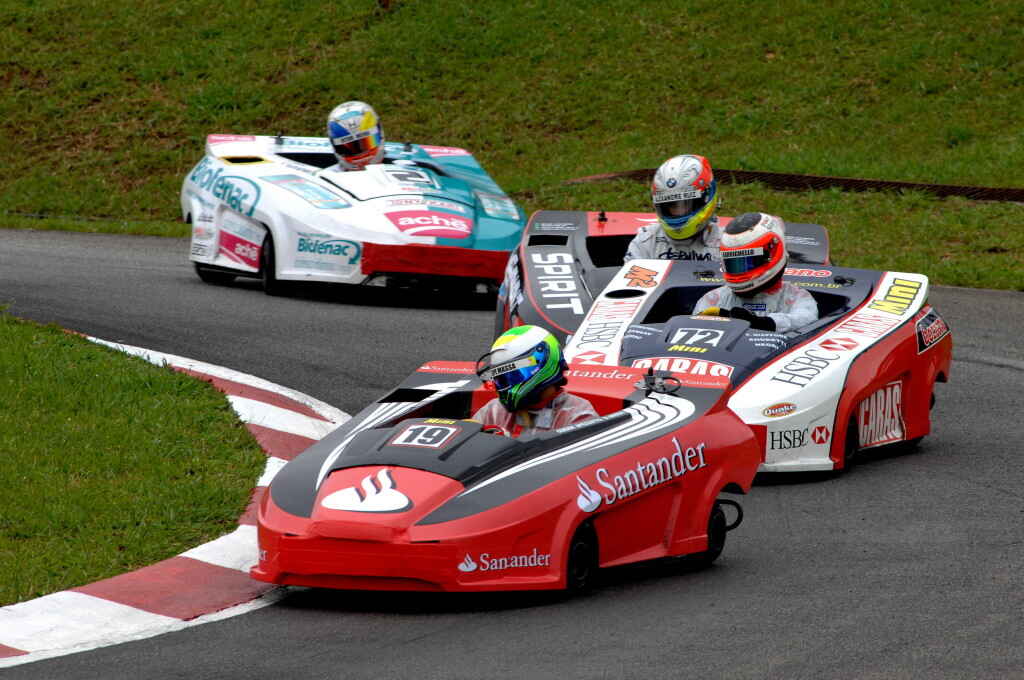

This is an acceptable compromise between unnecessary weight and looking good. Vai Brazil!
They won’t have these, but I may bring one to the practice sessions.
The “Brazilian version” is a regular kart with bodywork on. The one from the original post has a full carbon fiber chassis, a sort of semi-flat tub with all accessories like cassettes, column support, spindle triangle arms, engine mounts etc all bolted or embedded into the carbon tub. Completely different, and more akin to a small formula car, yet with similar overall dimensions of a kart. A bit expensive, so you really want a smooth track to run it on, otherwise if the track is bumpy, you’ll lay down more carbon than rubber.
