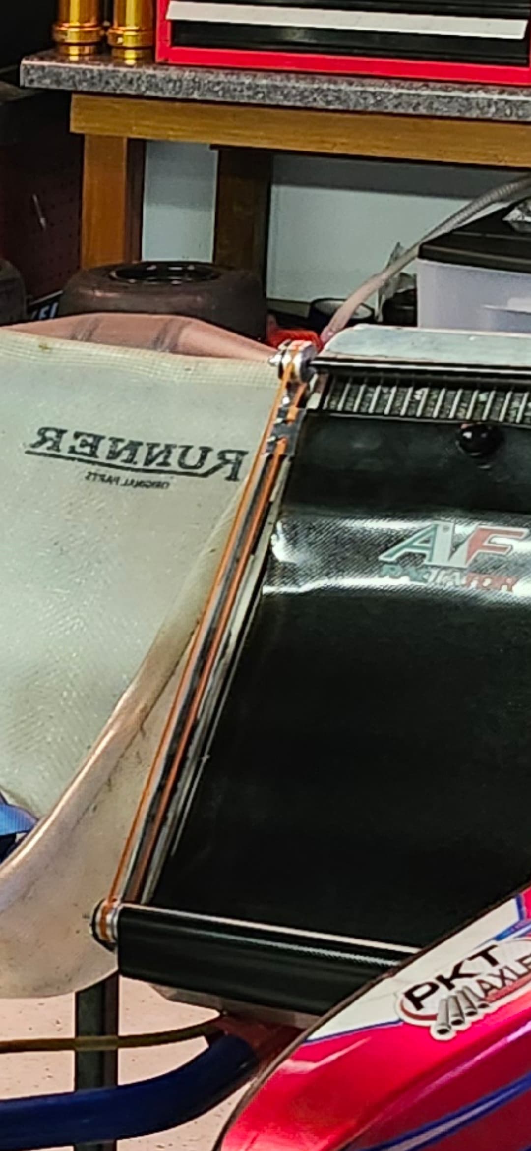

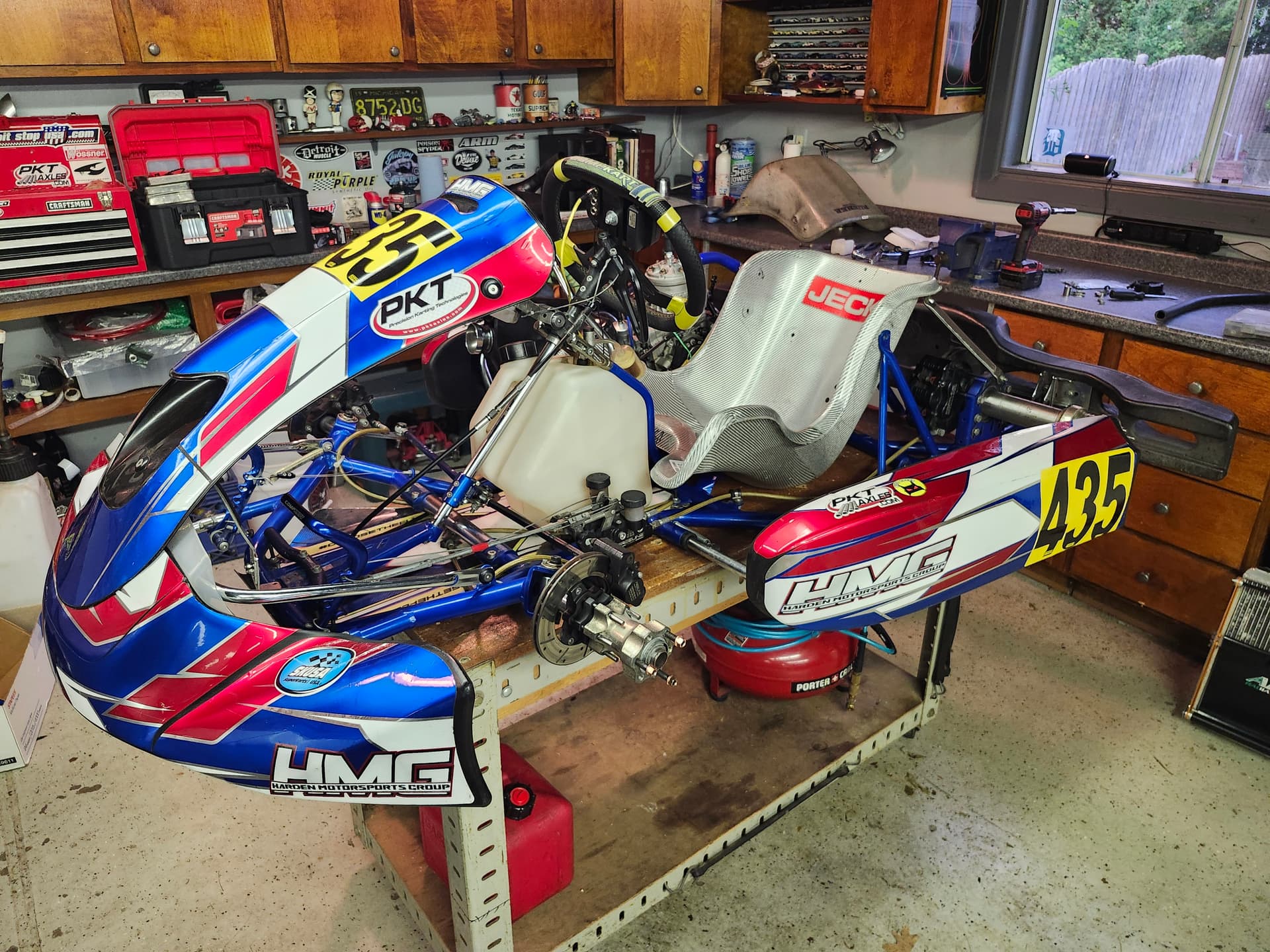

Well.. i got it. Now time to put it in. Question is my seat now is RIGHT ON the radiator (second pic for reference). Im imagining with the new jecko, ill have to move something to compinsate for the bigger edges
Would it be worth it to mess with corner weighting when repositioning the seat? Furthermore, how would one figure out the optimal seating position without mounting and unmounting the seat a bunch of times?
Position close to the rad: no problem. Mine is the same,if not closer

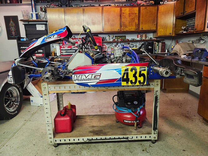

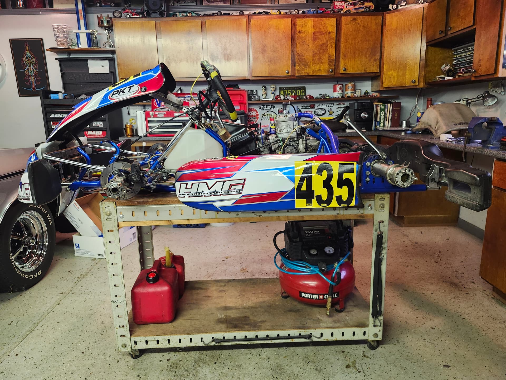

So this is what i normally use instead of the 2x4 across the stand method. I got this little work bench idk how long ago and its the same height as the stand. Its perfect for mounting seats as i can just set the kart right on it.

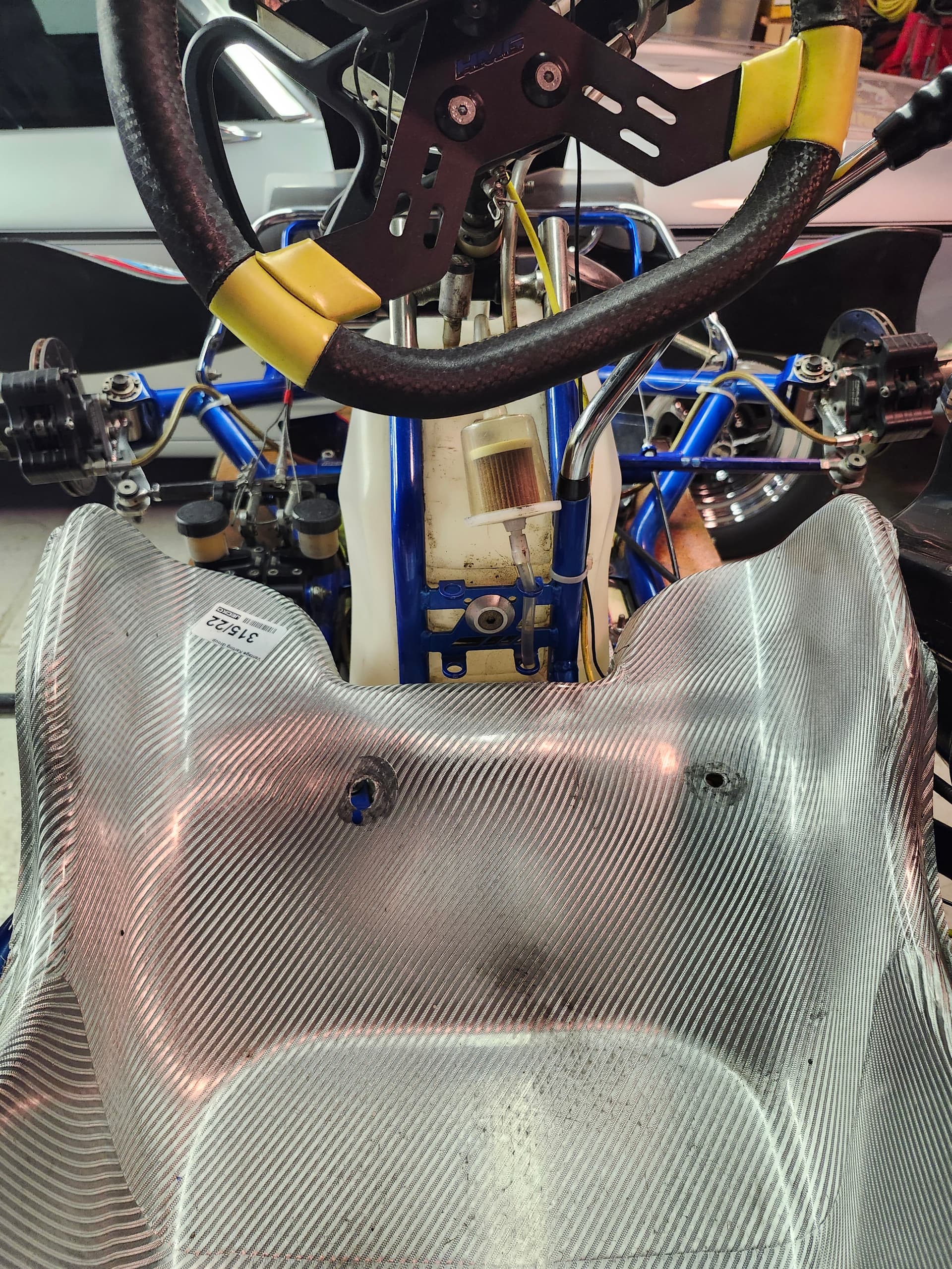

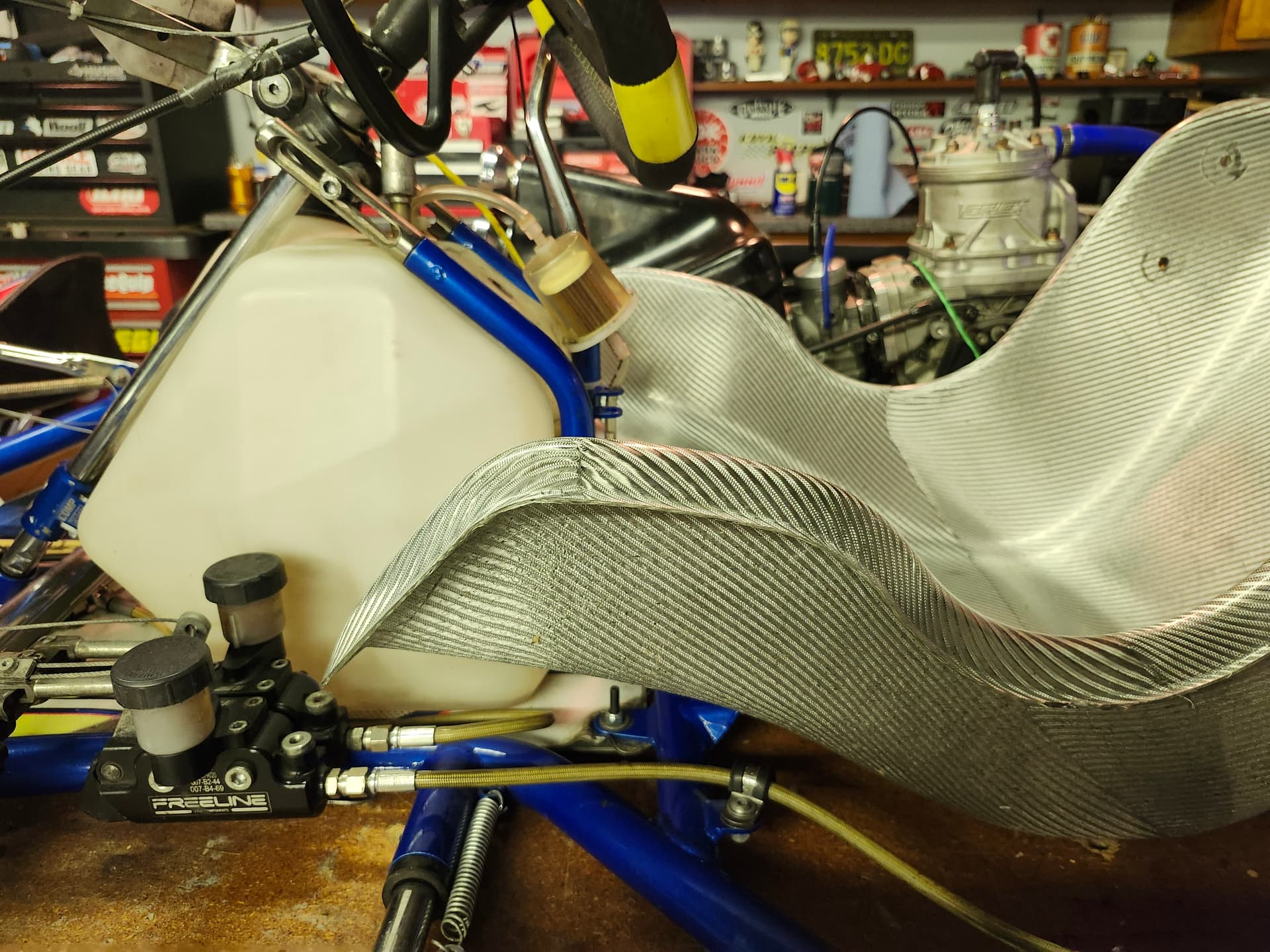

So i got the seat basically set inside the frame. Just removed the rad entirely because its easier than dealing with it all connected trying to figure out how far to move it over.

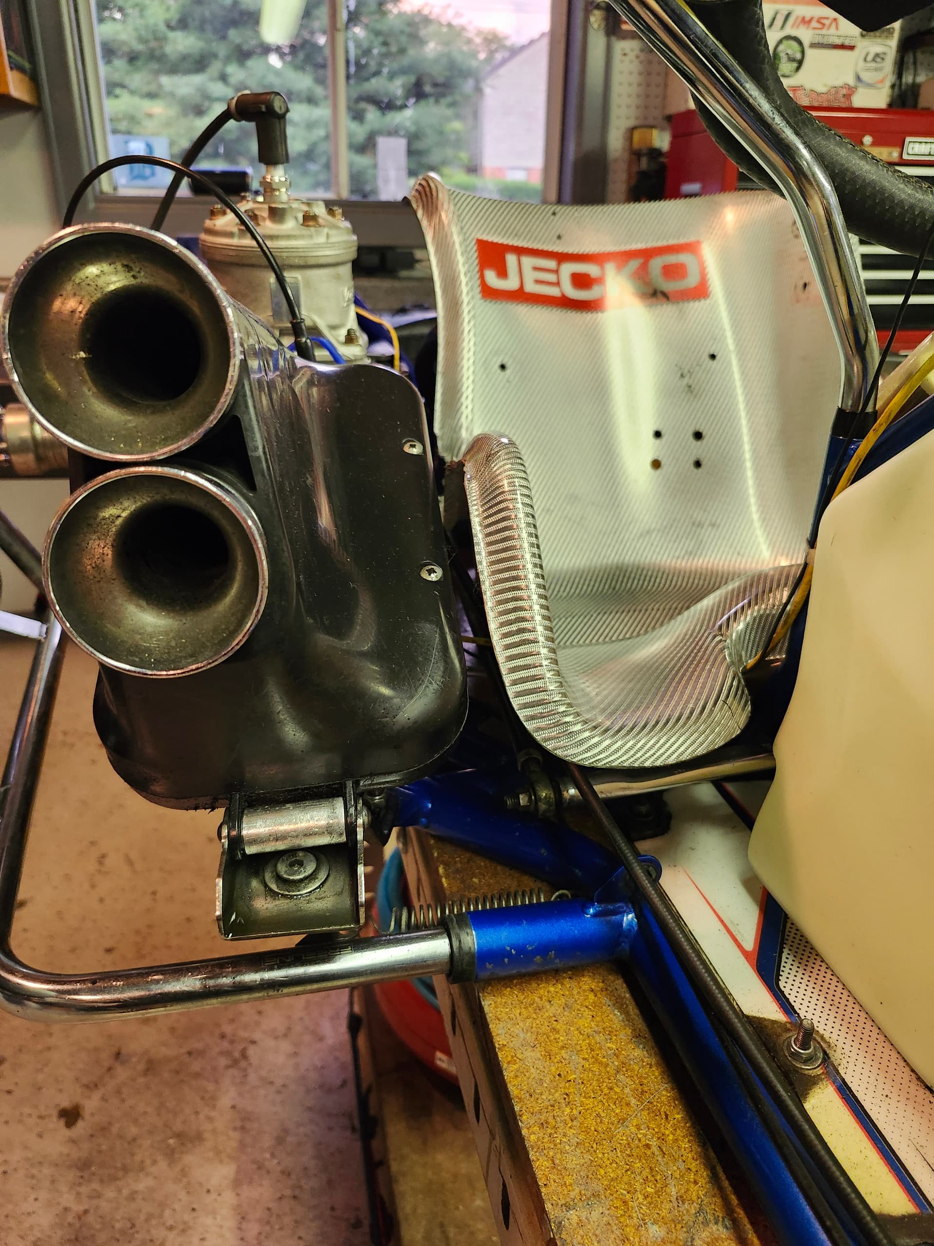

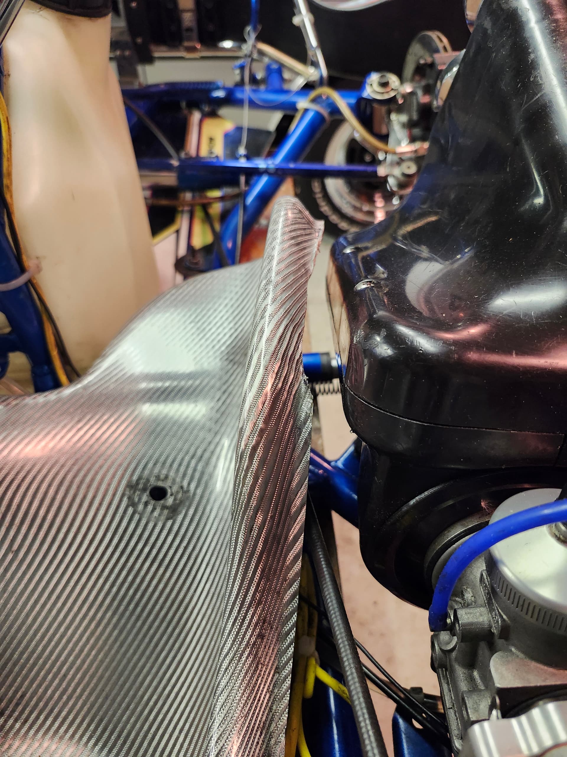

Man this thing is a tight fit! Havent actually measured anything yet but these clearances with the legs on the seat are pretty crazy.
This is my issue any time I’ve tried sitting in a kart with a Jecko. Is just smashes my inner legs against the tank or steering column supports.
So I sat in it again once I took measurements on the table and got the sides of the seat fastened to the seat stays (I need to get shorter bolts for the bottom mounts so that’ll wait until this weekend). Distance wise, my arms and legs feel exactly where they need to be. Its definitely tighter on my thighs next to the tank, but nothings rubbing or being forced into the tank. I’m thinking I may have to raise the steering wheel a bit. Other than that the only way to find out if we are golden is to hit the track!
