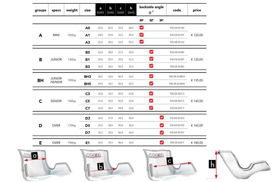

Im currently using a tillet t11 vg large and can almost squeeze into my dads t11vg Medium Large. Meaning i fit everywhere but super tight in the hips. I need to order a jecko seat but have nowhere near me that has one to try first. Any clue what size i may be? I have a kr2 chassis that came with too small of a jecko seat in case anyone was wondering why i want a jecko seat.
Just measure your old seat and compare. But size C3 or C5 would be the most similar in terms of measurement
I have found the Jecko measurements to be wildly different from what their chart says. In my case I use a ML Tillett or size 32 Greyhound, and I found the Jecko C7 fit me the best. The lower hip area of the Jecko seat is more rounded compared to other manufacturers, making for a tight fit in the hips/ass.
If you require a large Tillett then I would guess you’ll need a D3 or D5.

The D’s are a decent bit taller than the Cs so keep that in mind. I got talked into buying a D5 instead of a C7 by a shop and after I got it bolted in the kart discovered that the top of the seat was jammed into my armpits and I wasn’t actually sitting in the seat.

Im leaning d5. I have a 33 34 inch waste . Who carries jecko in the usa? Mondo has them for 211 euros or 230 us
With that measurement I would say you’re in d5/d7 territory.

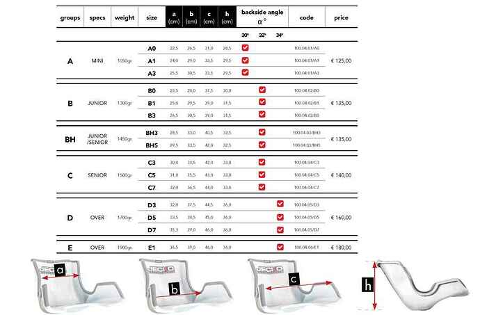

Here in greece they cost 160 euros new .
Maybe worth it to ask them . Iv put their site here
The one watch out would be the 34-degree back. For some purposes it may be too reclined if you were to mount with the flat bottom surface parallel to the frame rails.
