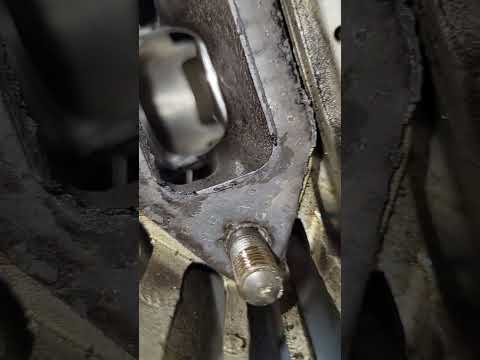

Here’s another video. Crank turns freely with exhaust and plug removed. Not sure how to look into the crankcase. I tried to focus the camera on the cylinder wall, but it wouldn’t focus. I don’t see scoring. Piston moves smoothly.
