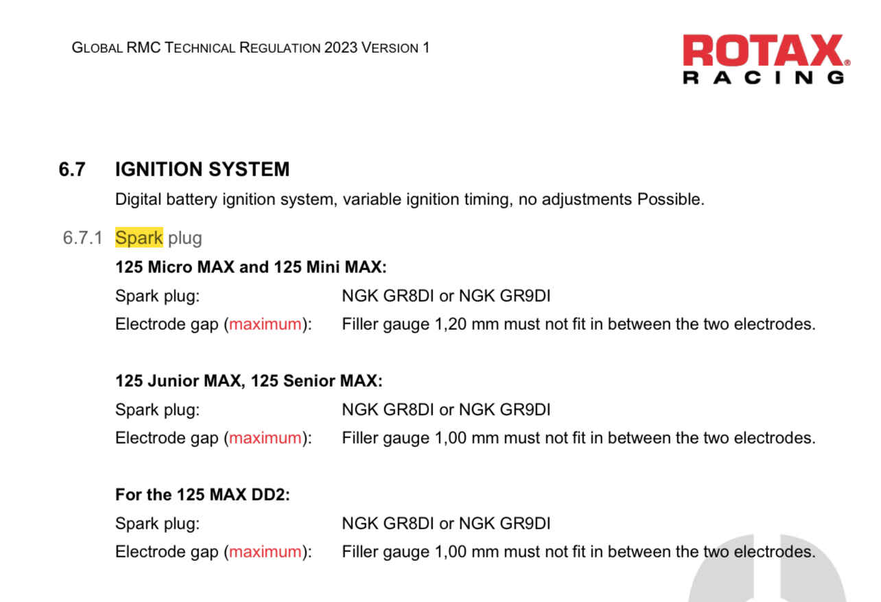

We regular check the gap so its within the rules, they check that here frequently too, as i said we only use the approved Denso ones.
But generaly i do think they last a long time and i cant recall when we have had one fail.
Yes they are very expensive, but mondo sells them for half the price compared to what they are sold for in Sweden :skull:
But in the end 1 R7282 plug was cheaper than what I paid for Br10EG for a whole season of X30😬
Interesting. Rules specifically state NGK spark plugs. Nothing listed for Denso. Are you running the older non EVO motor?

We are allowed to use the Denso IW24-27-29-31 sparkplugs.
Did not know that it was only NGK every where else.
We run the EVO engine, else might as Well stat home😬
