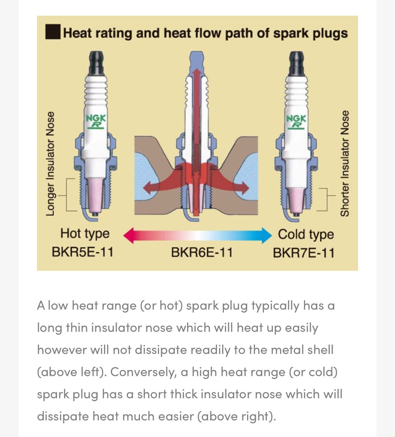

EG is a good series, fine wire which is a plus. I’m surprised the hottest plug is a 10. That’s gotta be a pain in wet conditions. Not much in the way of heat range between 10 and 10.5.

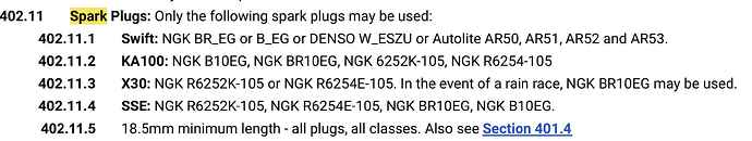

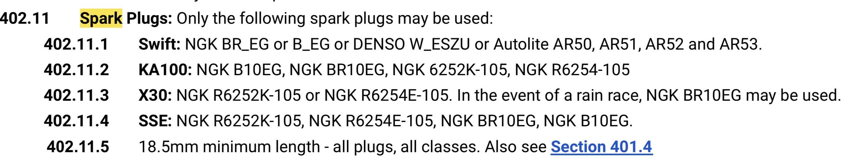

Would be nice, but it’s not allowed in the rules
Sure it is. SKUSA rules only specify the plug model, not the specific part number. So as long as it says “BR10EG” on the side of the plug they don’t care whether it’s a solid plug or screw top.
Unless there’s a supplemental rule on this?
Yup! This is all they state in rules:
My mistake I thought it was a different model of plug. I haven’t come across a solid cap version before. The more you know. Weird it doesn’t look like you can get the non added resistance version.
