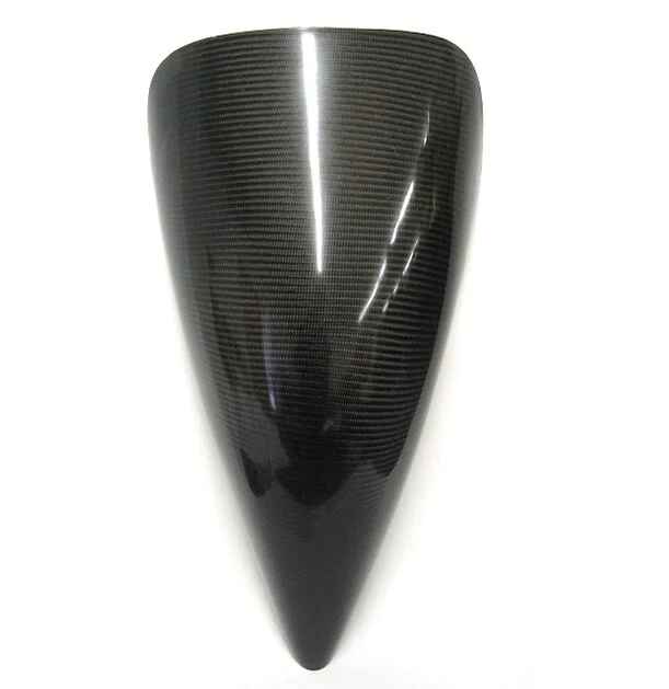

I will say that this fairing from Hegar became the one to have in road racing on CIK karts where allowed. Road racing in the US being what’s called long circuit in Europe, ie karting on car tracks. KZ running average speeds as high as 90 with top speeds in the 115+ region
From memory it was worth 2MPH on the top end without a draft\slipstream. Despite not being CIK legal, it was permitted to be run in place of your CIK nassau but the rest of your bodywork had to be CIK legal.
Linky: Kart road race center fairing [9000] - $265.00 : Zen Cart!, The Art of E-commerce

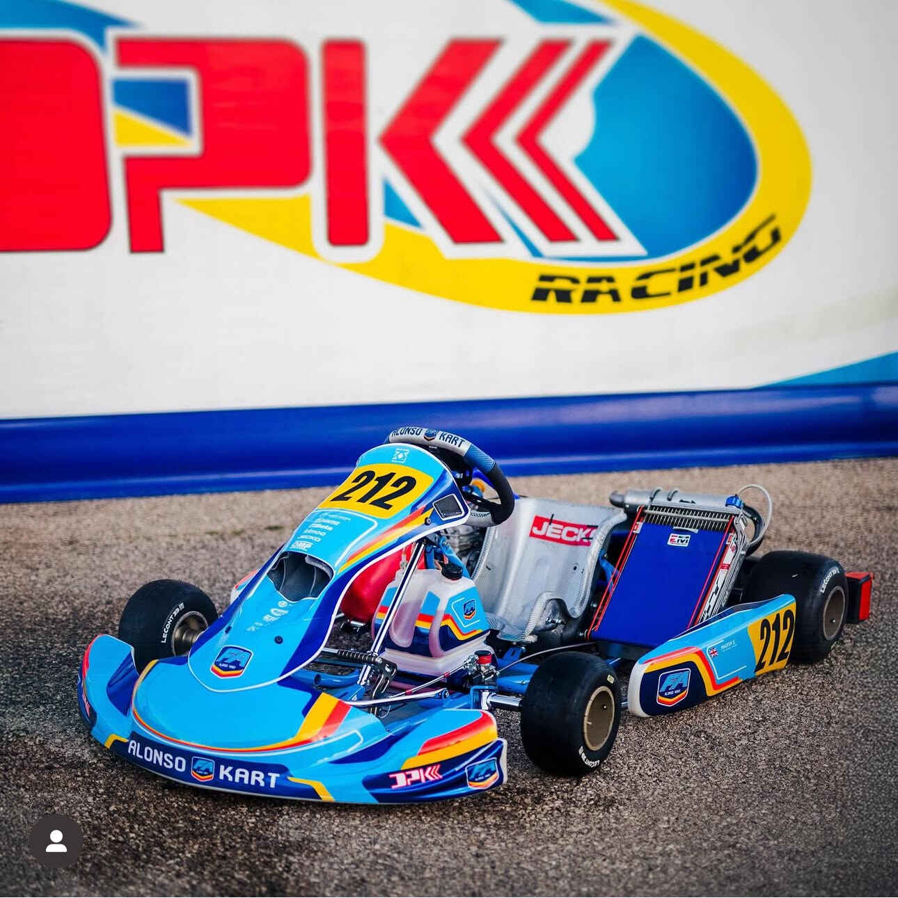

Alright, that’s a thing of beauty.
Livery and color choices is 10/10🙌🏻
Really beautiful kart. The fairing looks very similar to the previous one which I actually liked compared to the other ‘aero’ style fairings.
I plan to buy the new KG when it’s time and go with a P40 flying shark theme. :slight_smile:

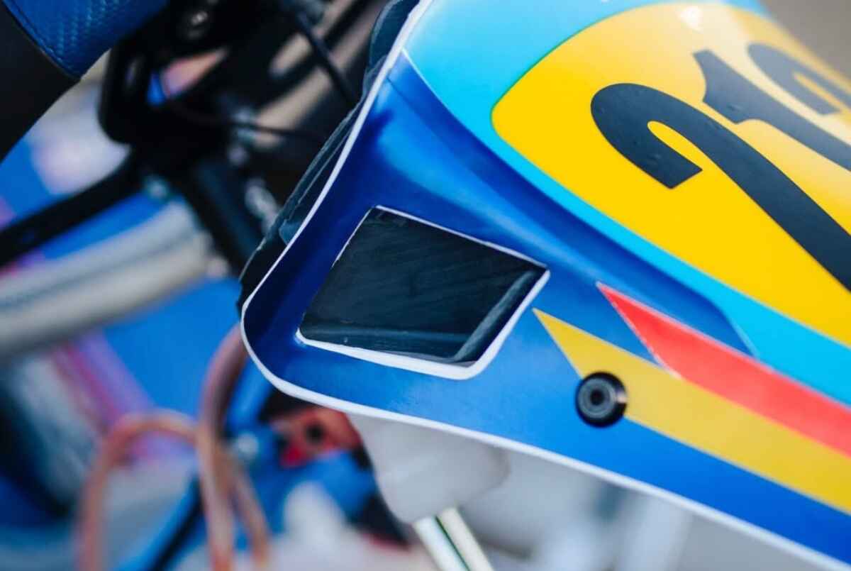

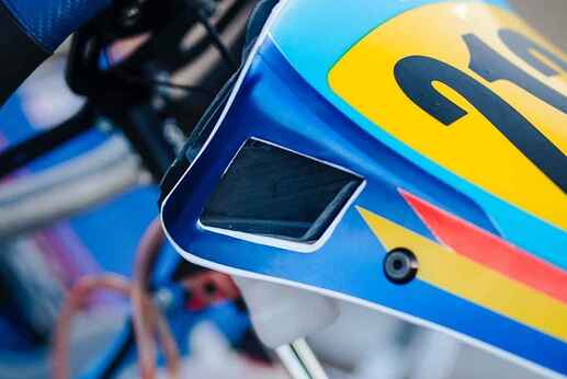

Some closer shots of KR / Alonso Kart’s new aero solutions, kind of reminiscent of F1’s S-duct. Any toughts?
