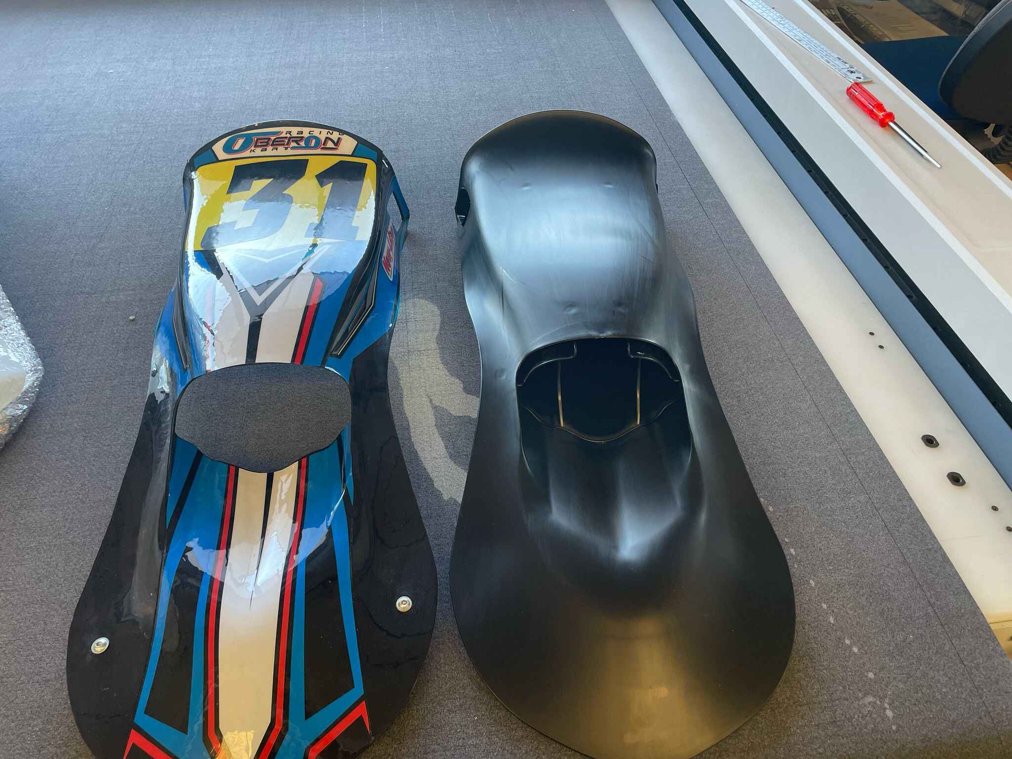

Anecdotally, I have the current “fishmouth” ducting to the driver “overhead.”
While roadracing at daytona, my nose was victim of an “early braker” and it shifted the airflow to my face. The whole rest of the race, I had to listen to what sounded like a Briggs at 7k rpm at volume 11, in addition to the usual kart noises. It was actually louder than most of the other noises. So, turbulent flow, I’m pretty sure. I’m not sure how much the duct was hurting or helping me.
But the noise was so annoying I’ve vowed to do whatever it takes to not have that duct misalign again.
I have that same bodywork, and the idea of ducting up-and-over goes against everything I learned from racing cars. It seems like KR has also drawn this same conclusion with the new bodywork that diverts some laterally. Usually (as in always) you are better off diverting around rather than over because it creates less drag when the flow converges on the backside. I have a tool to determine drag from kart data, so I keep wanting to see what happens when I slap tape over the inlet, but just the power data I gather has enough noise in it to make test results inconclusive. I usually only have about a 1/2 hp certainty which is plenty for gearing and keeping an eye on engine health but not nearly enough accuracy picking out drag effects at 55 mph

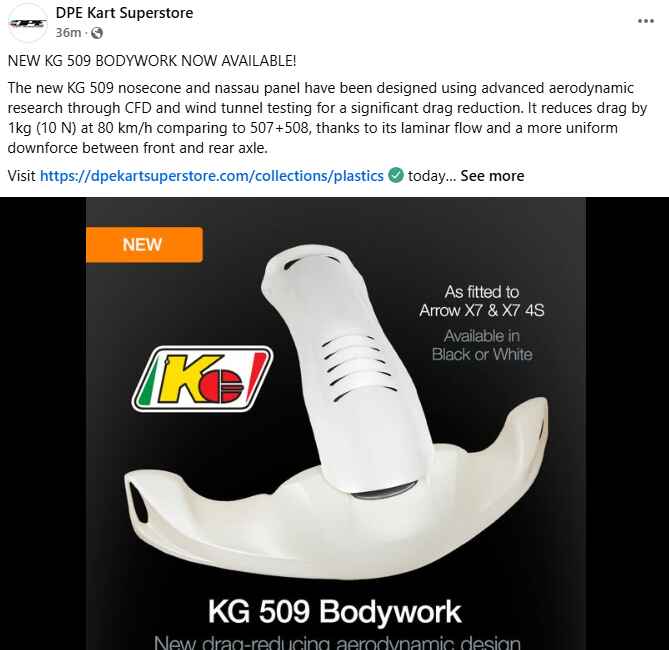

May be interesting to some of the folks in here DPE (makers of Arrow karts) just posted the above with a stated amount of drag reduction on the newer KG nassau and nosecone
would it be worth taping up inlets/outlets of the kg508 nassau to better the flow?
I’m sorta’ curious if the “inlet” was on the underside to evacuate the already low-pressure air if that would help reduce turbulent flow around th footwell. In roadracing the speeds are higher, so aero is more obvious. I’ll try an A/B taped/Untaped test if I get the chance in 2 weeks…
Ted, you are a pretty creative guy. I’m thinking taped and untaped in the same session. Start out with it taped up and rip it off mid way through the session. Straightaway speed or something obvious could be used in road racing to see if there is a measurable difference.

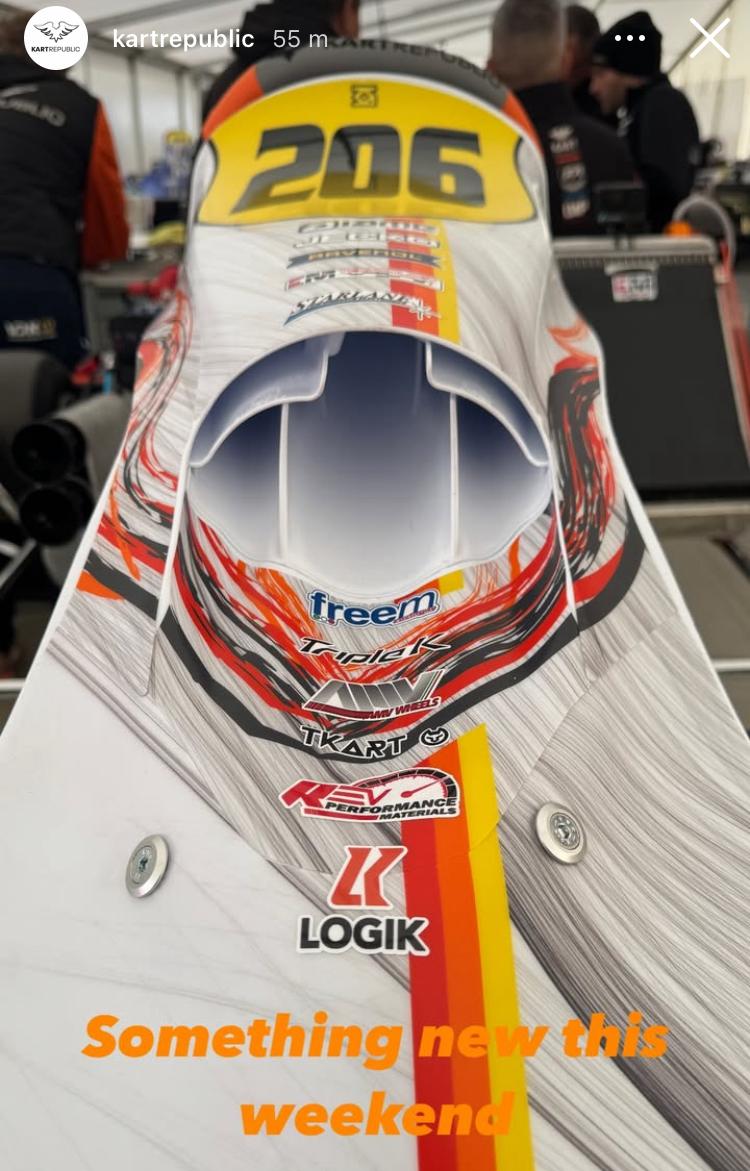

We’ve seen it tested earlier by other KR teams, but it seems like KR Motorsport will run it officially from this weekend’s WSK Super Master Series final @ Franciacorta.
We will run it as well this weekend , we’ll give some feedback.
