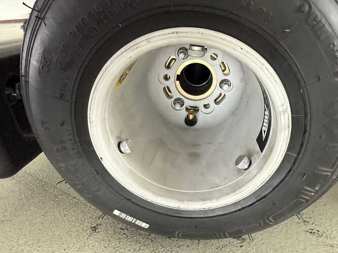

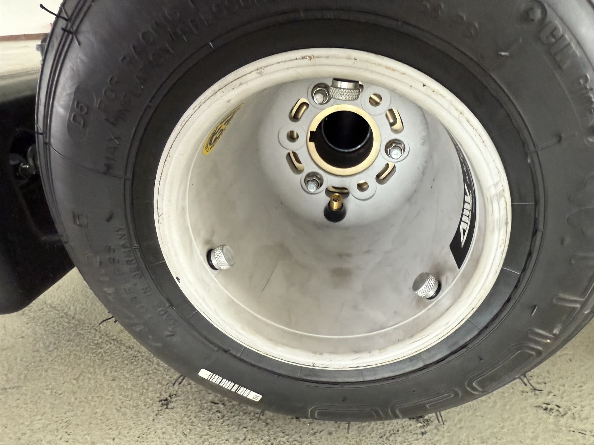

I’ve recently switched from OTK to a Kart Republic KR2 chassis in DD2 class. Still trying to adapt to the platform and learning all the setup options. However, i am having a bit of hard time figuring out the rim option that came with the kart (does not specify on the rim barrel, unsure if its 9F, 6F, 3F).
Been doing some testing days on green & cold track and can not seem to get the tires to melt up properly, felt like the kart doesn’t dig into the pavement too well. I tried different tire pressure and once i ran a little higher, it started sliding sideways but tires still weren’t melting up properly (chewing-gum like). wondering if i should be buying a set of Lynx or Tiger for such conditions?

The KR comes with its own version of 3Fs I believe.
The Lynx wheel has been very popular lately in similar situations where you need the tire to heat up better.
When the track is very cold and low grip, you may not get the tires to really work as they are supposed to, so bumping up the air will help but the trade-off can be that the contact patch gets smaller and the tire stiffens and starts to have a lower limit of grip.
I’ve found KR and its offshoots like axle changes and for me, going to a stiffer axle generally improves side bite in faster corners and a softer axle will make the rear rotate more.
Also raising the rear ride height or seat can help produce side bite too.
However at SuperNats this year many of the KR guys (and I) were really liking the rear ride height lower to help the kart squat and get rear traction on corner exit, so there are multiple ways to approach the issue if you want to tune the chassis.

These wheels are the latest version of 6F the std KR wheel. The slots are to allow for more heat transfer as I understand it.
I would suspect Lynx or Tiger would be a good alternative for DD2. Roll with the wheels you have for a bit though.

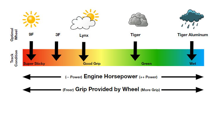

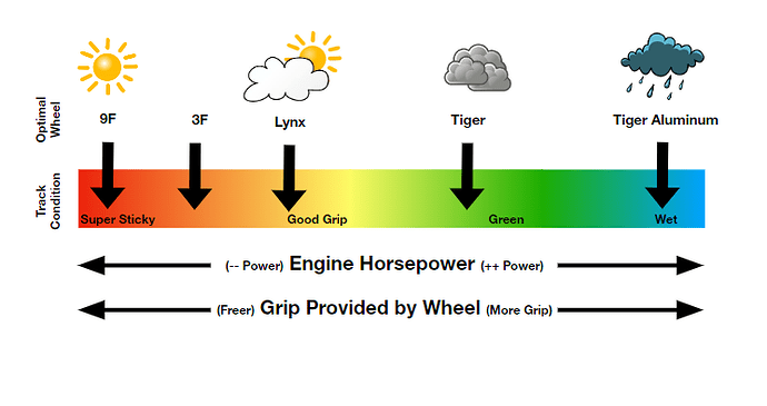

George, did you see this graphic:
My standard wheel is the 3F and I go to the 9F for hot days or national races where more rubber is laid down. The 9F is more free than an MXC.
Yes i saw this on AMV website, but i’ve also seen two different version of this graphic where the Lynx Tiger were placed on opposite end (and Puma was also included), which i find a little confusing. All in all, I think so far from what i’ve gathered, MXJ would be around Lynx & Tiger range, 3F would be around MXC, and 9F would be around MXQ? does it sound about right? Thanks TJ!
That is correct.
I have not updated this chart in a bit. Lynx is closer to Tiger, Puma is to the right of Tiger.
Lynx offers similar levels of grip to Tiger and a different front to rear balance with a bit more grip for the front.
