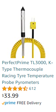

Here’s what I did for a cheap and simple method to measure and record tire temps. I bought the probe below off Amazon for $34. At the end of the session, I would plug in the temp probe into the ebox temp channel (needs a round to flat connector adapter cable). Measure the 3 tire temps and use a silver marking pen to scribble the temps on the side of the tire. If you need a separate display, Amazon has really cheap DVMs with a K type thermistor input.
