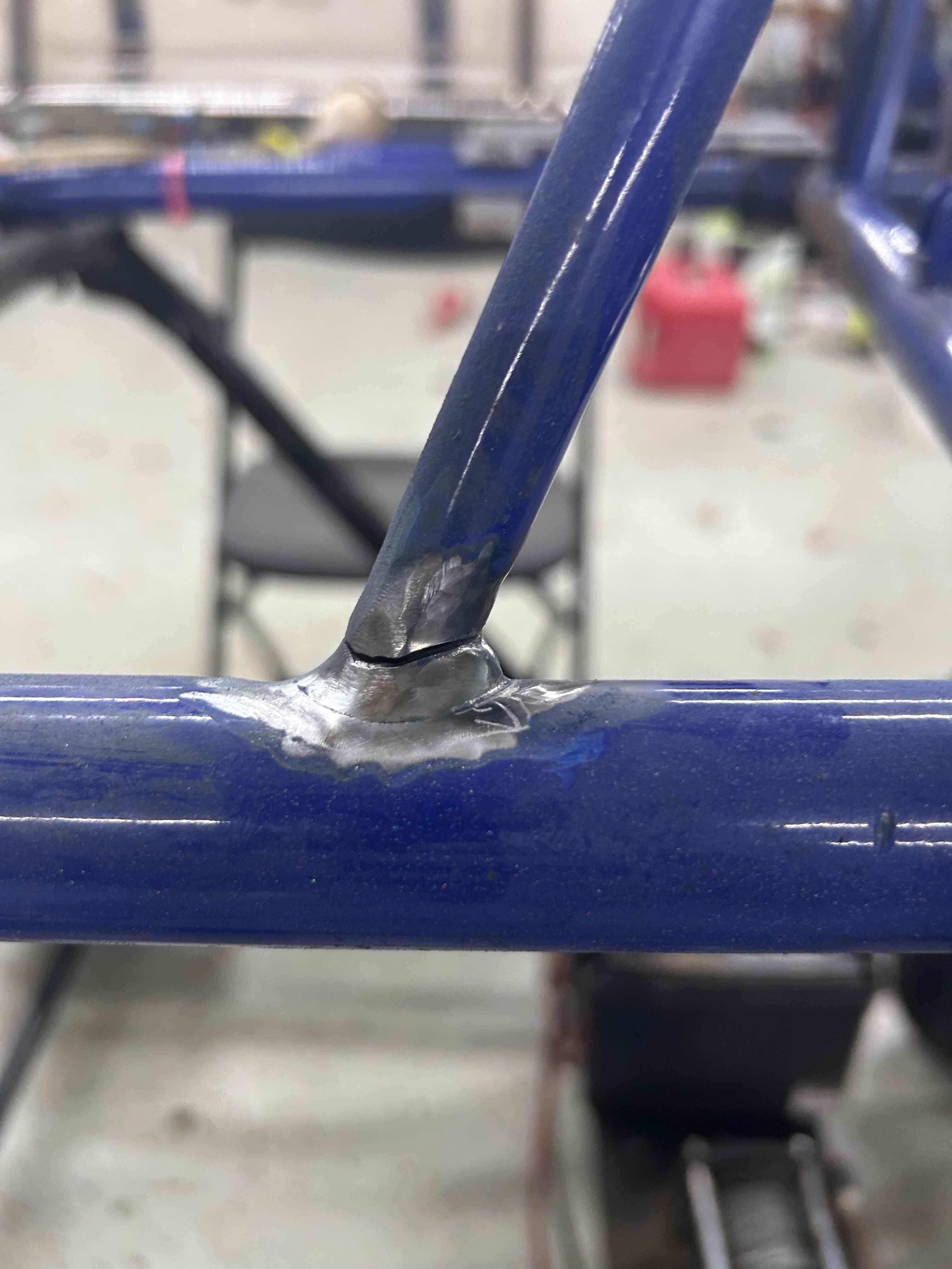

Anyone else seeing poor welds on their kart frame?

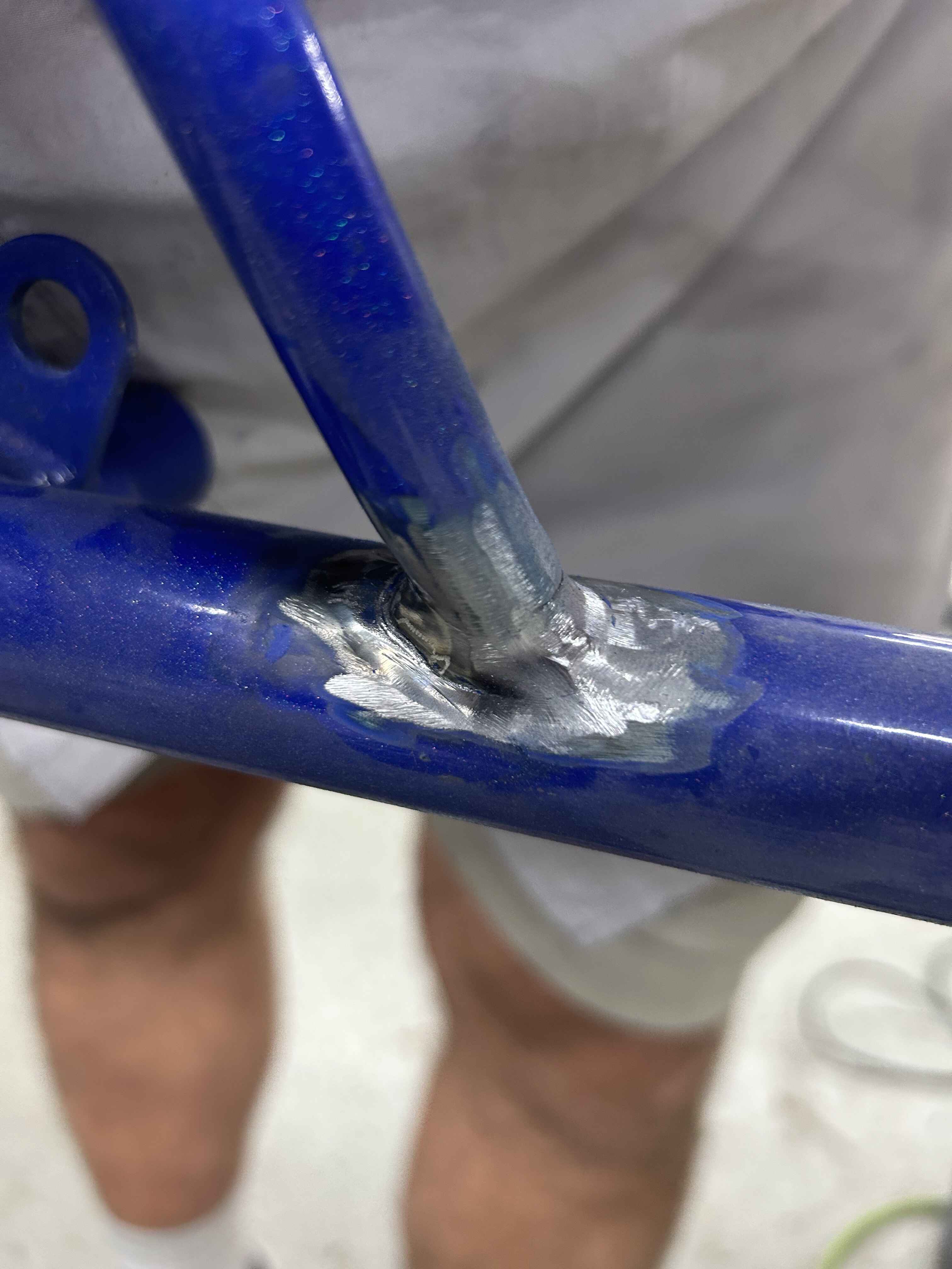

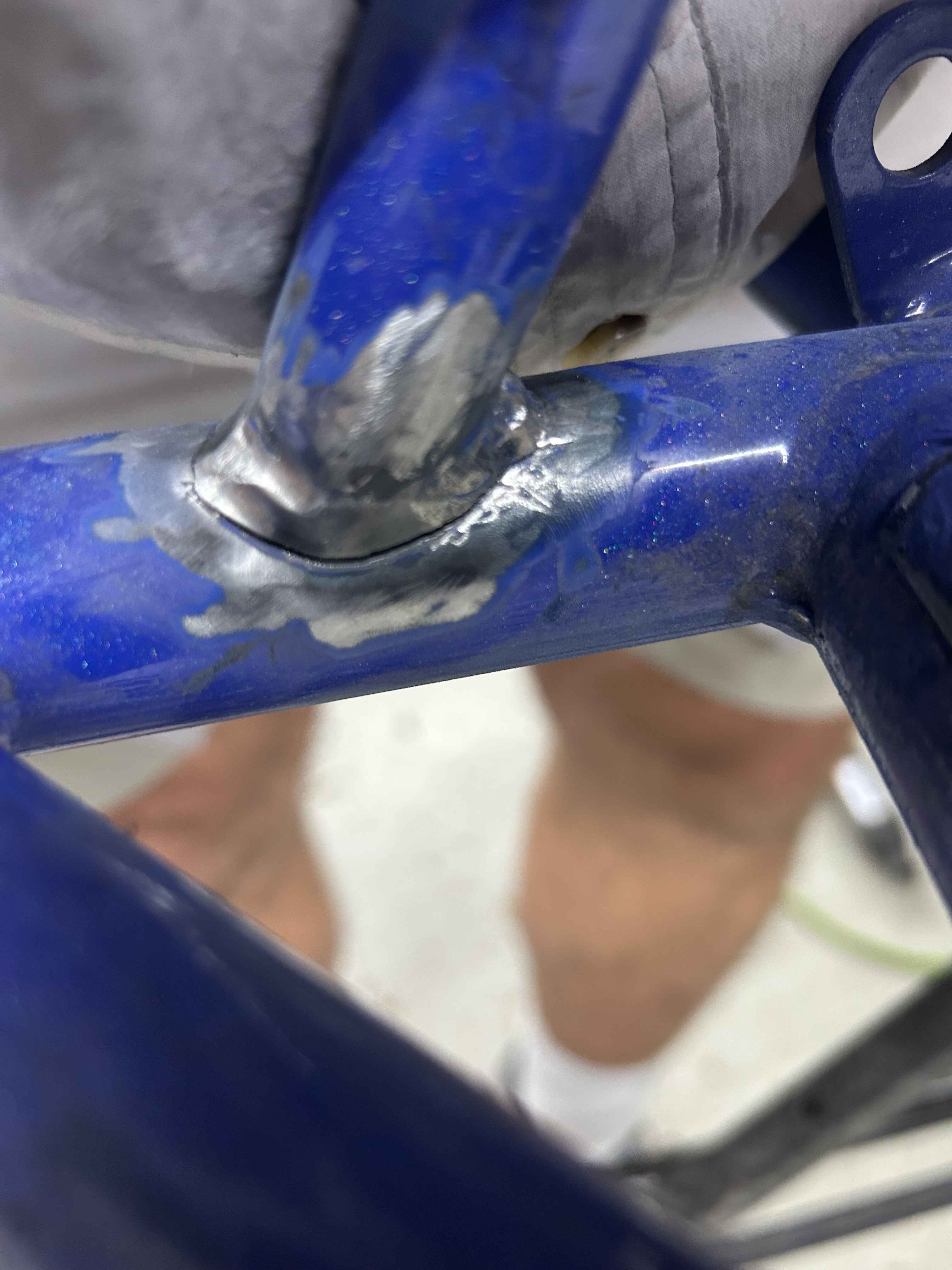

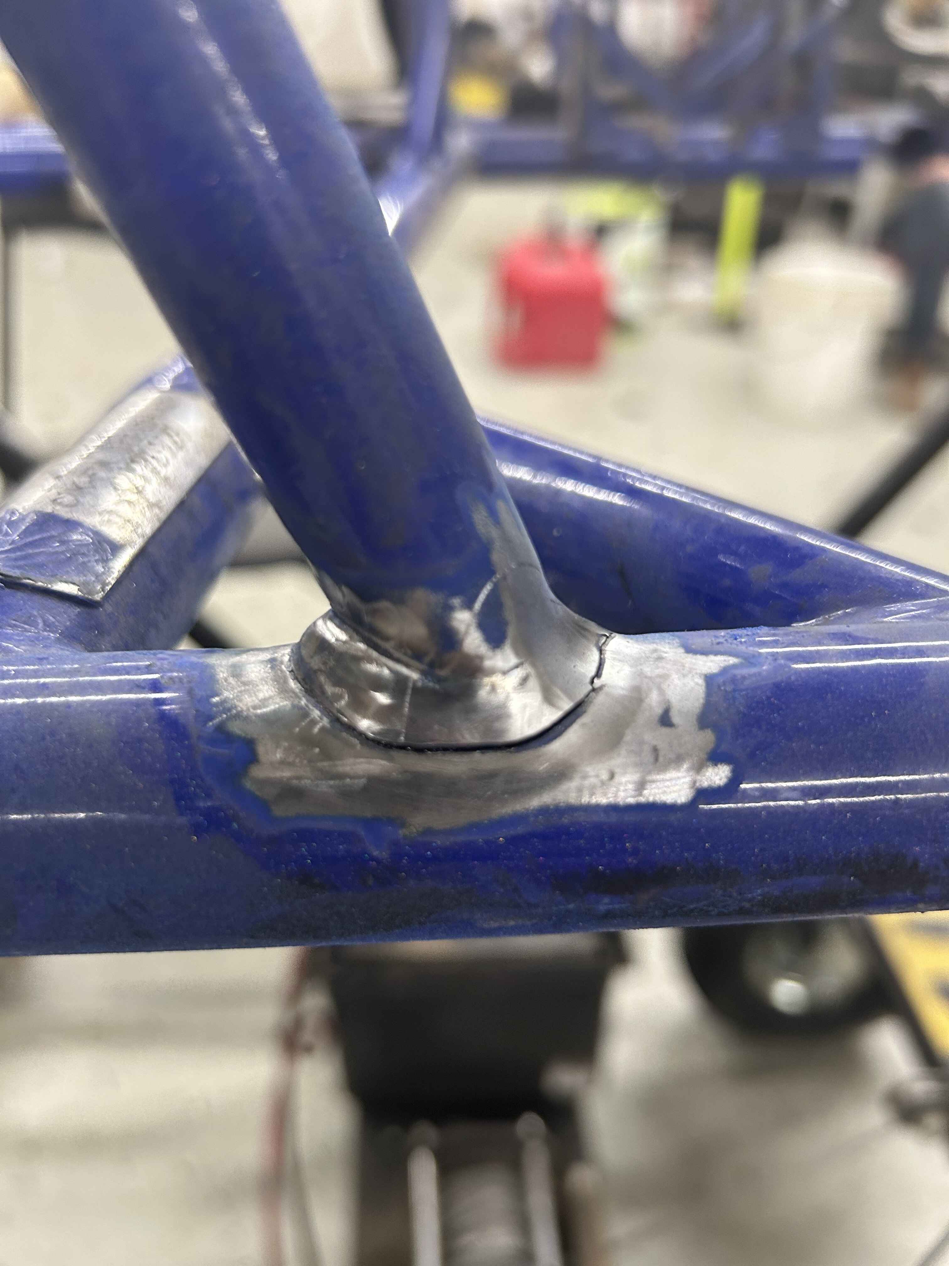

Had both left side seat posts break this weekend on my sons kart. Got paint cleaned up tonight and both welds failed in the HAZ indicating poor temperature control or PWHT on the chrome moly tubing. For a frame that costs 2500 the Italians should do better…
This frame was purchased in March/April after totaling the previous frame in a wreck, so it isn’t old and tired.
Going to Tig it out tomorrow and wrap the welds. If I am not happy with the cooldown I will heat it with a small torch and wrap it to stress relieve the weld.
I’ve always been confused why they couldn’t just put some thicker base at those pressure points, considering those always crack on you.
Is this just an OTK thing? This is where I would crack my compkart, too.
This set of cracks isn’t a load issue, it is a weld quality issue. The location of the cracks indicates localized weld stresses that were not relieved. This is something that just shouldn’t ever be allowed to happen on chrome moly welds. Too much heat input when welded (look at the very large weld beads) combined with rapid cooldown and no PWHT. If that weld had been PWHT it wouldn’t crack right in the HAZ. The location of both support cracks tells the story…right at the toe of the weld in the HAZ where the weld and base metal meet. It is a weld process or weld control failure, not too much stress or too small of a support. If done correctly, those tubes should fatigue and tear in the base metal away from the weld when overloaded.
