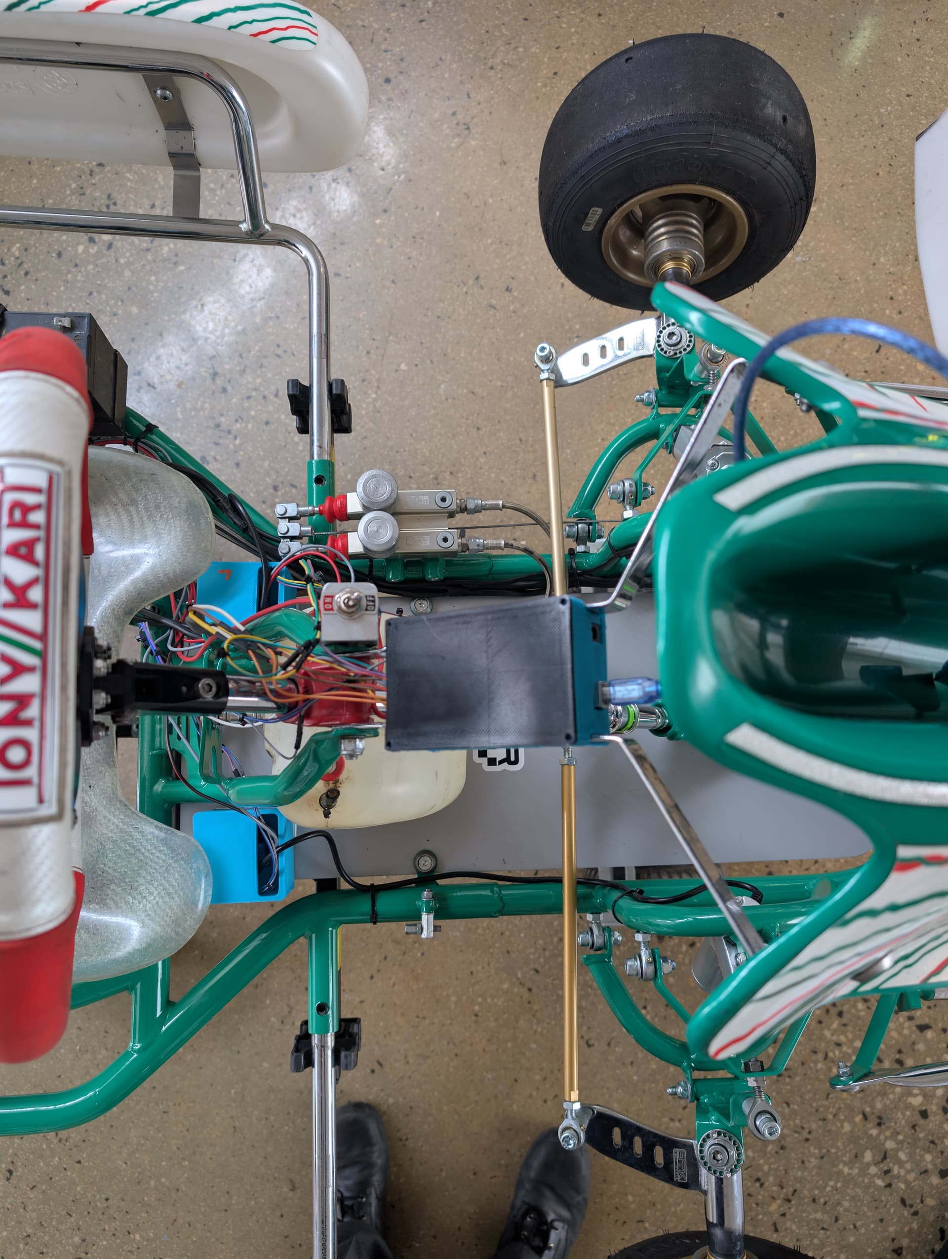

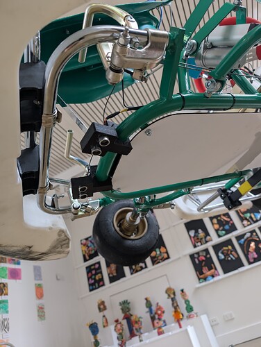

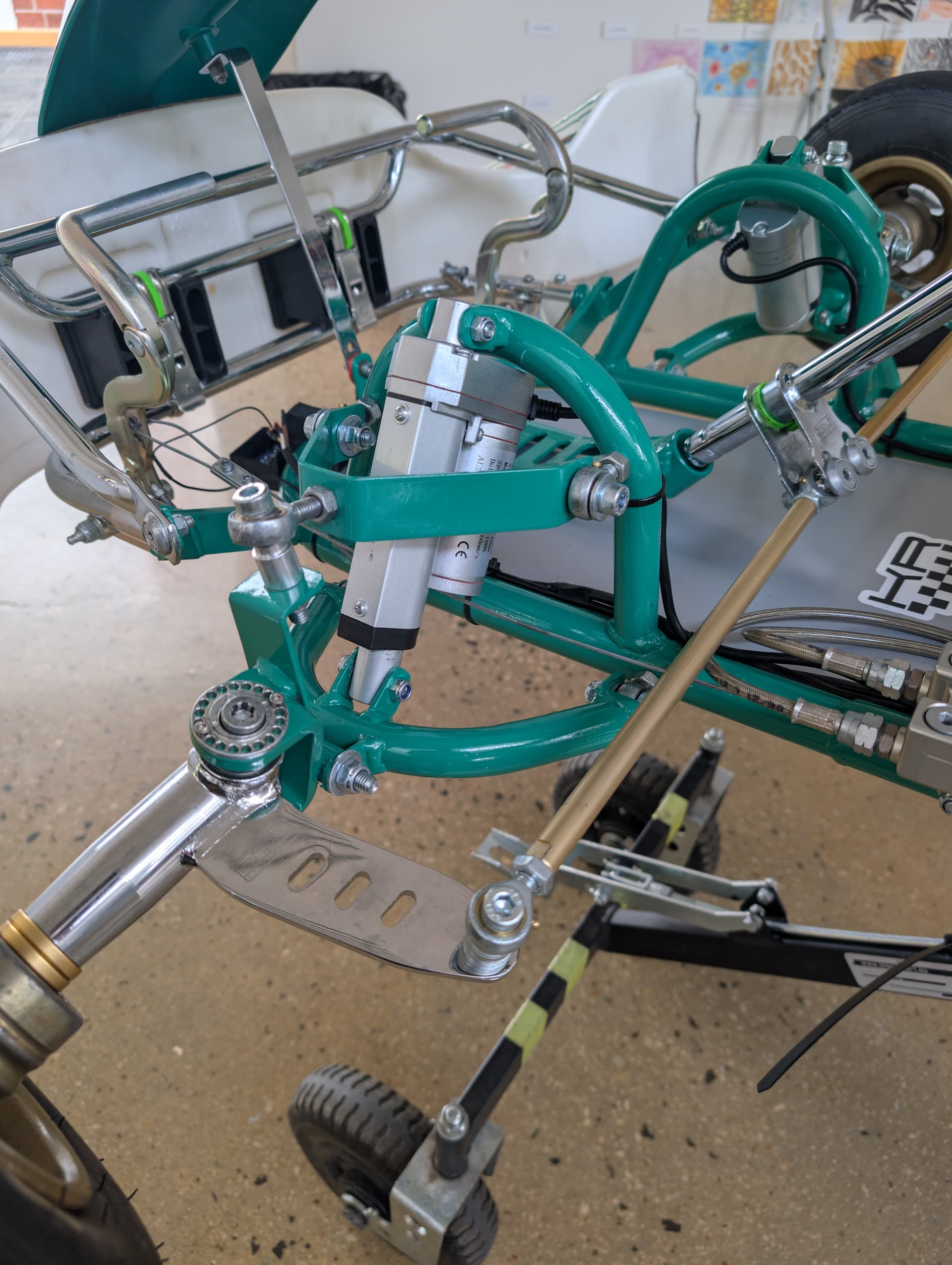

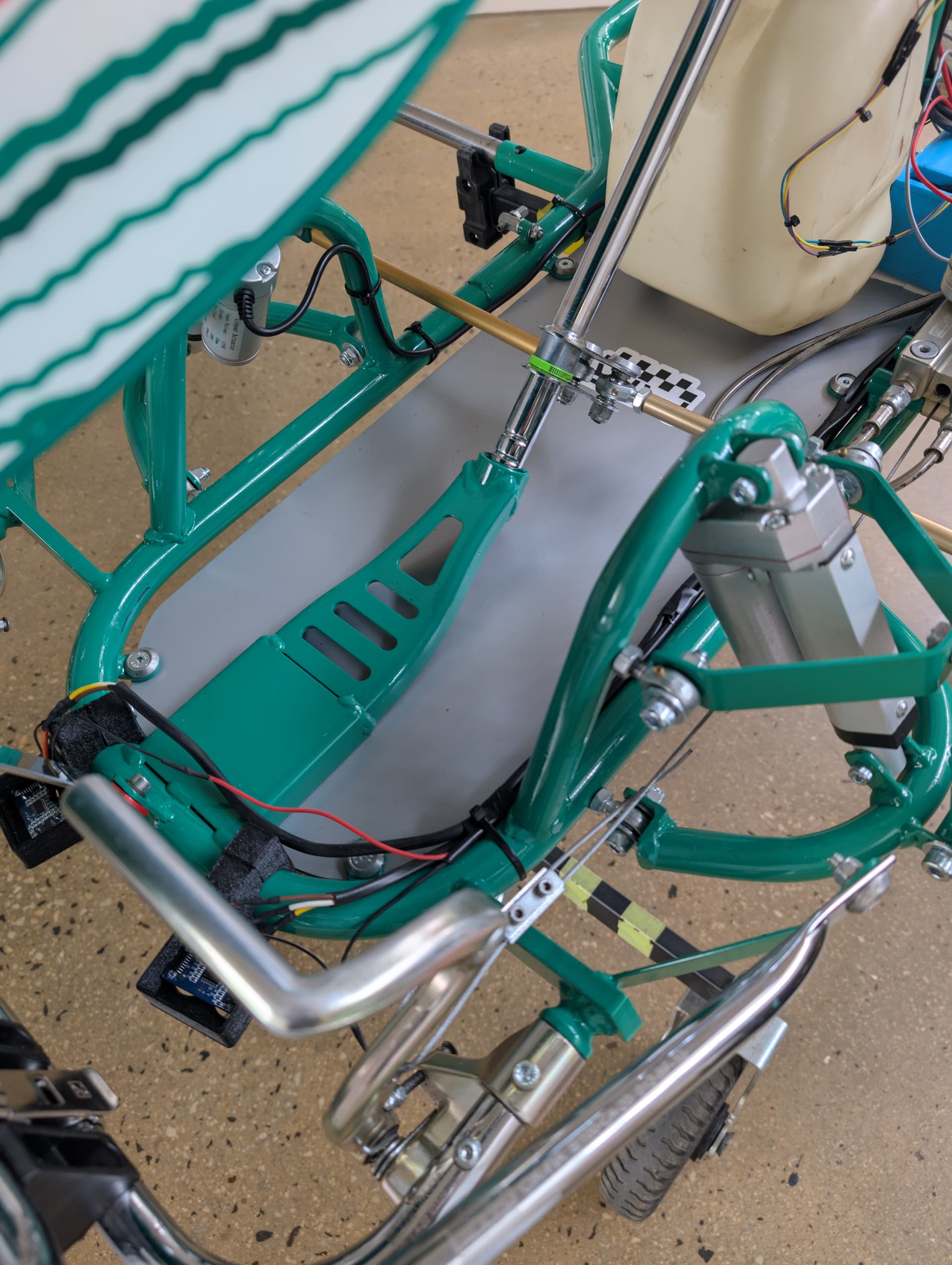

Gday!
Dom here, thought it would be cool to show you guys a project I have been working on for my final year of secondary school in Australia. The idea behind this was to effectively keep ride height at a constant during driving. The build was completed mainly as a display of the concept and is yet to hit the track. However I do have plans to get the kart out to a track one day. I am aware that it goes against a vast majority of technical regulations, but I thought it would be a cool project to achieve and demonstrate an interesting concept! Hope that it prompts interest and you people enjoy it!
Parts list:
2x L298N motor drivers
2x HC SR04 US Sensors
2x Linear Actuators @50mm stroke
1x Arduino mega
12V Battery
+Custom design and fabrication
Please feel free to ask questions or any suggestions for future evolutions!
Cheers! :call_me_hand:

I see linear actuators. How do you plan on absorbing bumps?
It’s a motion sim rig for real life!
Good quality work…not sure I understand your theory of operation…?
Are you trying to prevent chassis twist, or trying to keep the ‘lower’ rail in the twist a constant height from the track? Or something else?
