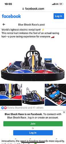

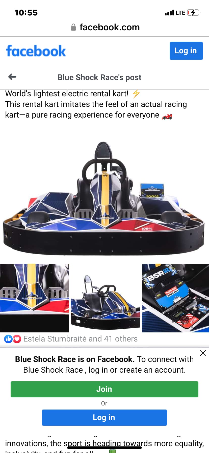

Id like to race electrics a bit. It has potential and these rental karts could be very quick. Iirc I saw a lightweight (with bumpers) sort of race-rental that would be dope.
Hard to argue with CRG look. Cool wheel.
Now this looks legit:
Blue Shock Racing is a Latvian company. I can’t get their page to load this am.
