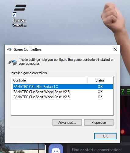

You do have to create a profile each time the game data gets wiped. Like you said, Generic Wheel Profile and bind the keys. In my case, it recognizes the pedals and the base no problem. Sometimes the pedals dont take and need a couple tries.

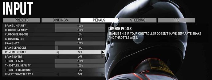

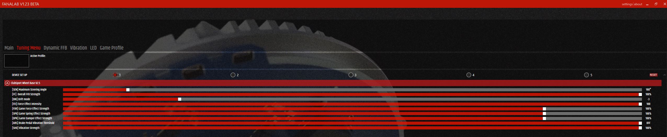

Here is how I have my settings:

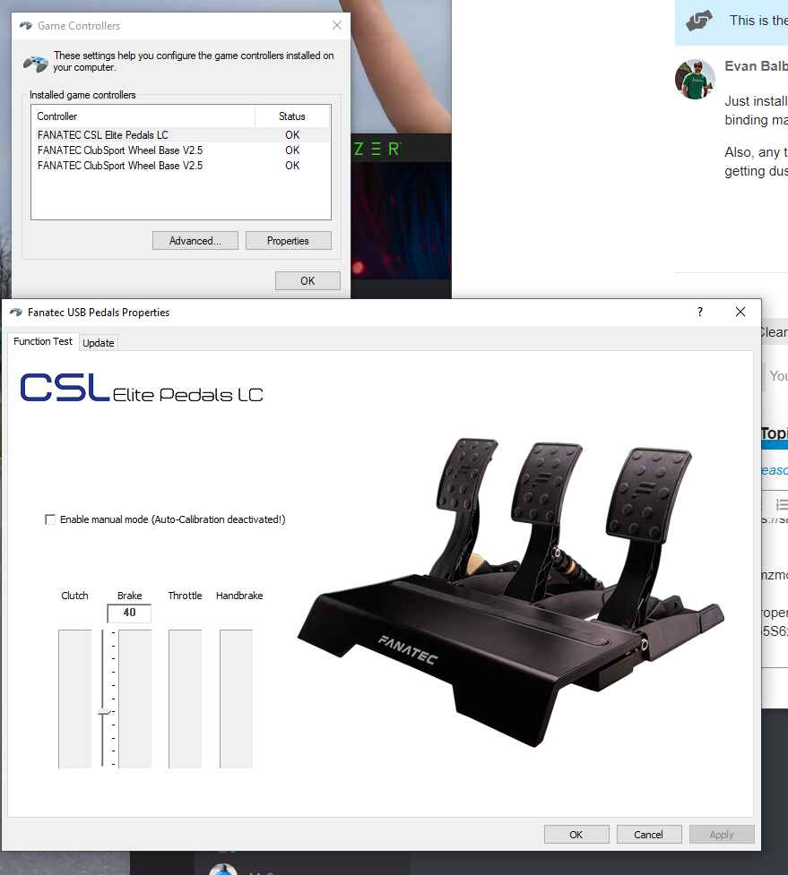

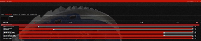

There’s a thing called fanatec wheel property page:
Does the pedal behave normally in here?

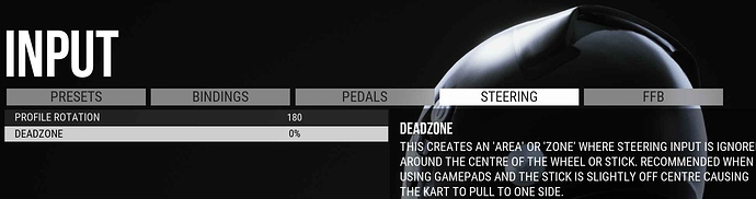

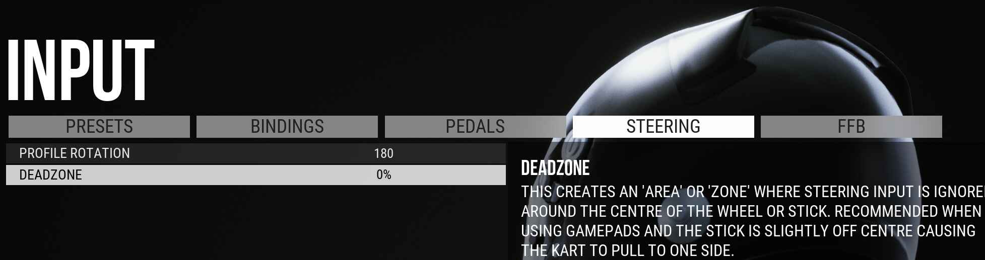

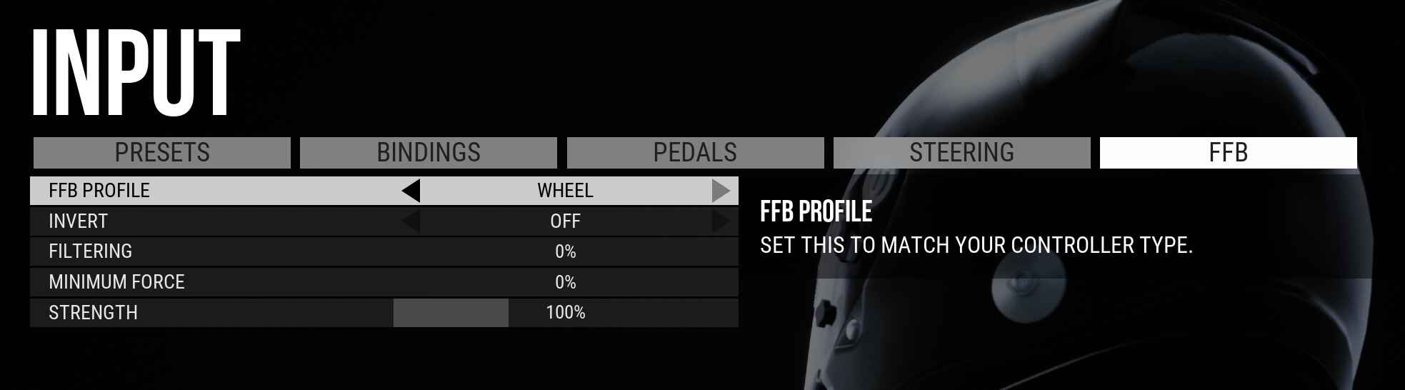

Settings in Inputs: Prefernces

I’ll look at your settings and update mine, thanks

I reset the max and min on my pedals. Noticed there was some fluttering which apparently happens with Fanatec pedals, so I reset my min having some light pressure on the brake pedal and it’s all fixed.

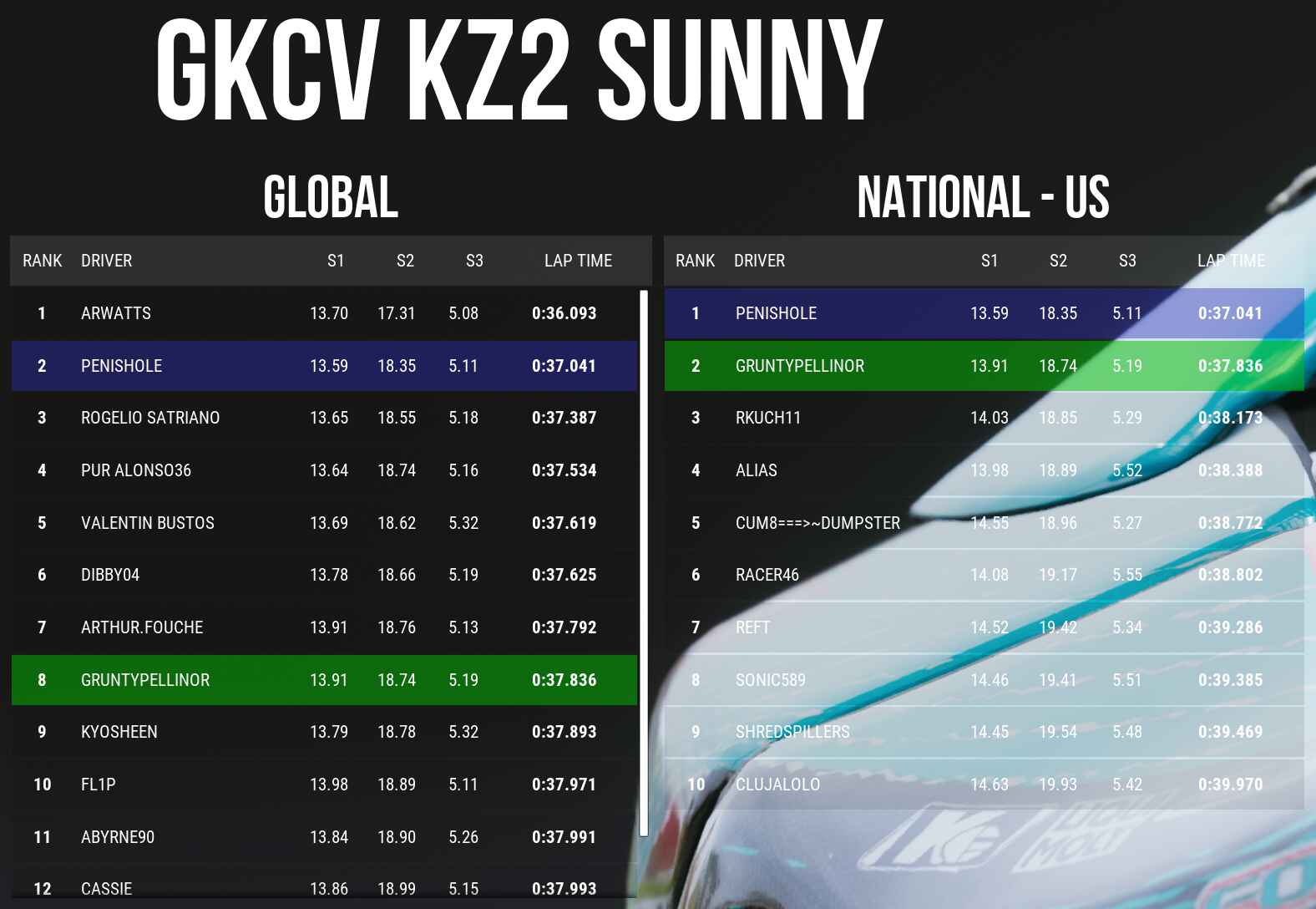

I am trying to see if I can get close the the amazing (and oddly named) Penishole. He’s a guy I met at OKC who works there and used to race shifter IRL competetively. He’s way better than me in shifter but maybe I can get close. Top 5 would be nice. #1 time is likely some sort of cut or glitch.
