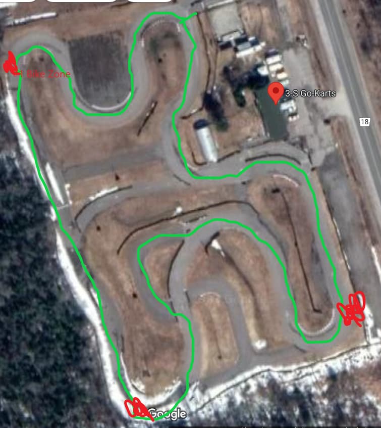

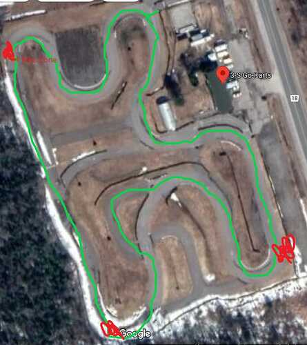

First 2 sessions into Friday practice had 1 Senior and another Cadet upside down. Bicycling all over the place. I will look for a recent satellite pic but there are a series of thick, sticky patches in some corners which need special attention.
Even into finals on Sunday there was debate amongst mechanics: kids who were .3 faster in their fastest laps were also up on 2 wheels and ruining laps just as often.
We found:
  • Drive around it. In fact if you hit the kerb before just right it would slam you down at the moment the inside wanted to lift and gave a great launch down the straight.
  • Wide rear
  • Way high tire pressures
  • Mid-narrow front
  • 1 notch neg caster. More made cycling worse.
Thanks for the advice and welcome more!
Message me privaty with hints for Flamboro…never been there and thats next!
Red scribbles are bicycle zones…
