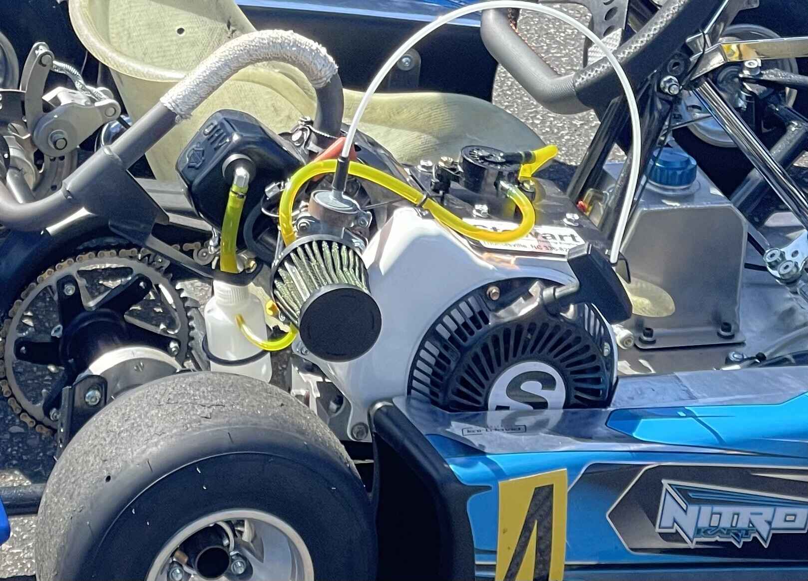

Does the side pod have to be trimmed to fit? It’s like photos of these karts don’t exist…
Maybe this?
That looks like it’s definitely in trim the side pod territory.
I’m trying to find pictures of how the LO206 fits in the chassis. I’ve had some luck looking at for sale ads.
  1. Looks like the clutch is flipped on most with the sprocket on the inside.
  2. Side pods look cut out for engine clearance.
  3. Fuel tank is the above mailbox style or an aluminum tank from lucky 7 power sports.
Yes to all those points.
