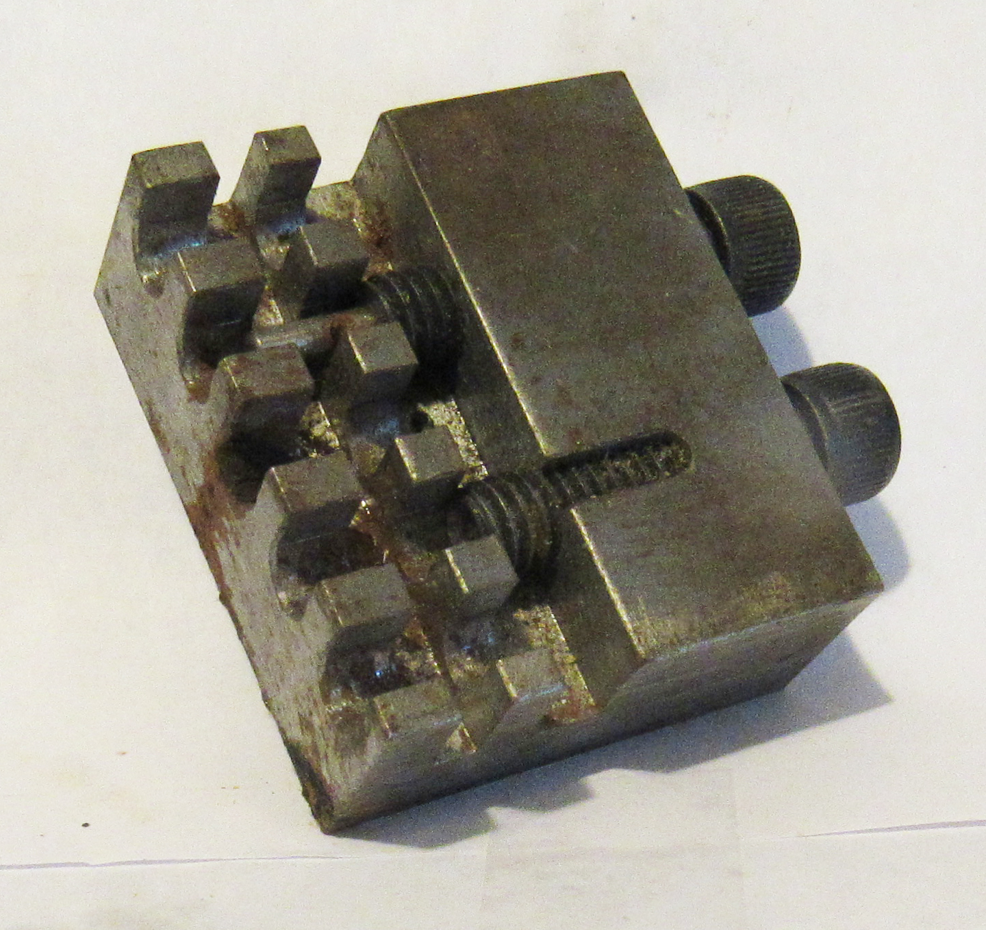

This is a old post but I have the answer for getting your chains to the right length, and with relative ease. This is for 35 space chain but there are people making 219 chain breakers of the same design. I invented this chain breaker in about 1973, so it’s now 45 years later and nobody’s discovered any better way of doing it. I’ve had some impact on karting it seems.
Thats neat Al. I have used your invention it seems.
I’ve used it too… in Europe. I’m surprised a similar concept didn’t stem from motorcycles or other chain applications prior.
I know what you’re saying, and I did fabricate some of those chain breakers for 45 chain. I gave one to a friend of mine, he loved it, had all kinds of praise for, never sold another one.
