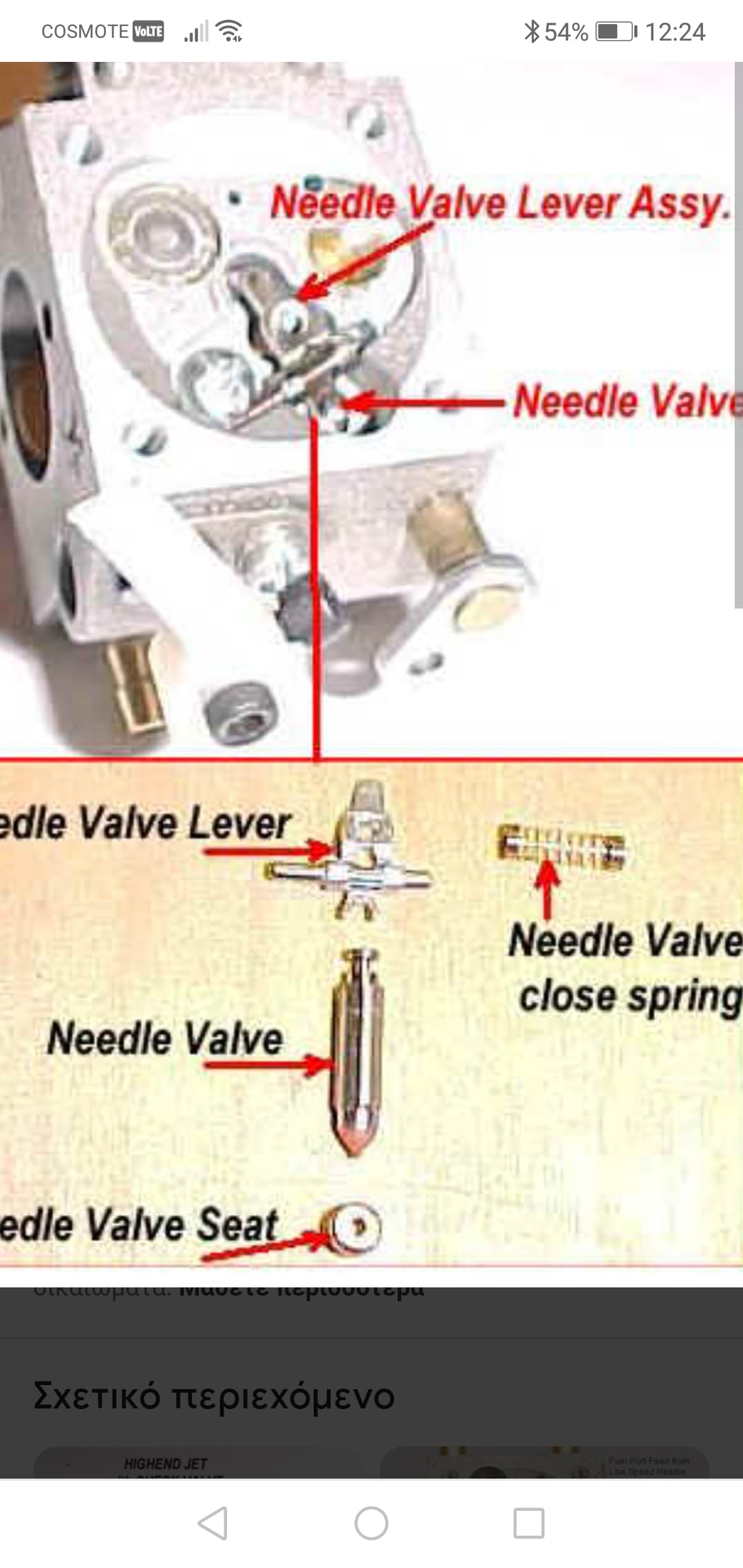

The inlet needle in the carb couple be stuck slightly open too. Did you check it and/or clean it when you replaced the diaphragms?
I did not. Which one is that?. Sorry little bit new to these carburetors.
Hope that help you find the Inlet needle
Yes. Its all been cleaned and diaphragms replaced. I have good spark. It just wont fire up. Its getting fuel. It dripping out exhaust port the more i try. Soooo. Im stumped. Would piston rings have any impact on this situation?. Thanks
