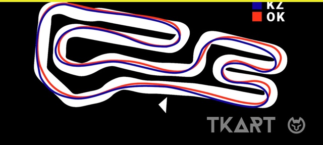

Is this KartKraft? The track map is South Garda which isnāt available in KK only Kart Racing Pro.
The track map is South Garda from TKart magazine. Dom plays KartKraft, but heās just showing the map as a comparison between the two lines.
