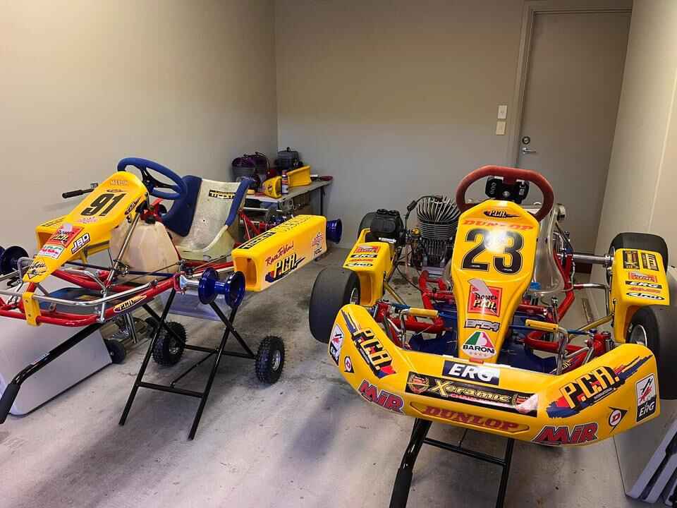

I run the kg airbox and pump 98 Ron fuel
Sexy😍
Is that a PCR Jaguar in the background??
I’ve got a Firefox And jaguar

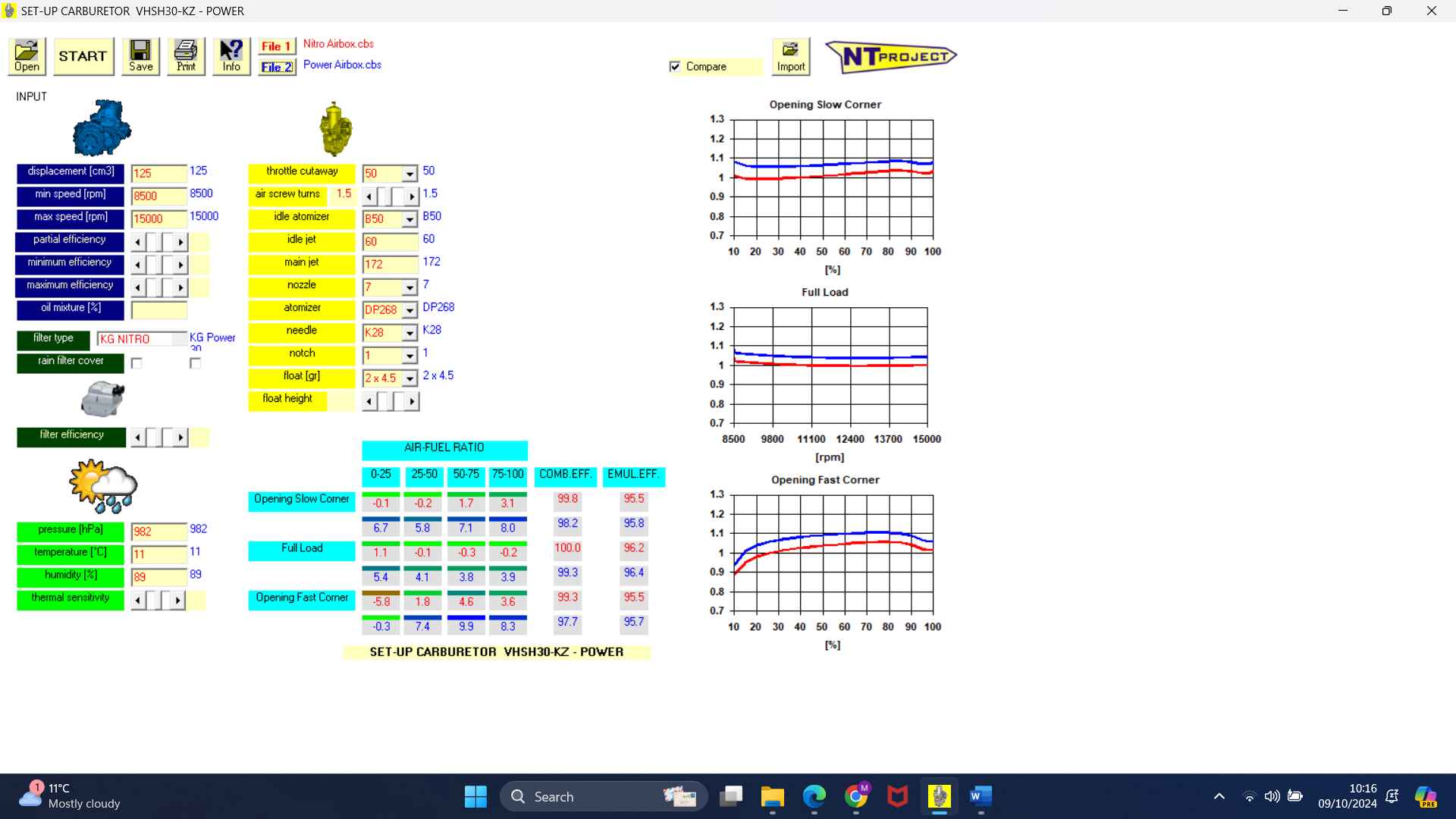

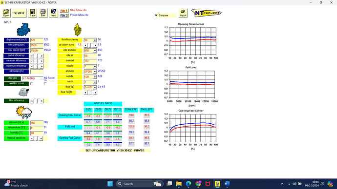

There’s a comparison of the nitro (Red Line) and the power airbox (Blue Line).
According to the software the power airbox leaves the engine running leaner in comparison to the nitro on the same jetting.
If you look at the graphs on the right, the idea is to get the lines as close as possible to the 1 line.
Also have a look at the air fuel ratio calcs on the bottom. The green signifes optimum jetting, blue is running lean.
I just made the switch from the nitro to the power, had to go one leaner on the idle jet and one rich on the main to get my min and max EGTs back to the sweet spot. The power box feels faster, but I can’t really see anything in my data backing that up.
