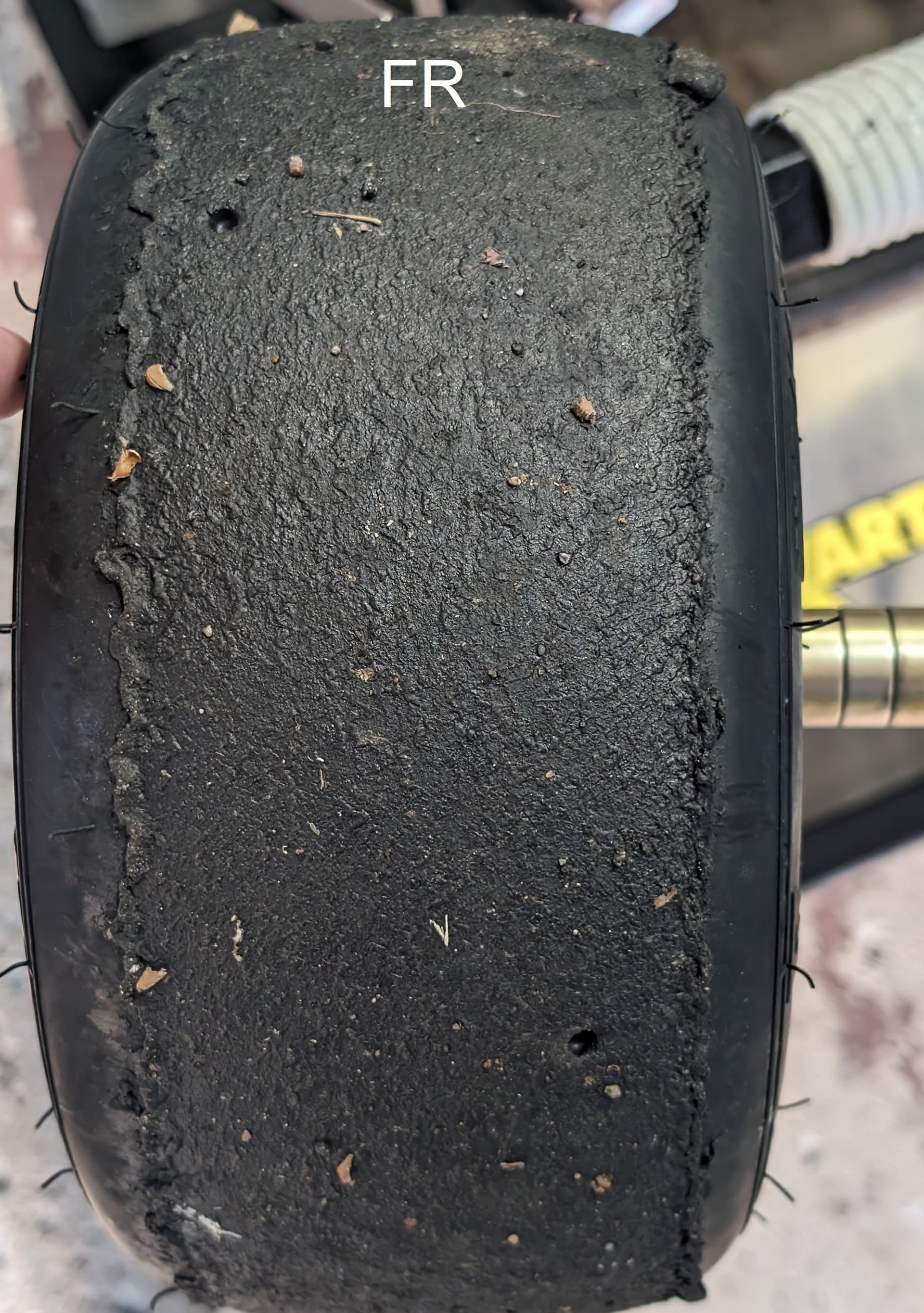

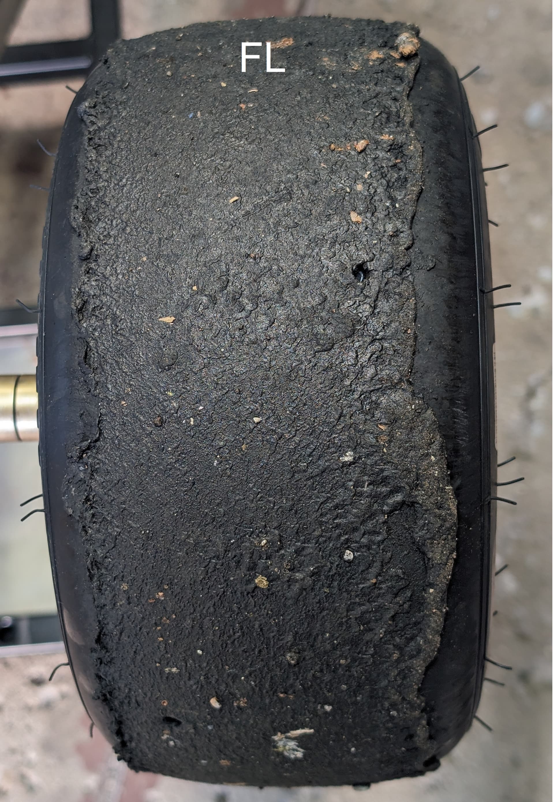

Struggling with front grip on a 2021 OTK Cadet running LO206 Jr. Sportsman. 265lbs min weight with green slide.
Started with factory recommended settings and been making changes to try and improve.

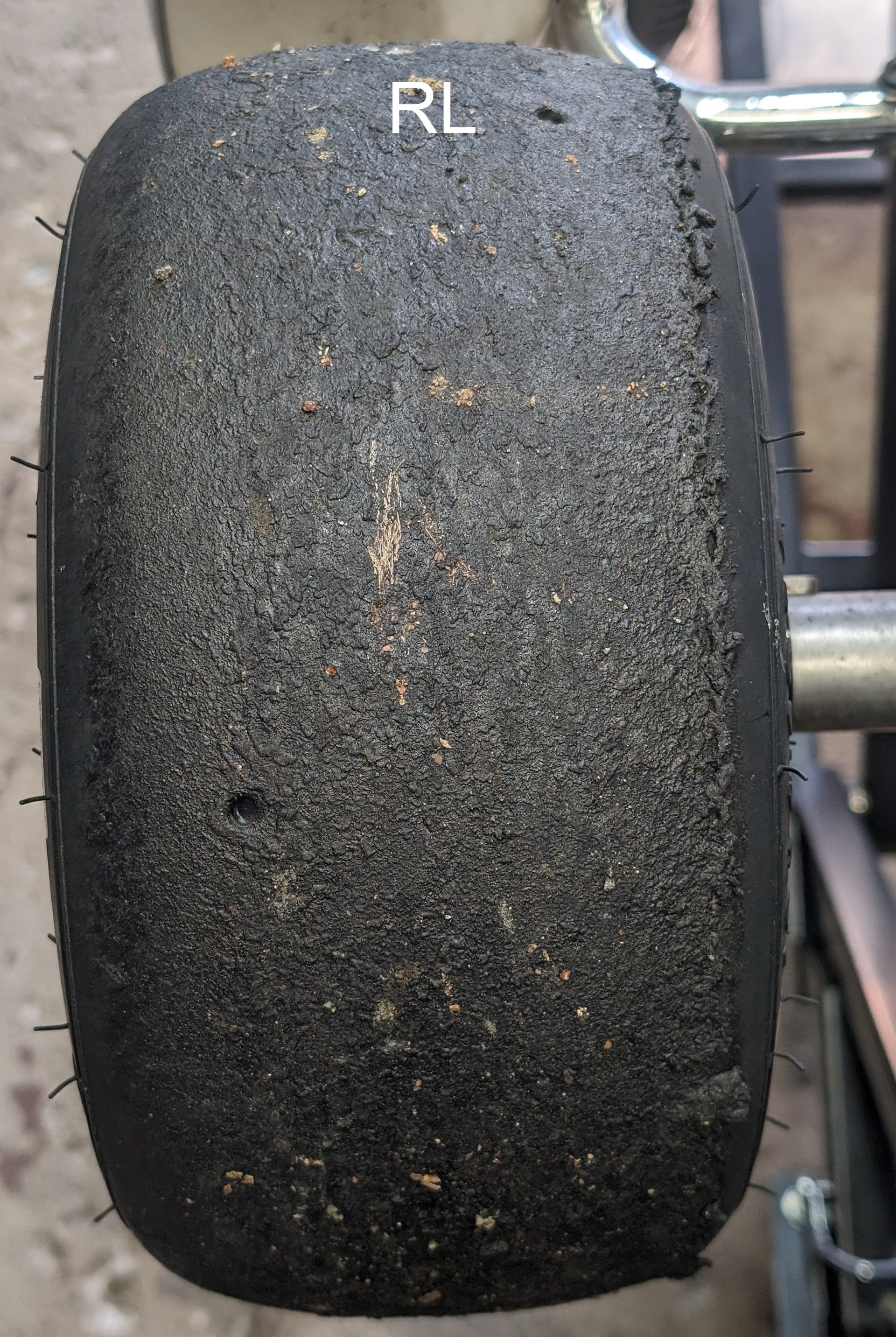

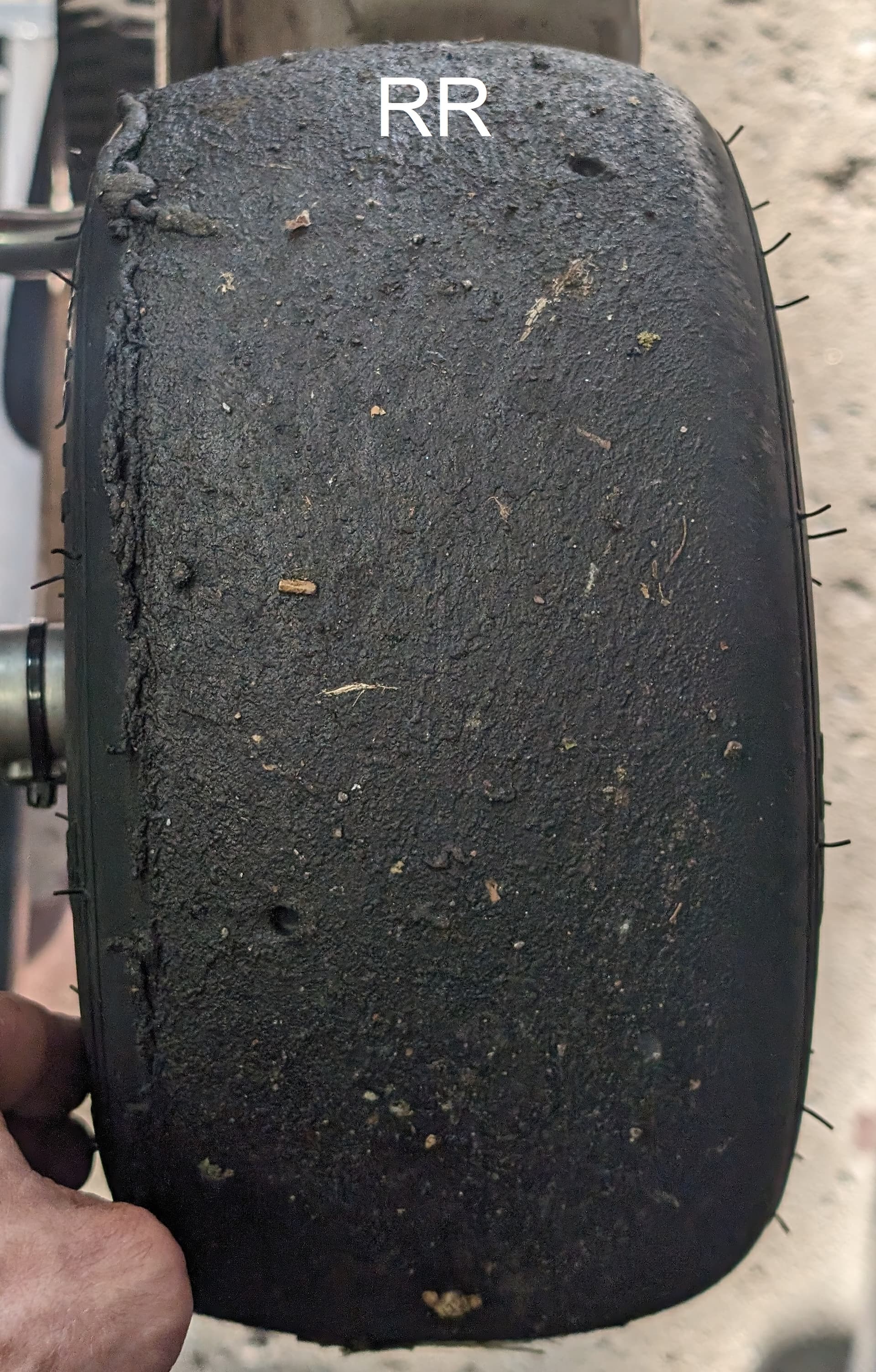

Looking for advice. The front tire wear looks much different than the rear tire wear. We always seem to have what looks like pickup on the fronts but not on the rears.
2021 OTK Cadet
MG Red SH2
13.5 - 15 psi cold
14.5 - 17 psi hot
40mm spacing inside each front wheel
max castor added
0 deg camber
0.5 deg total toe out
1000mm PKT stiff axle with hubs full width
middle ride height front and rear
The front tires don’t show understeer (longitudinal graining pattern), but the build-up on the edge is likely front excess caster. Pick-up like that is usually from the tire heating up but not scrubbing and cleaning off. If the fronts are picking up rubber and the rears look fairly clean, that would indicate oversteer to me, not understeer.
