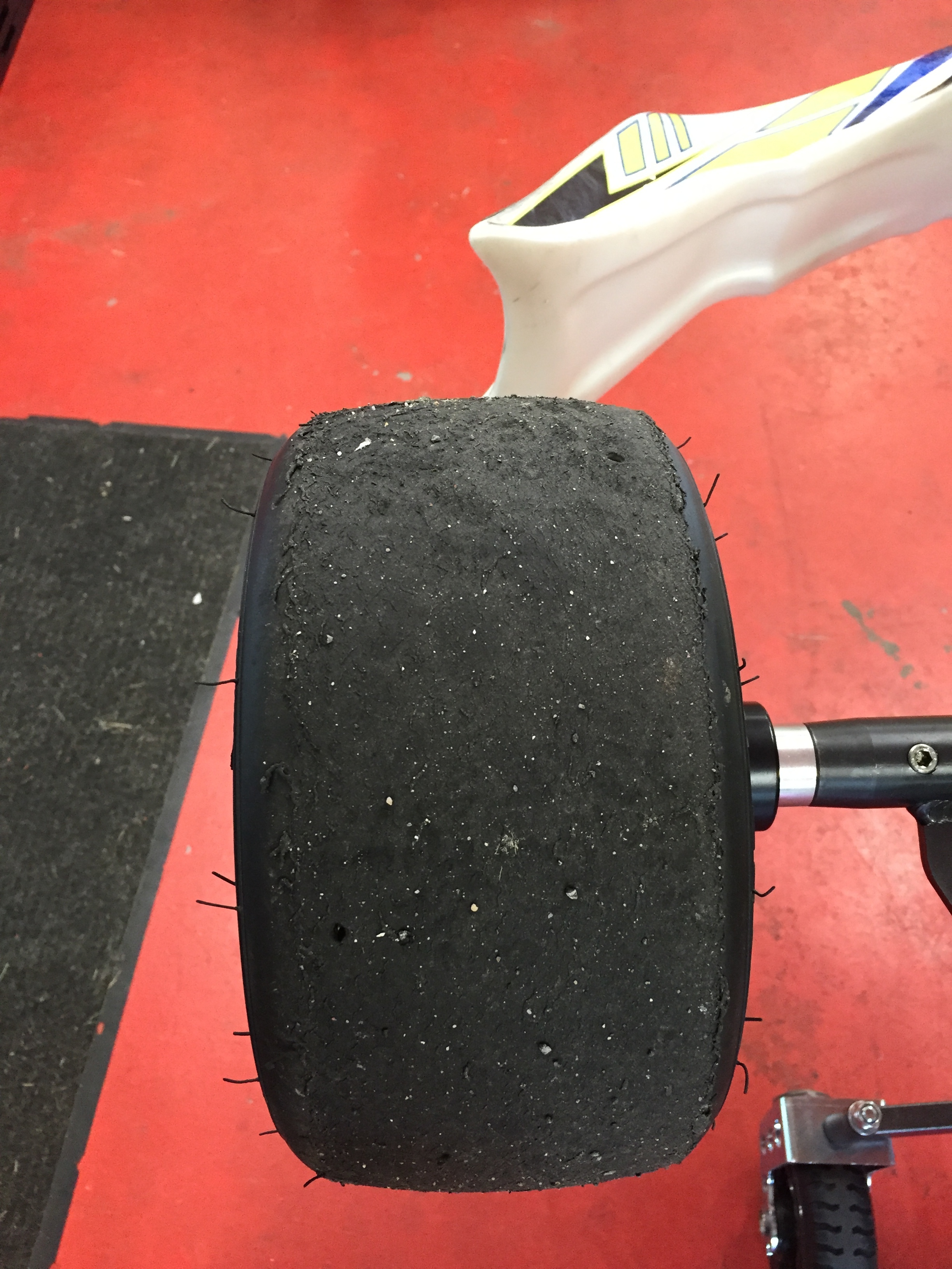

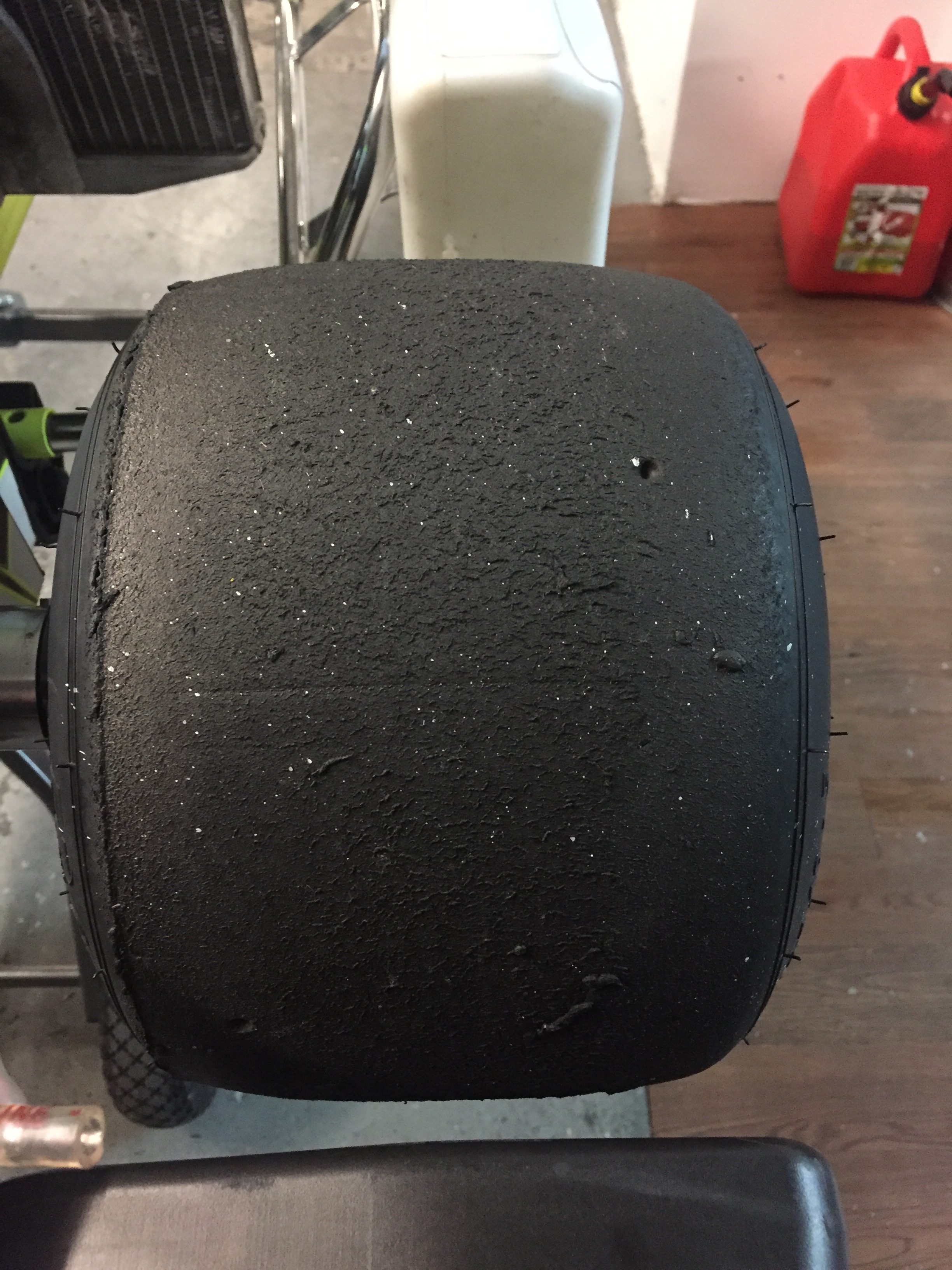

So I recently flipped the tires and have I think one session on them in this configuration. So that’s why the tires wont make sense as far as how the are mounted currently.
So I would say the fronts obviously have substantial graining, which means they were oversterring? And possibly too much psi? I set all tires at 9psi cold FYI. Weather has been high 80’s low 90’s
As for the rears I feel the one tire looks fairly normal but the other looks over inflated to me by looking at it.
Again I hope the porpose of this thread is to A. help diagnose what the tires are telling you and know how to adjust psi and B. how chassis set up effects tire wear.
Let me what you guys think!
The tires look pretty normal to me Paul. I don’t see any graining on the front. Also, graining on the fronts indicates UNDERsteer, not oversteer.

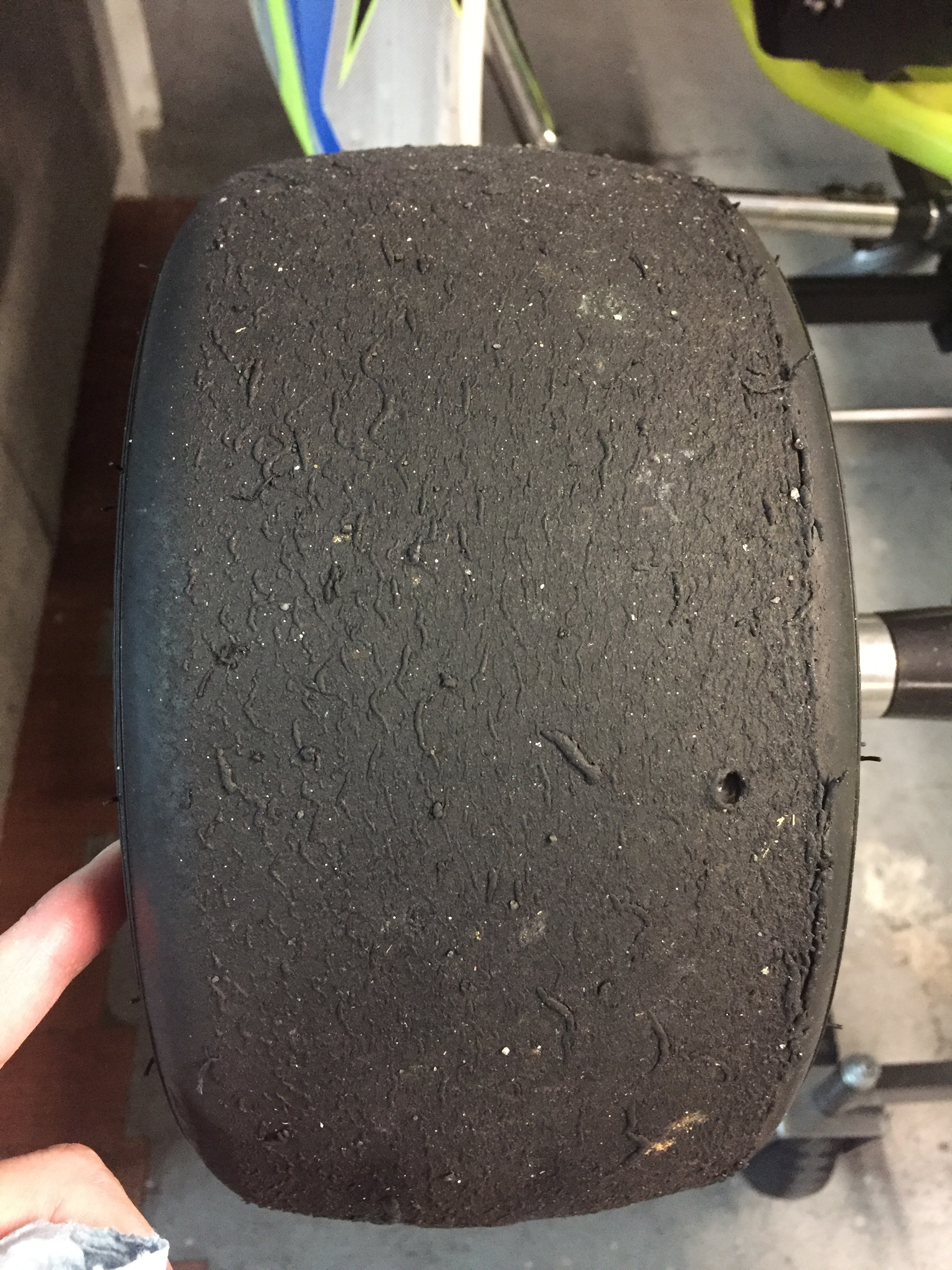

Few questions:
1: Excessive rubber pickup on tires?
Seen some suggestions online that indication of to low hot tire pressure. Seem accurate? I noticed this past weekend regardless of how I entered pits I always came in with a TON of rubber pickup. Kart in front of me in tech line did not have same issue.
2: Rear tire inner edge coning? In general it seems that I tend to cone the inner edge of tire pretty excessively. Overall balance of kart seems ok just cone tire. 3 different tracks I have varying degree of coning but does seem excessive as when inner edge is down to wear bar the outer edge is still has about 30-50%.
Does this indicate general setup/driving issue?

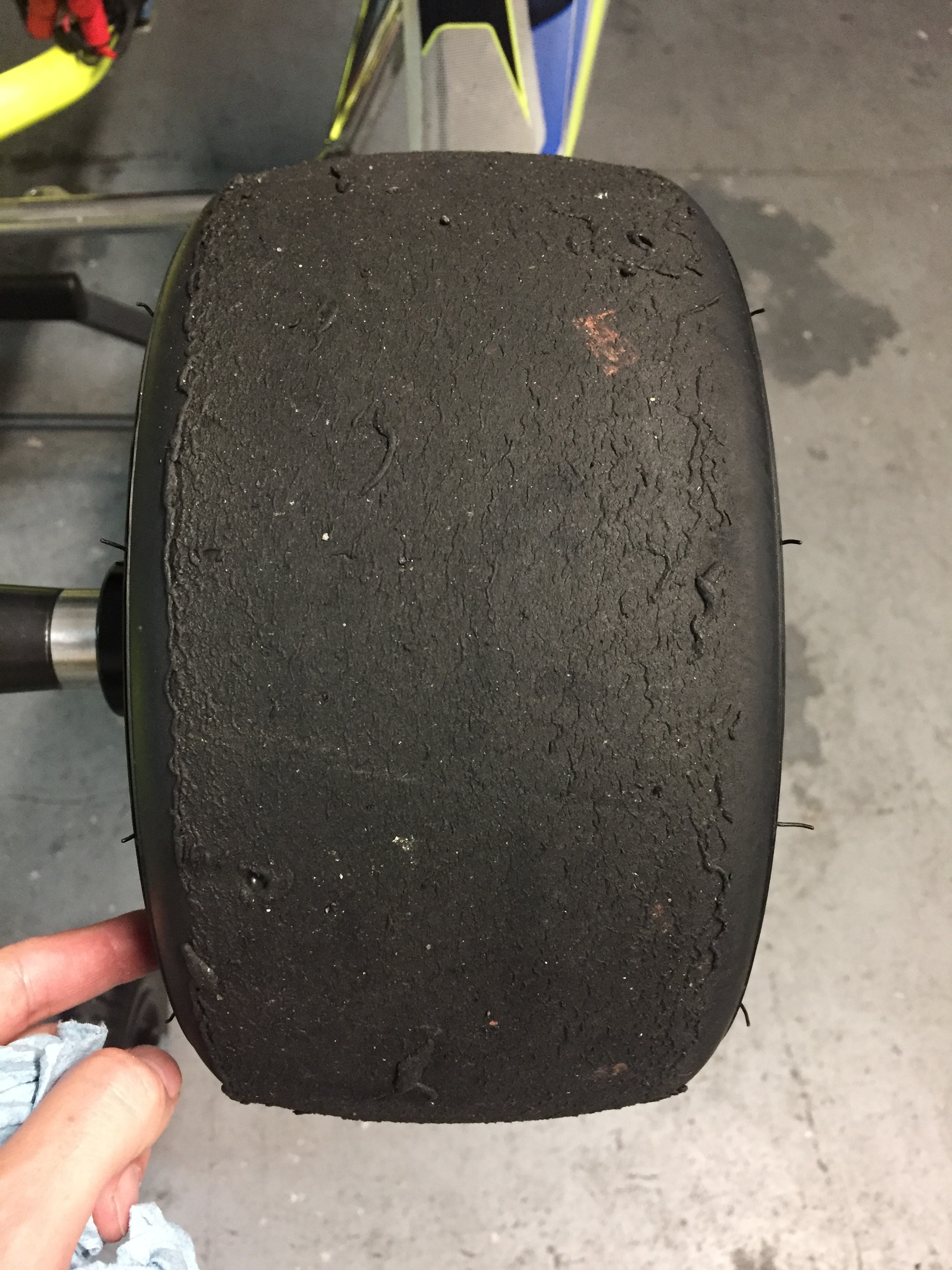

Here’s brand new yellows with 4 sessions on them.
Started out at 8.5 psi. Felt ok and tires look normal to me. Any thoughts?

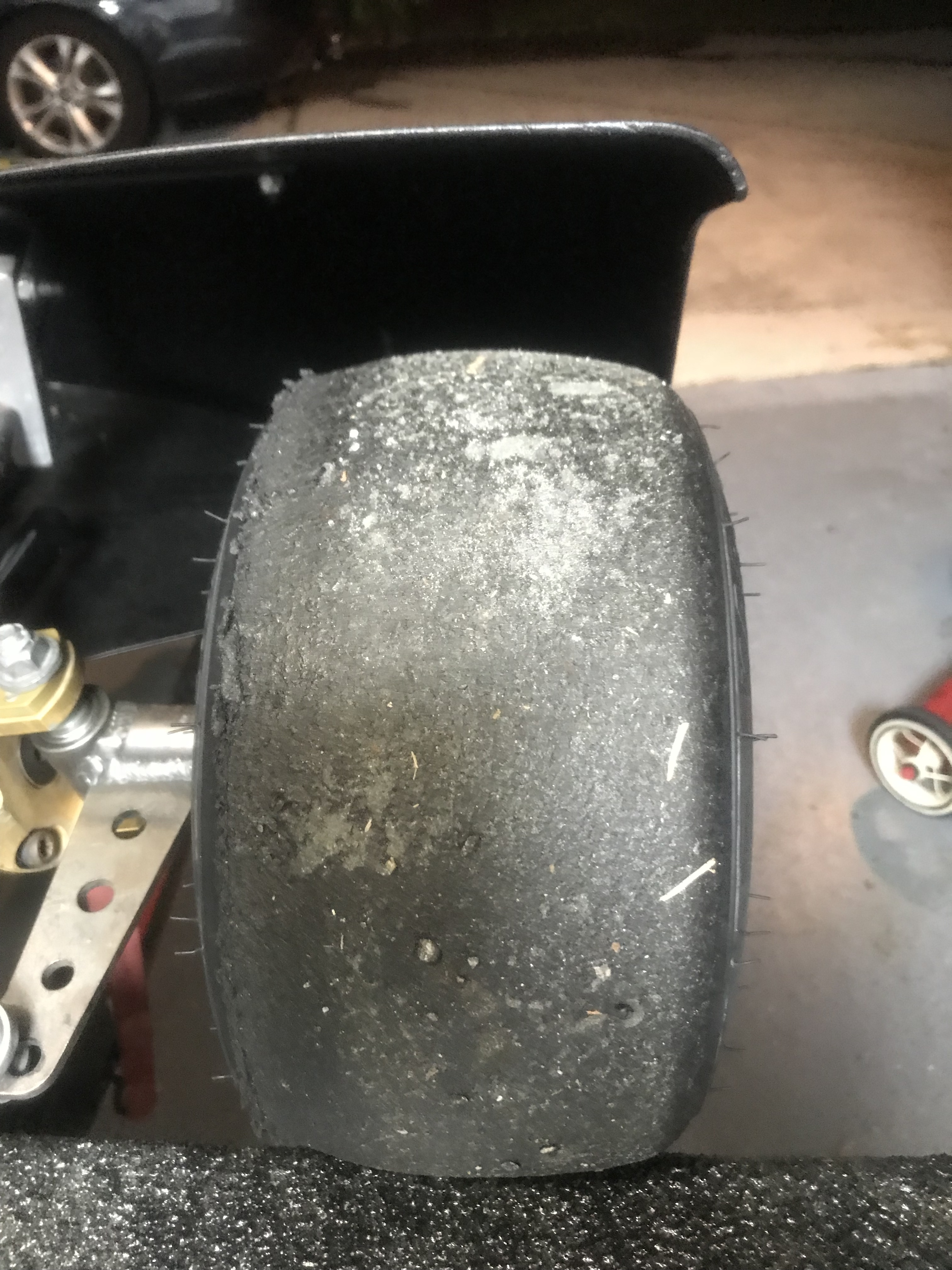

I am looking for some help as well. On Vega Reds for for the 3rd time. My first 2 times tires came off looking great. No build up and rears looked like sand paper. After my 3 race it was a while different story. It was only left sides and didn’t go off track or out of the racing line. My top speed was continuing to slow down as the day went on. I’m still new and trying to understand. I have read so many different reports about tire temps and pressure. So I’m leaning towards the tire pressure to low and not getting hot enough. imageimageimageimage
My guess is there was more clag/marbles/buildup in the later sessions that you picked up.
There’s too much on there to read really. We can see you have camber burn, but often that’s where the kart is fastest.
In the last session, when did the kart “come in”. Early? Late? Was the last session longer than the others?
Picking up rubber like that is generally a sign of not generating enough heat on that side. What pressures were you running?

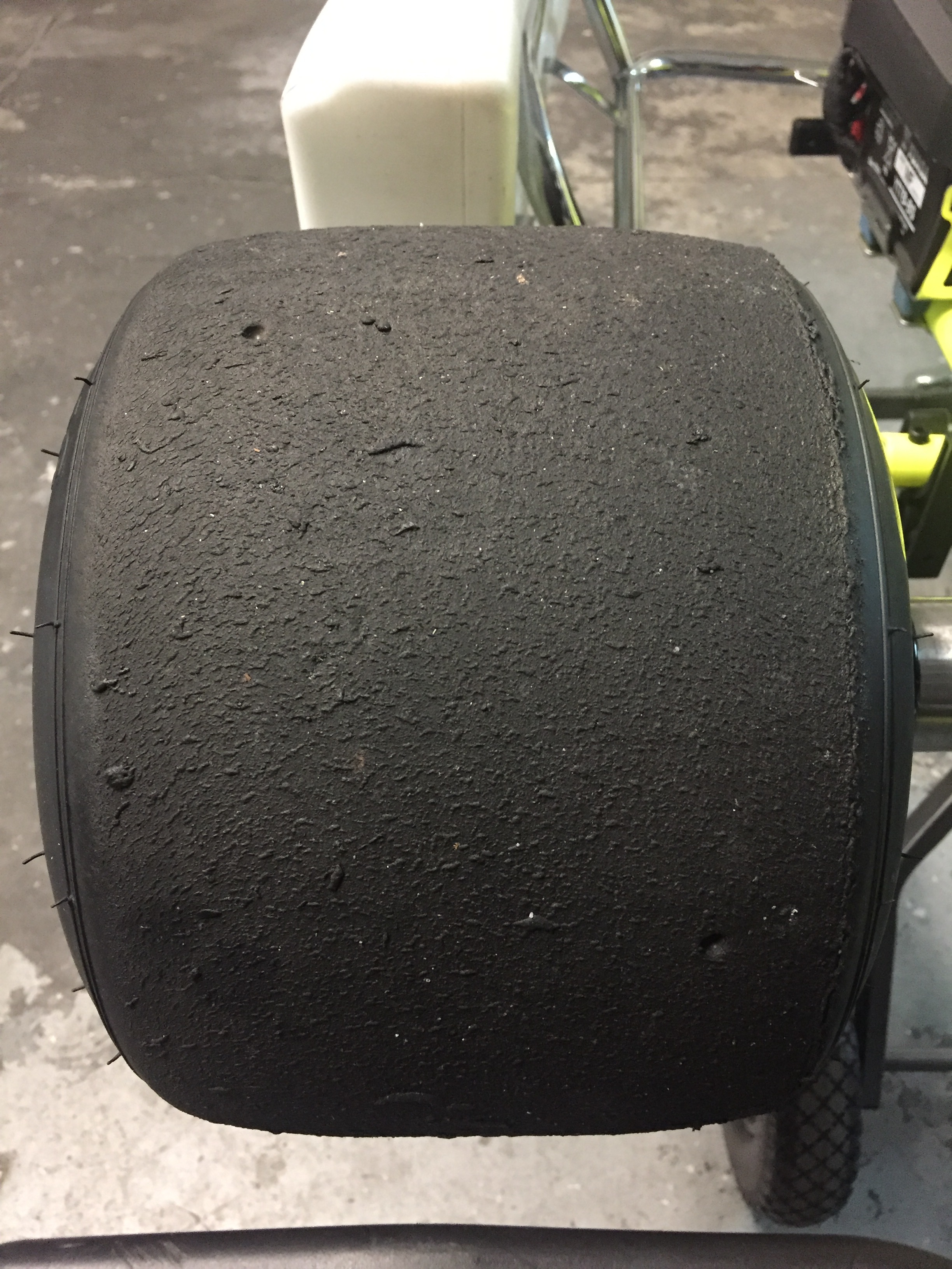

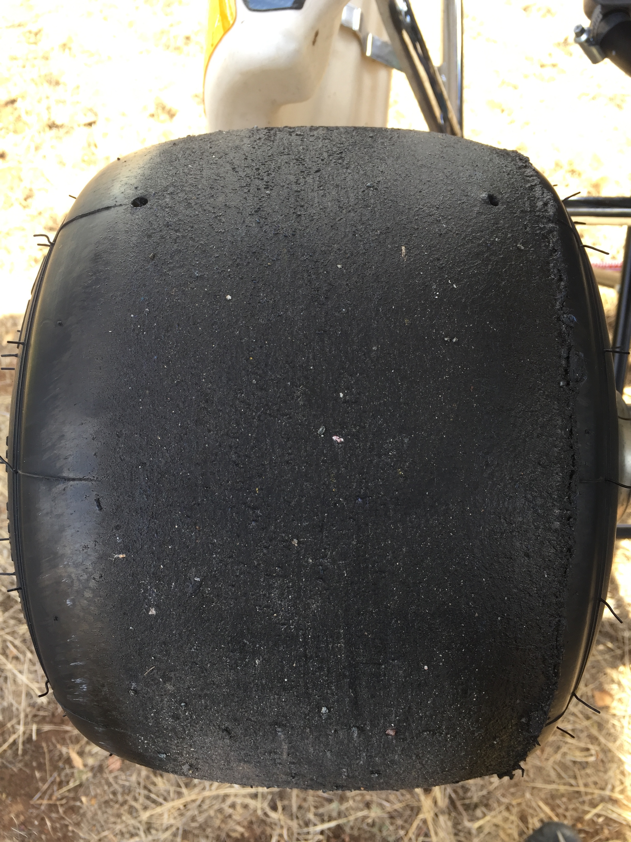

Hi all,
This was after quali and 1 heat.
Does the inner wear and outer edge no wear suggest bad setup?
Cheers.
