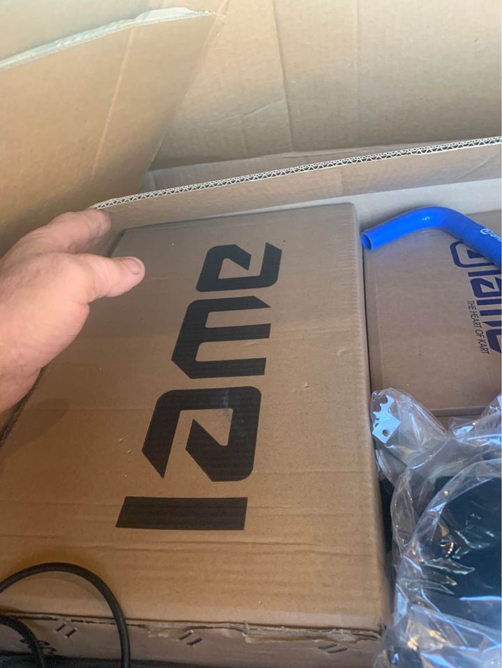

I’m going on Sunday to pick up a NOS IAME X-30.
Don’t forget radiator and water pump too!
And ibuprofen. :checkered_flag::checkered_flag::checkered_flag::checkered_flag::checkered_flag::checkered_flag::checkered_flag::checkered_flag::checkered_flag:
X30 will have an outside rear sprocket which is likely different than what your running on the 206.
While anything is possible I wouldn’t plan on swapping from one to the other at the track to try and run 2 classes.
Setup coming complete with wiring harness? Pipe?

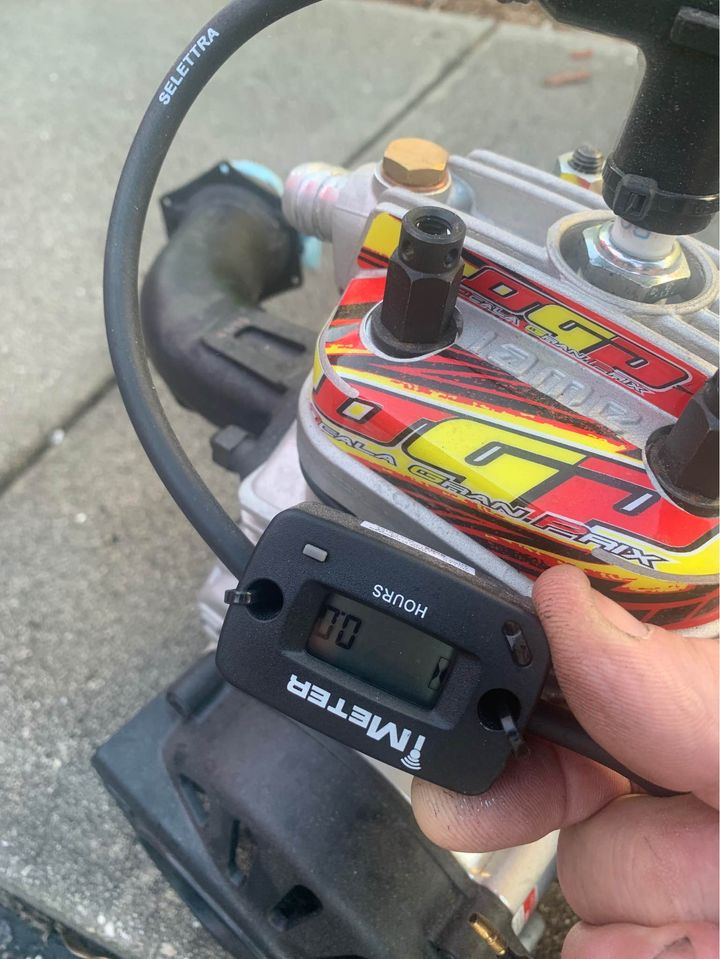

Drug it home today. I was on the fence on going 2 stroke, but the price was very fair IMHO. Seller even threw in a motor mount to go with it. He was reverse commute, going from 2 stroke to LO206.
NOS Blue Printed IAME X-30 from Ocala Grad Prix before they shuttered their doors earlier this year. RIP OGP!

All that was included.

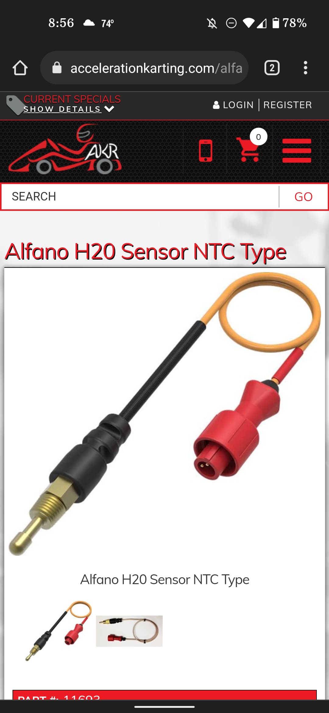

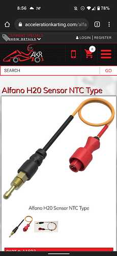

Do I need to upgrade my race computer? I have a single 1T Alfano 6. Also, on a water cooled engine, does it monitor head temp, exhaust temp, or something to do with the cooling system?

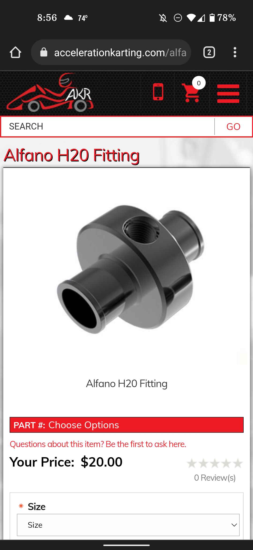

For the Temp, it will only monitor one, either water, cylinder, or exhaust since you have the 1t. I use water temp personally, I think it’s the most important, will let you know that your water pump is working and your engine won’t implode. You’ll need the cable as well as a hose connector with the necessary cable connection to screw the temp monitor cable into. Then split the hose in half and attach them to both sides and clamp them with a hose clamp.
I don’t know if you need the k type sensor or NTC type. I’m not familiar with Alfano
Ideally you want two temps. Water and EGT. Not sure what Alfano’s set up is for that.
Water to monitor engine cooling and EGT for tuning.
If I could only monitor one temperature it would be EGT. If I’ve got a big enough water leak to send the water temperature out of range it’ll show up on EGT too - acting leaner every lap with slower rise and slower cooldown!
