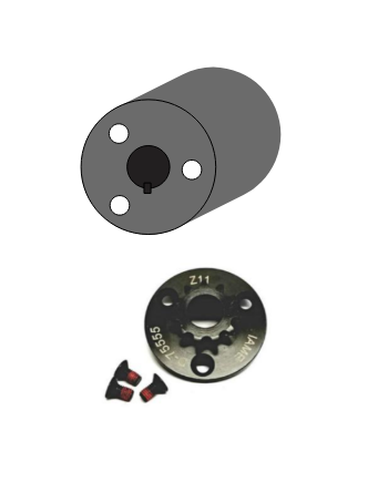

Machine an aluminum barrel bushing to act as “driver”, with a 15mm ID and keyway. Then machine and tap 3 holes in the side of the barrel / bushing to use a standard IAME driver X30 or KA100.
Voila, easy ratio changes, and replacement.
Is there a market for these? I can make them…or have them made.
