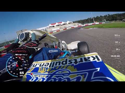

Looking for some feedback on my driving.
Last year I was decently fast at this track (Genk) and running in 55/54 depending on track conditions, this year I just can’t get under the 57’s anymore. It almost seems like I simply forgot how to drive.
I know my kart and engine are good, the engine is still exactly the same as last year and my frame is way fresher, not bend/sagged or anything. tyre’s I’m not 100% sure on as they are pretty old at this point. We got a bunch of lightly used tire’s back in the end of 2019 and this is one of the last sets of those.
Everything on the kart is original and according to the european regulations, tire’s are Mojo d5.
I have more video’s if required from the same track and a few others (where driving went better for some reason). unfortunatly I don’t have video’s of me driving fast, I only got the camera this year.

Went back to genk last weekend on almost new tires (I ran them for almost one day in wackersdorf) but still felt like I had the same problem.
It’s still the same kart just with different bodywork
The consistency was ok, all my sessions were within 3 tenths of my theoretical best.
We tried some setup change’s but I couldn’t really notice any difference in driving or laptimes.
kinda starting to doubt my chassis but when measured everything is straight and square, only 1mm bent on the snipers.
In my opinion the kart feels dead, I don’t get any feedback from it not on the extremely grippy wackersdorf with the euro trophy guys or a really low grip beginners track.
In the time between driving I rebuilt the front end of the kart and put new rear bearings in, but I couldn’t find anything odd
(here is a video of wackersdorf with the new tires)
