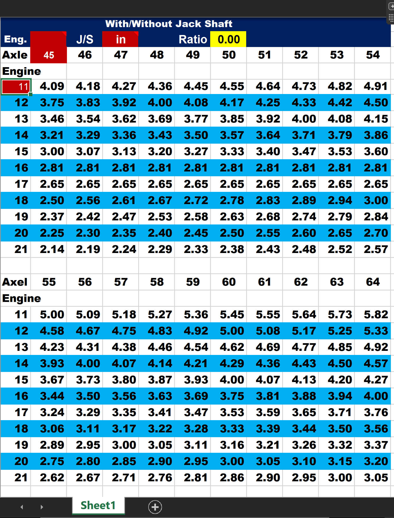

Nice video, I watched the whole thing. Looks to me like you’re down on power everywhere. Frustrating I know. Gearing is not going to help. Sorry. I’m including a gearing chart just for reference. 3.81 – 3.88 is one tooth on the axle.
